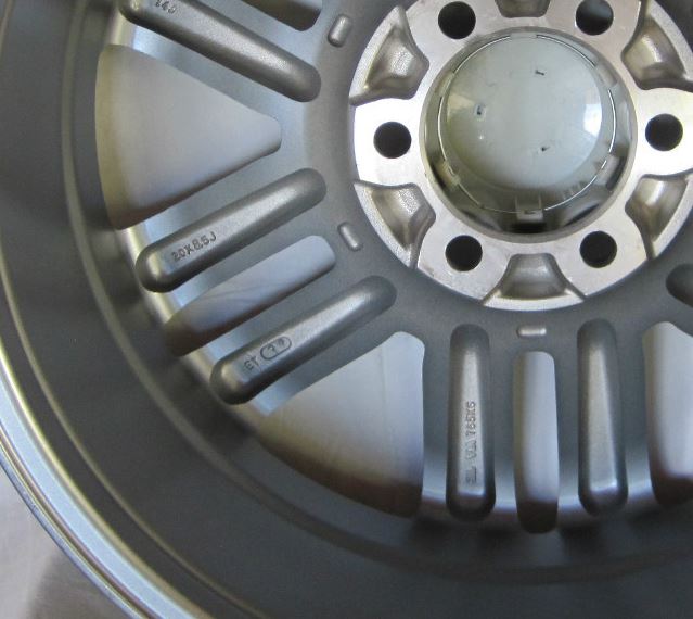

I wonder if they are truly 8" width or if they measured including the lip.... Not to mention I'd be concerned about quality. Would be cool to have a wider version though... I've definitely thought about sending to Weld Craft or somewhere similar since I like them so much, but an extra 1" or more will just add more weight to already heavy wheels (not to mention increase the offset to +25mm or more depending on actual amount added).
Interesting. Looks to be correct measurement.

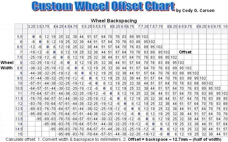

Has anybody tried these yet on a 5th gen? A +30 offset on a 8 1/2 wheel would put the backspacing at almost 6 inches compared to our stock 4 1/2". That's way to far inward and would most likely rub the UCA's when the suspension extends IMO.
I have a spare set of 4th Gen Sport wheels that have a stock 5.25" backspace and I can barely get a piece of paper between them they are so close to the UCA's when on and would rub if my suspension fully extended. Maybe whoever designed these probably doesn't know they changed the offset from the last Gen 4Runner because they would probably work on 4th Gens.
Here's an offset chart ........

there appears to be two 20" limited replicas available in a 30 or a 25 offset.
With 275/55/20s on the 20x8.5 +25 offset that puts the tire 1" (25mm) closer to suspension and poke 0.2" (5mm) out, very close to suspension, but if you use wheel spacers, the Spidertraxx are 32mm.
that would put these at 37mm (1.45") further outside vs OEM and 7mm (0.27") more clearance on inside vs OEM
The math says that these would sit perfect with a wheel spacer 1.25" with 275/55s but that isn't always the real world... the limited OEM wheel with 1.25" spidertraxx wheel spacers doesn't rub... this replica with spacer would be 0.2" further out from that..
