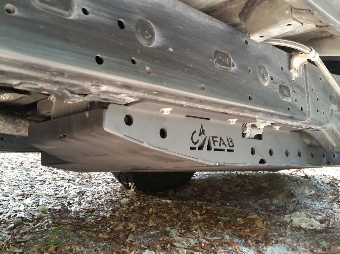

I got the one from C4Fab and love it!
None of the gas tank skids will interfere with engine/trans skids from other manufacturers.

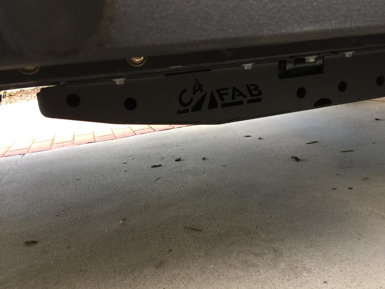

Plus 1 for the @c4fabrication fuel tank skid. After doing my research, I found it to be the best standalone fuel tank skid design.
The sliders are badass as well.

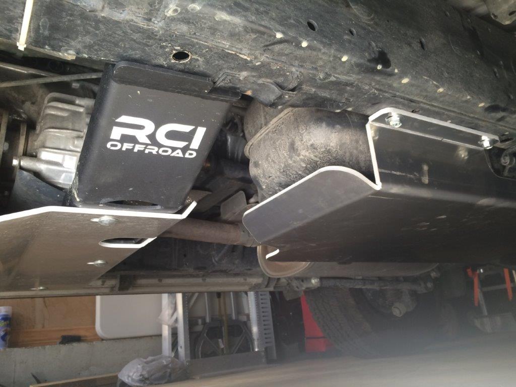

I used the RCI 1/4" Aluminum Gas Tank Skid
When looking at skid plates I wanted to go with lower weight so I went with aluminum. RCI was having discounts and group-buys last year so the pricing, even for aluminum was reasonable.
The only legal place nearby (2 hour drive) for me to go wheeling is very rocky so skids are best friends out here. The aluminum does get deep gauges and bends but still holds up and does its job of protecting vital systems from taking the hit or slide.
The RCI gas tank skid still has a vulnerable spot between the transfer case and the front of the gas tank. A well lined up log or giant branch could technically puncture the gas tank in that area. Although that scenario would be very difficult to "accidentally" happen unless one is really, really clueless to what they are driving on or over.

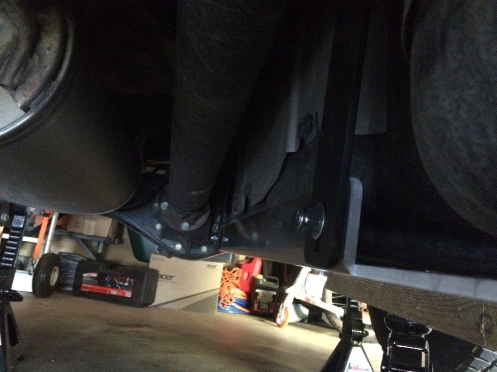

I think the main "clearance" issue will be the mounting bolt and the rear differential. Keep in mind that the rear diff. will move or rotate from where it is during flexing etc. Most fab shops seem to have taken that into consideration.
In my drive-line picture below I changed the direction of the nut and carriage bolt to the inside so the flat side of the bolt faced outside in order to further ensure clearance near the rear diff.
