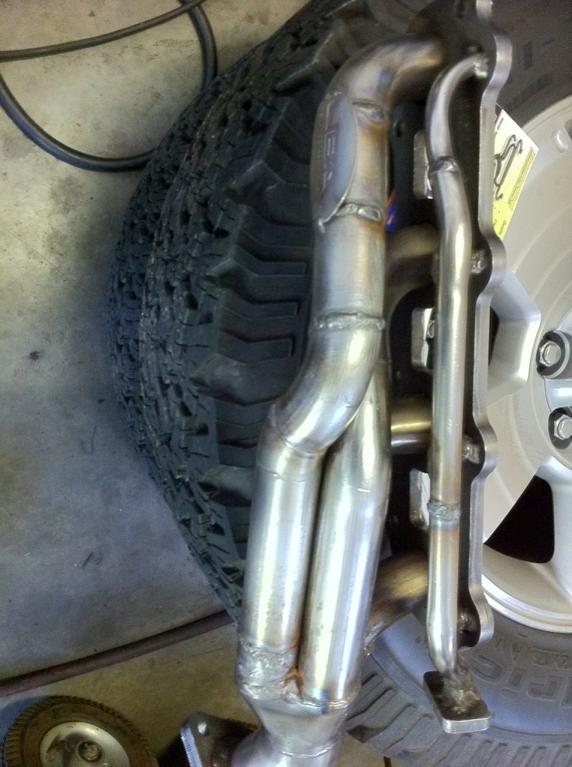

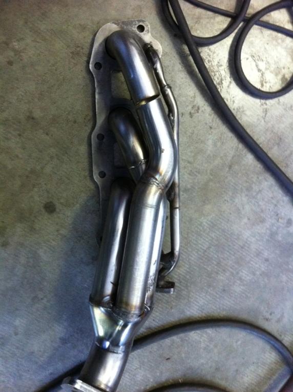

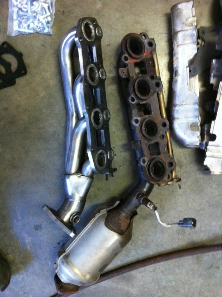

Here are some pictures during the modification process of the JBA headers. Hopefully the attachments worked!
Sorry it took so long to get the pic's attached, I've been extremely busy.

Can you go into a little more detail about the drivers side manifold and what exactly you need to mod please?
What to modify on the headers
Hey Toyo,
The from header tube on the drivers side needs to be cut and run slightly higher and over the other tubes in order to create clearance from the engine bay, but in a way that still slows access to all of the bolts. It took some time and a lot tacking and measuring but the end result is awesome. Also, just before the same tube mates back to the collector, I had to dimple the tube in order to clear the steering shaft (very close figment). It sounds very muscular and made a huge difference in low end power. If you tow anything, this mod combined with full exhaust and an added tranny cooler, you can comfortably tow about 9000 pounds. However I believe in towing no more than 75% of what the manufacturer claims. This keeps my truck happy and my pocket book happy too; especially since it's over $1.54 per liter of fuel here in BC.
Hope my explanation helped a bit.
The second picture shows it best, unfortunately I do not have a pic from that angle before the mod as a direct comparison.
