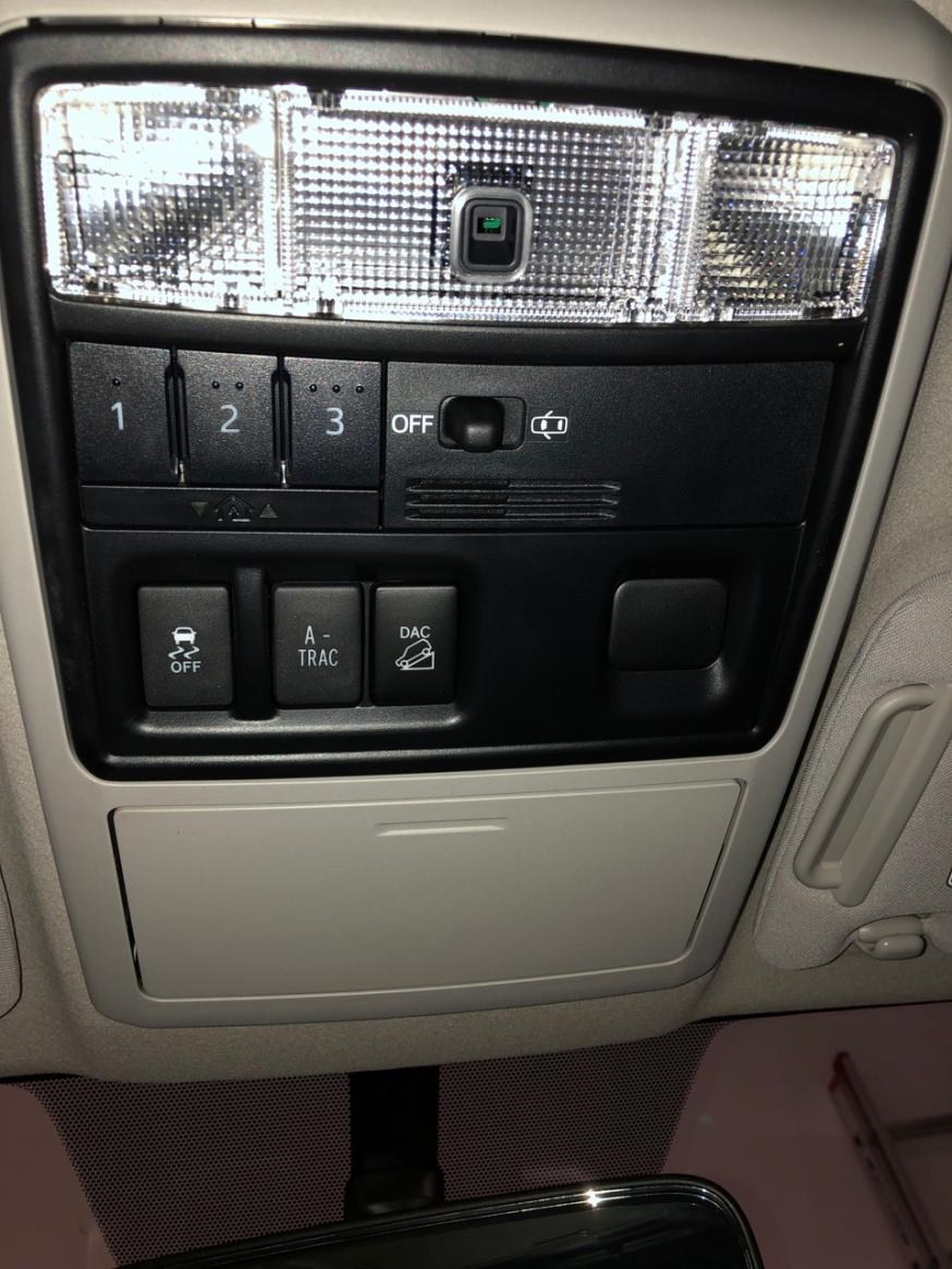

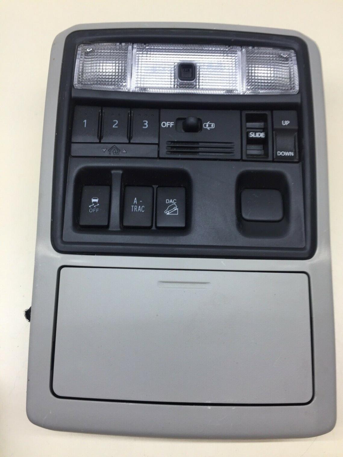

See attached for differences...

the wiring and circuit board are in the roof console for all of the switches, the truck only provides power.
buy it and install it. Its literally plug and play.
