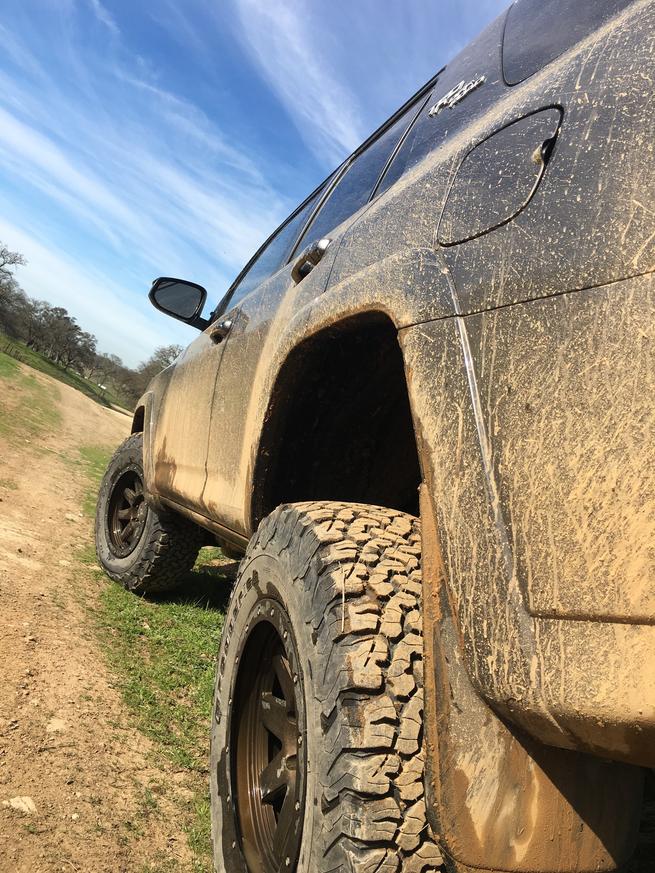

Go get it dirty, and you won’t have any glare problems.
