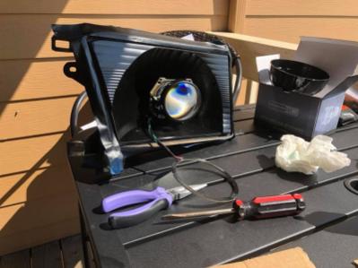

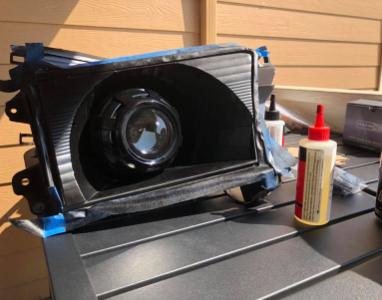

3G4M actually had a group by hosted by SRQ for retrofits a couple weeks ago and had a chance to build them last weekend. Very happy how they turned out and perform. The kit included the shrouds, projectors, halo, harness, switchbacks; I went with the D2S on Apollo 3 black shrouds, used my 99 oem headlights and ordered some sealant. Took me about 3 hrs total but first 1hr was disassembling the headlights in the oven and sanding / painting the housings. Only thing I didnt care for is that you have to cut into the oem rubber covers that hang on the backend of the oem housing in order to /kinda/ cover the igniter (where the LED plugs into) but other than that highly recommend! Let me know what you think
