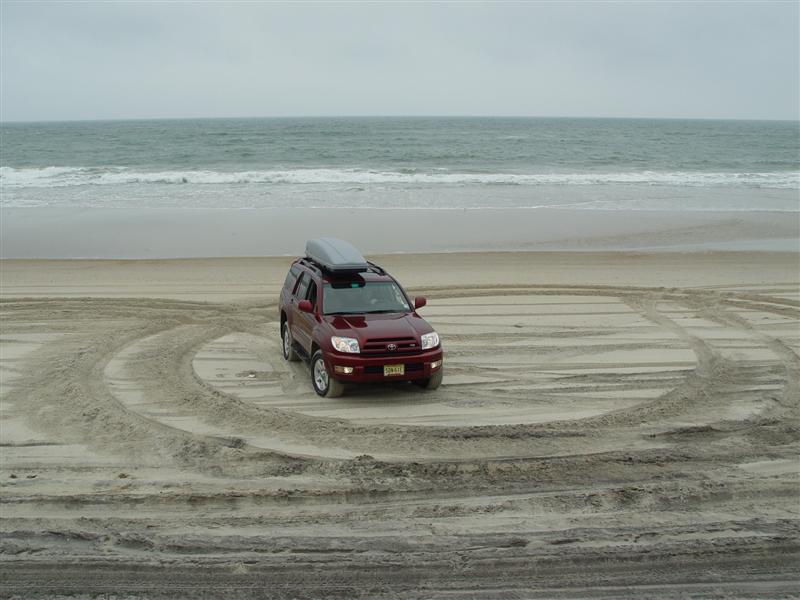

I've locked the Torsen in the snow and sand and had no problem spinning all around. You have to put some gas on it but it will spin.
