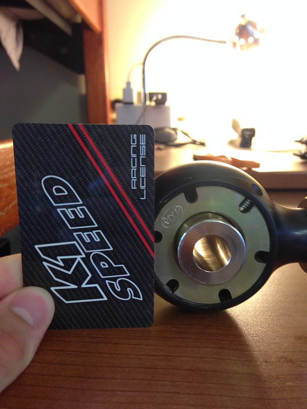

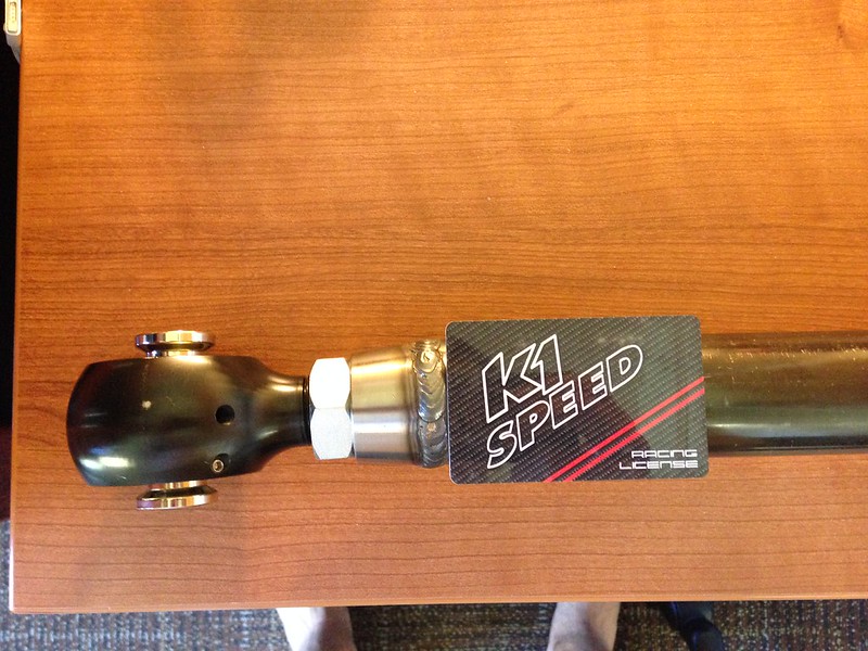

The ones I sell will work, and are better quality. The link is in my sig, and shoot me a PM if you want pricing. I can make them fixed, or adjustable. Be leery of the AllPro since they state they use 2.25" DOM and we only have an mounting width of 2-3/8". That means you only have 1/8" of bushing on each side, and that's something to be concerned about. My adjustable links are made from 1-3/4" x .250 wall DOM, and weigh around 22 pounds per pair.
They're made the exact same as a 3rd Gen (pictured) with one exception being the offset. An FYI for you as well. It isn't going to matter how much adjustment you have on the lowers. If you want to adjust your pinion you need to have adjustable uppers. With you're uppers being fixed, the lowers are very limited in the amount of adjustment they'll contribute. Not to mention, when you adjust the adjust the uppers it clocks your axle and uses the axle shafts as a pivot point.
To adjust your pinion using lowers, you'll actually need shorter arms. Shortening the arms is going to pull you axle forward. Causing the uppers to push back clocking the pinion into a more direct line with the transfer case. Adjustment on the lowers should only be minimal, and the major adjustments should come from the top.
