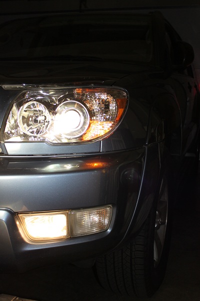

Can you post a picture of your headlights?
I don't have any full car/decent pictures, so this one will have to do. There are some better pictures of others who have done this mod on the forum, a search should turn up some results.

The gap!

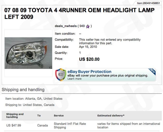

If you are an 'eBayer' like myself, you can really get some great deals. I am picking up mint 06 housings (except for a missing tab which is repairable via the factory repair kit on the drivers side), for roughly the price you quoted above, including shipping to Canada. Shims and repair kit are about another $180. I purchased an 06 grill form another member here, for $100 (i'm going the 'Simple' way), which is not required but adds more looks. The issue with doing a retrofit is that you do not have existing projectors to replace for the Audi's, so be prepared to hack things up. You can always by my 05 OEM's for $120, and atleast attempt on them.:)
