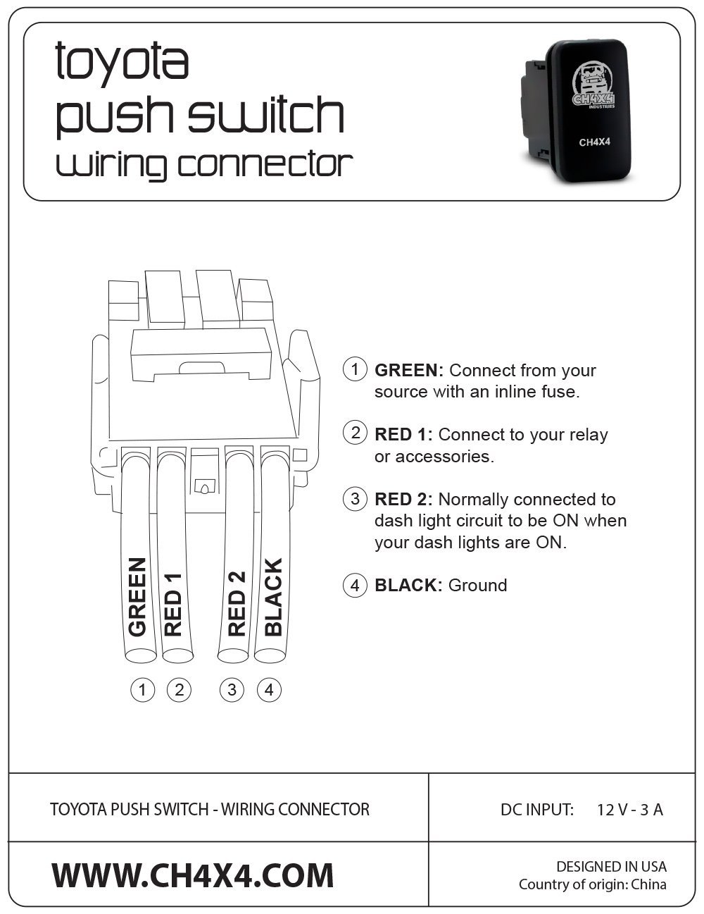

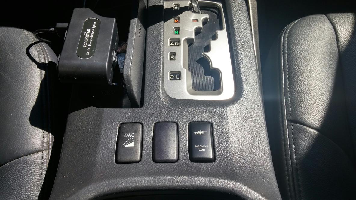

I got this super cool machine gun push switch from Amazon. I'm not going to operate anything with it yet, but I would like to have it light up when the dash lights are on. What is the best way to get power to it? Thanks for any help!
https://www.amazon.com/dp/B019WTO1WM/ref=cm_sw_r_other_awd_LR-.wbDMV282A
red 2 can go to green parking light wire to have it on while lights are on. if you want it to light up while in acc mode then just tap to the 12v socket constant. i forgot the ignition on wire.
Can I tap straight into the green parking light wire that goes into the DAC button? Is that best way?
