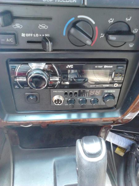

If I'm not mistaken installing a switch on that antenna wire resolves all of those quirks. My aftermarket head unit like lots of others do, will raise the antenna whenever the hu is on, regardless of what input is used. That got old real quick for me. Installed the switch and rarely need to raise the antenna anymore.
Wire in a switch to control power to the antenna and be done with it. Lots of threads on here on wiring in a switch.
Added a little switch next to CB radio and below the head unit. That switch controls antenna up and down.
