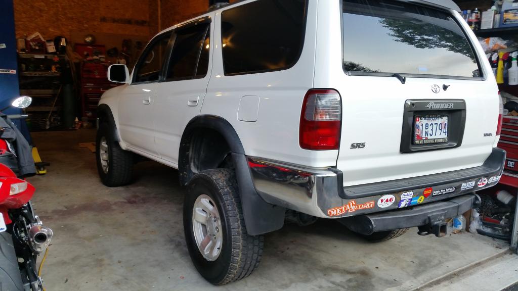

So after doing some research on 861's I found his thread: http://www.toyota-4runner.org/3rd-gen-t4rs/176162-ome-861s-6-lift.html and picture below. Basically the guy installed 861 with no bumper and got a 6" lift. With only 150lb bumper...am I gonna be close t that?? Seems insane right?
I carry a bunch of weight all the time - dual swing w/ full size spare, high lift, co2 tank, gas can (usually empty) and a box with straps/recovery stuff. On roof rack I have a box with all my tools crammed in and another box with 2 cv axles, a starter, an alternator, 5 quarts of engine oil, 3 quarts of gear oil, grease, etc. Have front Tundra TRD coils on Tundra struts at position 2, and just switched out the rear springs from 890's (which made me about .25" butt down) to Superflex (which made me about .5" butt up). I will see how much they settle.
I figured that I will go up one step at a time and Superflex was next step. If they settle I will sell them and go to 861's

I think doing something like trying to keep it level would be a bit like trying to hit a moving target. If you pick something that starts off level it will end up sagging with time and added weight.
I think brand new, 861s, LC 8 or 9 wraps, and Superflexes start out with a fair amount of lift. But even 861s will settle a little bit. But 861s seem to be the most consistent with weight, over time. I just don't know a lot of members that have the 4X bumper with the Superflex coils.

Without going custom, 861s, in my opinion, are the only option. Nothing else will hold the weight without riding like ass.
With my tent, all my camping gear, bumper, etc. the rear of my 4Runner never sagged, or rode like garbage. Even with my wife and both the dogs sleeping in the tent, those springs held solid.
