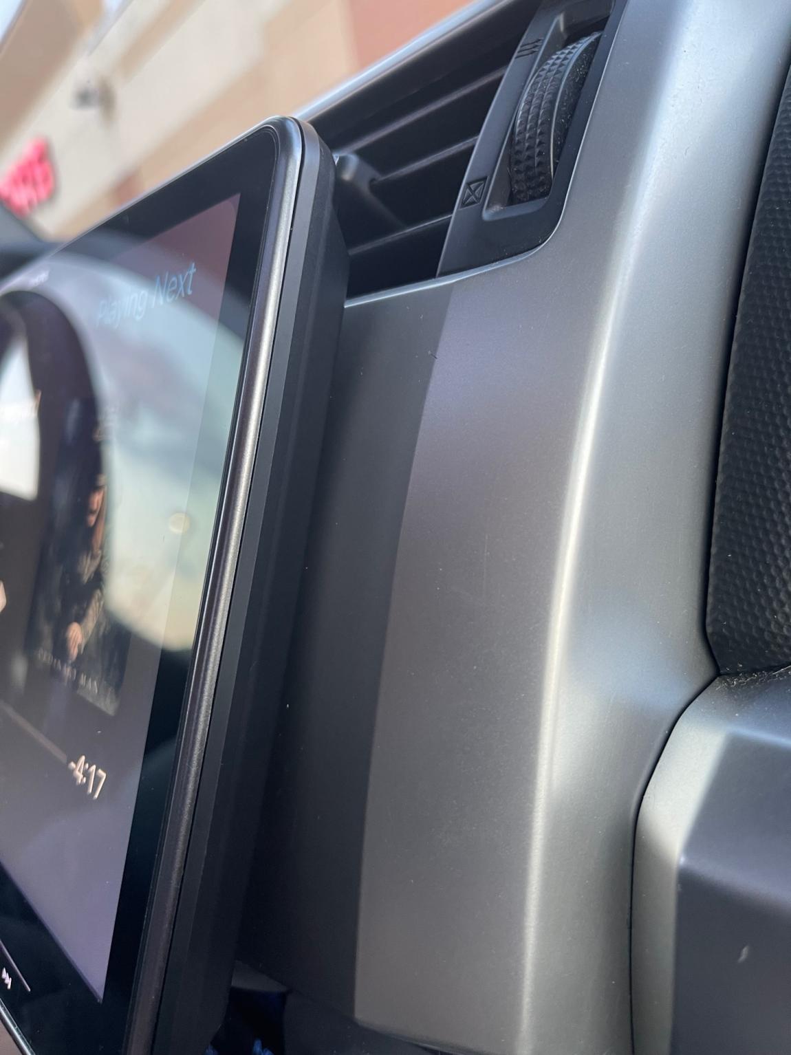

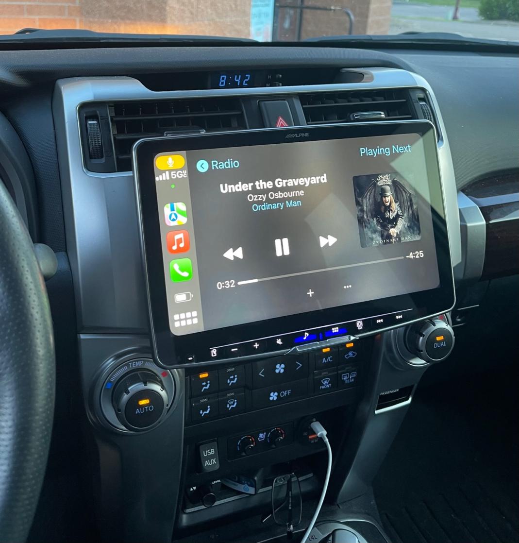

Alpine iLX-F511 11in installed using a Scosche kit. With that kit I was able to snug up the radio right up to it so it doesnt stick out too far.
You have good timing by the way. I just installed the ILX-509 in my 4Runner. Still testing it out.
I bought a 8100 Sony from trail grid pro, how did you end up mounting this flush almost? Im probably going to use oem brackets to lower it and not block the vents. It blocks about 1/4 off lower vents. Wouldn’t making it flush
The floating radios normally stick out because you need room to adjust it. You will know what I mean when you install one.
With the scosche kit, the brackets that screw to the radio mount to the back side of the kit. You can mount the deck all up to the kit on the bench instead, once you get the screen secured you can then slide the radio back some all the way to the kit face. Then you take the whole assembly to the truck. No need to mess with the OEM brackets. The install on mine is solid, no wiggle of the dash kit. The radio is adjustable up and down.

OEM brackets would lower it and not block the vents
Again, you can adjust the screen height to whatever you want. I could adjust it lower, but then 11in screen would cover more of the HVAC. The kit also comes with a pocket for filler since the Alpine is a single din chassis. I can mount the pocket in the top spot and deck in the lower, or vise versa.
The OEM brackets are irrelevant.
Aside from mounting it so close to the dash, how are you liking the radio overall? It would be nice to hear your thoughts on it. I’m still testing mine out too.
No complaints other than I worry about it getting attention by thieves wanting to break in. I do have an alarm, but still.
To be honest, I have had 5 different aftermarket decks in there (work in the industry) and it's a nice radio, but the price is up there. It's better than previous generations of the Alpine Halo decks. The mounting method is updated and no lag.

The problem with the oem brackets is the lack of holes, unless you feel like drilling the brackets you are extremely limited on the mounting holes. I was able to mount my Halo9 in the lower holes to not block the vents, but my Kenwood unit I was limited with the stock brackets and ended up blocking about an inch, inch and a half of my vents. Going to switch to the Scosche brackets to try and lower it
