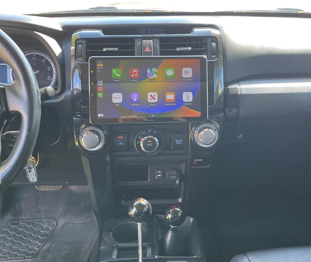

mounted in lower din, may adjust the height 1 more notch down.
with the 10.1" screen in the lower position does it block the hvac controls? Did you adjust it again? Im in between the 10.1" or 9" , dont want to block the HVAC vents nor control but may consider it if finding a sweet spot.
I have not adjusted it since the photo. From the drivers perspective it does block some visibility to the controls. I've had the truck long enough I don't have to look at them to know what they do, but some would find it bothersome.
I don't think you'd be disappointed going with the 9" over the 10" for a more precise overall fit.
does it block the vents at all? I can live with the controls blocked a little.
You can kind of see in the picture it is still blocking the lower slot of the vents. I could, and with summer coming likely will, move it down one more notch to fully expose the vents, which in turn will block visibility of the controls a little more.
thx for the info that is what I'm considering. Curious to how much itll block the hvac controls and if you would even have space with it down another notch. Basically avoid touch the top of knob completely and using the sides only.
the unit sits out from the dash ~1"+ and has tilt adjustment as well, so it won't be physically touching or inhibit use of the hvac controls if you move it down a notch, it will only block visibility of the controls more.
