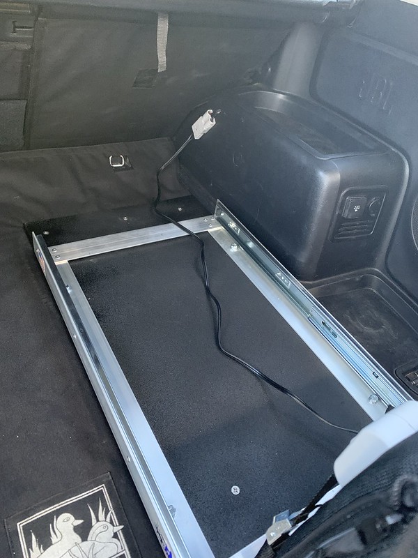

Running wiring and planning out a slide mount.

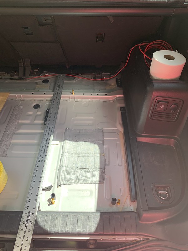

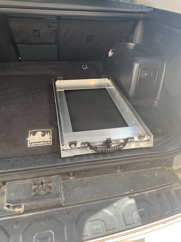

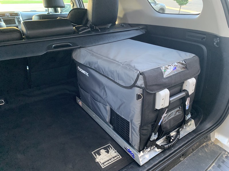

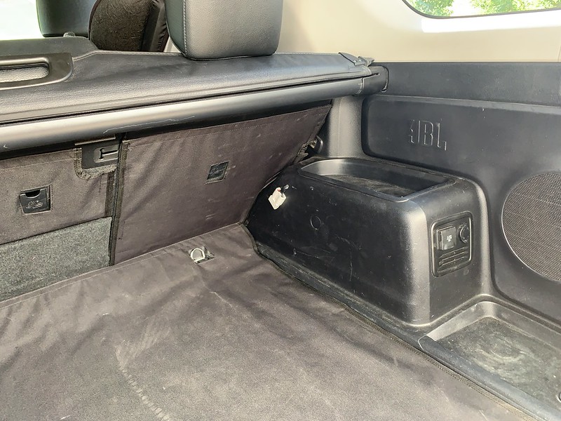

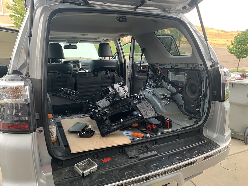

I only have 3 rivnuts on hands so I had to order more but here's the plan. I made a cut a board out of 1/2" birch plywood and shaped it slightly to fit snug up against the passenger side trim. I'm going to put 2 or 3 rivnuts in that crossbar to mount th front of the board. I verified its open under neight the bod so I'll put 2 or 3 more in the back along with metal spacers. I'll cut out holes in the styrofoam layer for the spacer to pass through. I cut the insulation off the underside of the trunk carpet where the board will sit to reduce the height a little bit. Right now I'm still waiting on the fridge slide to continue, its held up being shipped out of FL because of hurricane Dorian causing problems. Once the board is mounted I'll line up the slide to have it as far forward and the side as I can without anything hitting anything. When the mounting is figured out I'm going to use pronged t nuts inder the board to mount the slide from the top. I'd trim down the board as much as possible then Bedliner the whole board to keep it protected and waterproof. With this setup when I take it out for ski season its 4 quick bolts to remove the side and no other hassle.
It should right about here, it'll still clear the privacy cover.

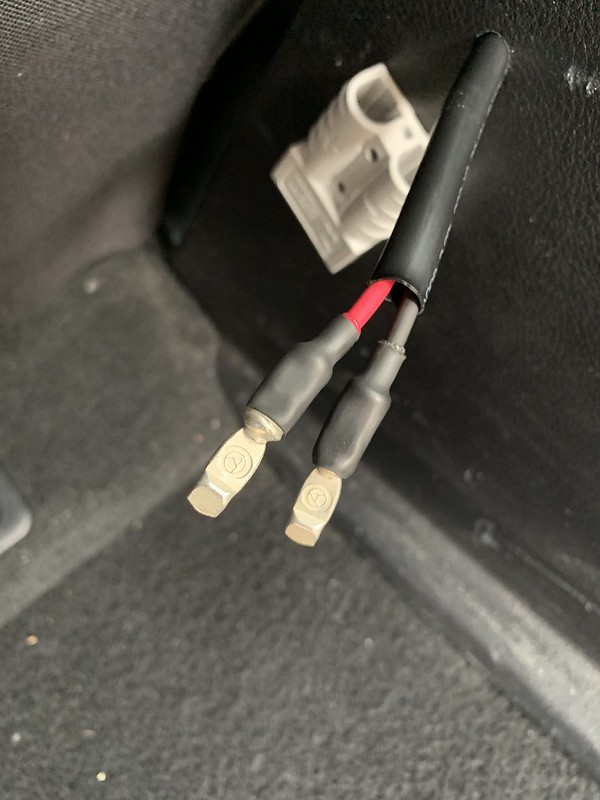

I got the wiring almost buttoned up yesterday. Its ran, it's grounded, and I put some temporary terminals on it to just to turn it on so I could verify the wiring. Dometic has a hardware socket kit thats 25 feet of 10 gauge wire, seeing as I'm running one of the smaller fridges and my run of wire is only about 17 feet or so I opted to go with 12 awg. the temporary hook up was to verify the wire is gauged ok to not impede function. As the fridge compressor starts the max voltage drop on startup is right around .28 volts, that'll work fine. 0.0 is ideal but not worth running like 6 or 8 awg. The performance will be just fine, the one potential concern is the battery protection could kick in earlier if it thinks the battery is lower than it is because of a voltage drop. But, I have everything aftermarket running through a low voltage disconnect right at the second battery so I don't need to utilize the fridges internal battery protection.
I realize I didn't take many pictures, I'll try to grab a few more today, especially if I finish up the wiring.

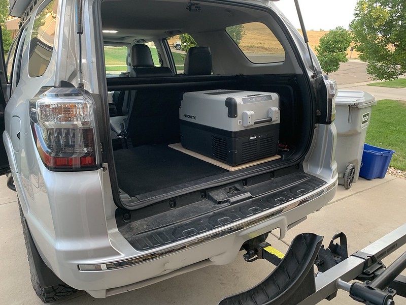

I got the fridge install finished.

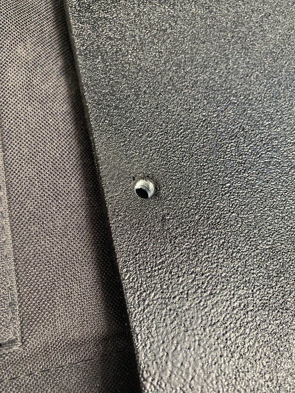

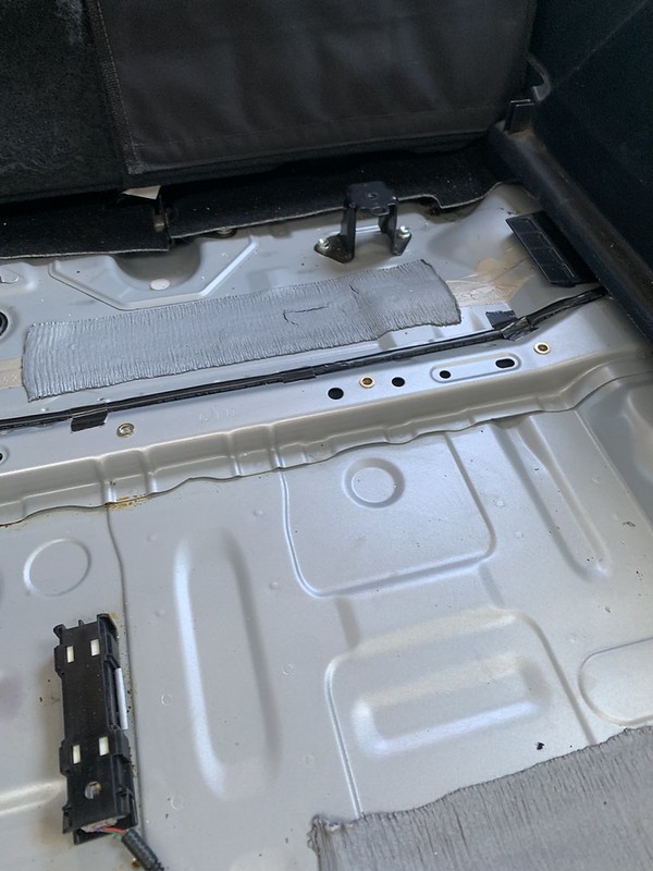

I was kinda planning out the space. I didnt have enough rivnuts on hand so I had to order more but this was the gist of it. I wanted to to do 3 rivnuts along the brace and 2 towards the back with spacers.
Rivnuts installed

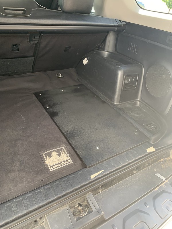

I cut off the insulation from the underside of the carpet where the board would sit to give it a more solid surface on the hard foam under the carpet and bring the overall height down a hair.
I countersunk the 5 holes to mount the board the to the floor of the body so it sits flat and flush and for the side to attached I used pronged t nuts that were glued and hammered in. Then I coated the board with black primer/sealer scuffed it up and hit it with 4 coats of bedliner.
I cut holes in the thick foam for the spacers to slide in, then I cut small holes in the trunk carpet for the bolts to pass through and I cut out a scetion of the Canvas Back liner so it can just be permantly sandwiched in there and mounted up the board. Its supper solid, it doesnt flex or move.

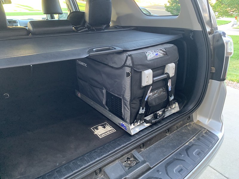

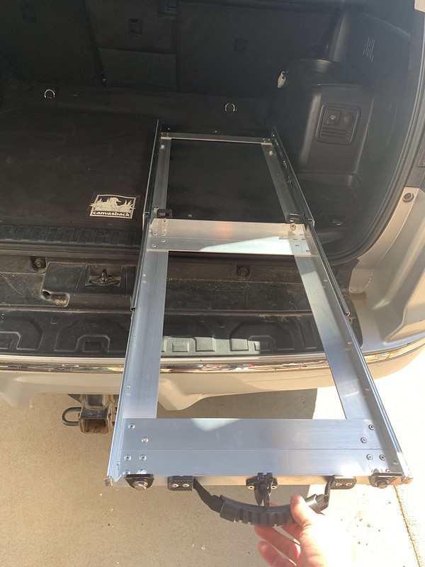

From there I bolted up the DFG Offroad slide.

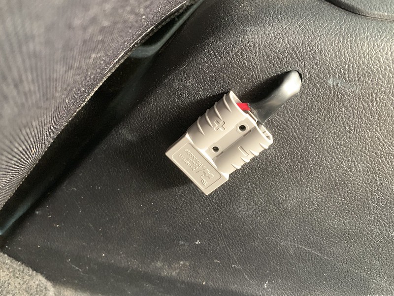

I checked to see how long I'd need the wiring before cutting the 12v plug off and installing an Anderson SB50 connection.
When I was planning everything I was measured known dimensions out with a tape measure and made some assumptions about the unknowns and it was going to be to close to tell if it would fit with the privacy cover or not. I'm happy to say it all came together exactly how I had hoped.

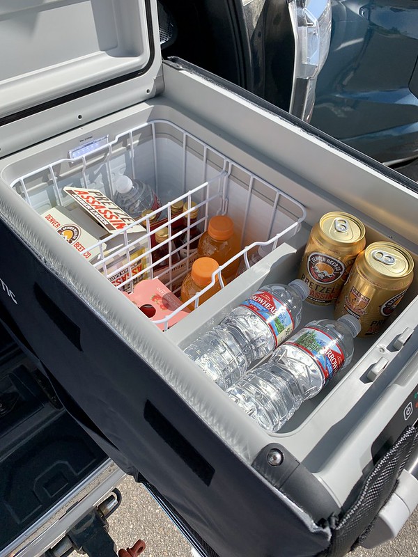

You can retract the cover and the fridge can be opened and closed as it sits. With the cover in place, it can be slid right out and opened.

We already got to put the fridge to good use tailgating for the Chicago Bears visit to Denver, they pulled off a win in a thriller.
It's so nice having always the perfect temperature drinks ready to go.

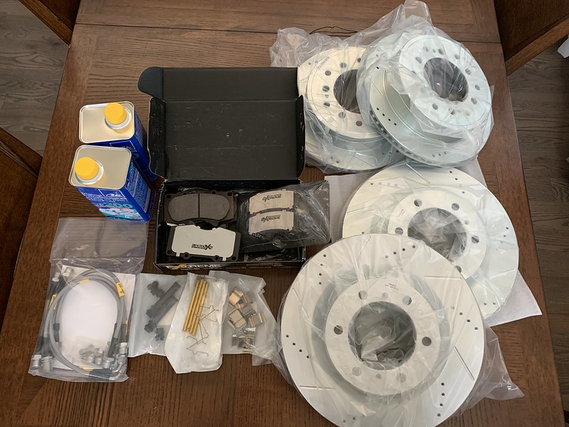

I live in the Colorado mountains, I have some extra weight and bigger tires on the 4Runner, plus I tow from time to time. My brakes don’t have it easy so it was logical to look for an upgrade over stock, especially given the cost of stock pads and rotors. When it comes to parts I always buy OEM or I upgrade. I started researching and decided to go with the Powerstop Z36 brake upgrade. Powerstop recommends that kit for a vehicle with larger than stock tires, added weight, or for towing at least once a year. It's a pretty complete package - pads, rotors, and hardware and on forums and facebook groups, I was seeing a lot of positive reviews and recommendations for it. I also decided to replace the stainless steel brake lines with the kit from Goodridge. A reputable brand, even Tirerack sells them, and their kit was actually for 6 lines, 1 per wheel and the 2 flex lines from the body to rear axle housing. I got high-quality DOT4 fluid and I was good to go.
Everything ready to go.

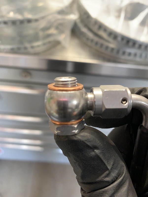

I thought I'd start with the stainless steel lines first. I was matching everything up to make sure it was right and notice a major, MAJOR, problem. The new bolts that came with the new lines to bolt the banjo fitting onto the rear caliper are dangerously undersized. You should have quite a few threads to screw in before you get to the point of collapsing the crush washers... this pile of hot garbage has 2 threads exposed.
This is dangerous, its an accident waiting to happen and there's not a chance in hell I would install this on any vehicle. This is extremely likely to end in catastrophic failure of the brake system. My mind was blown at the level of oversight here.
So the lines are a bust... we said screw it I'll leave the lines alone for now and we'll just do the brakes.

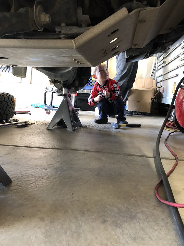

My helper and I started to tear everything down.

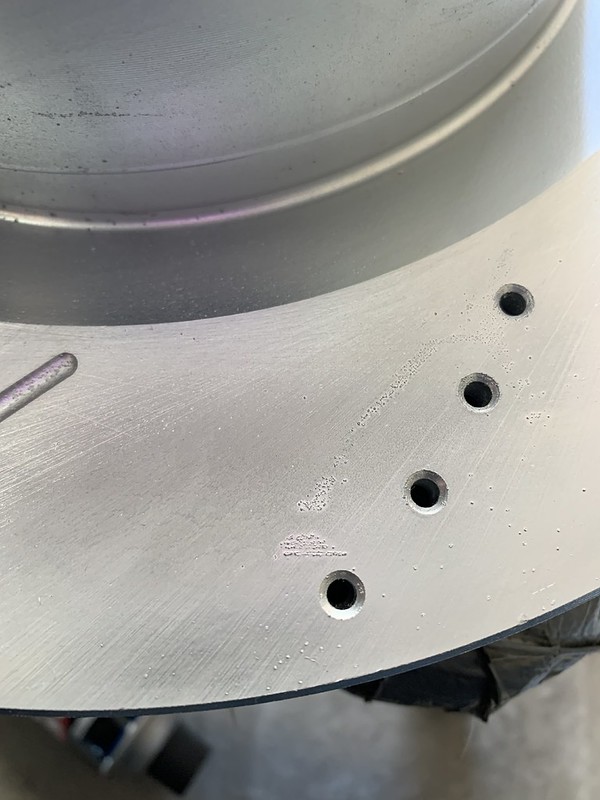

Turns out the Powerstop kit wasnt any better than the brake lines!

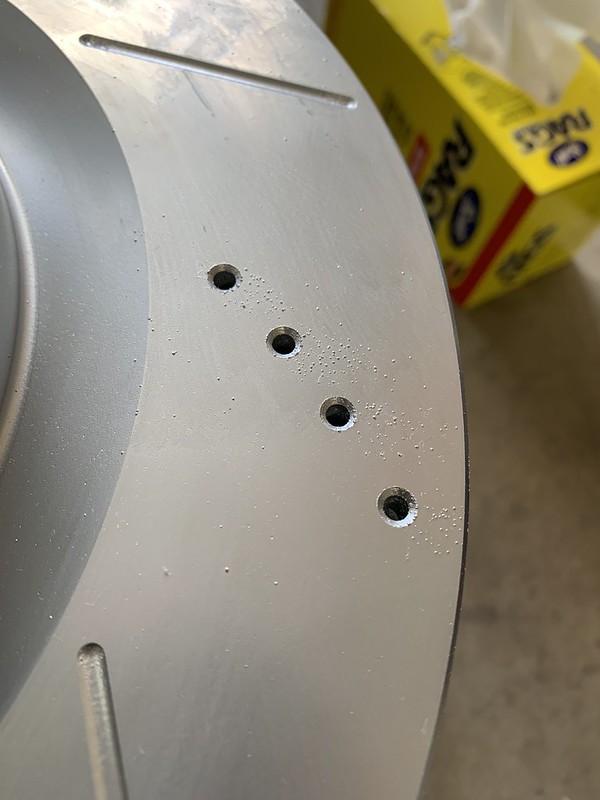

There was all sorts of debris in the zinc coating just waiting to get embedded into the brake pads. I've never seen a worse finish on new brake in my 15 years of working professionally in automotive.

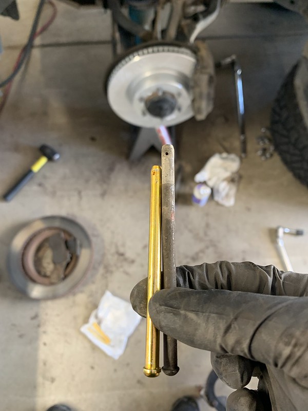

I installed the pads and went to put the caliper pins in, but wait a minute... they aren't long enough to actually come out the back of the caliper.

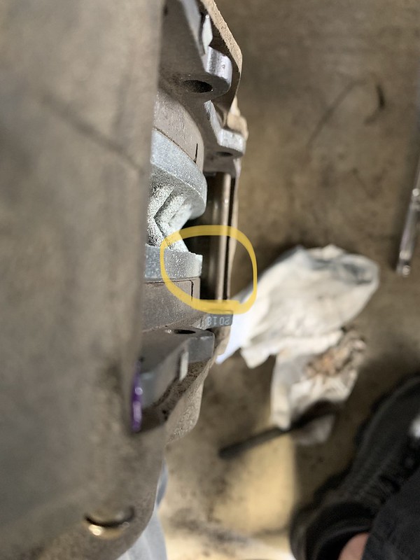

So I reused the stock hardware to properly secure the pads and found another interesting tidbit.

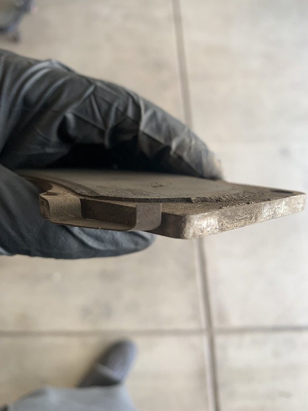

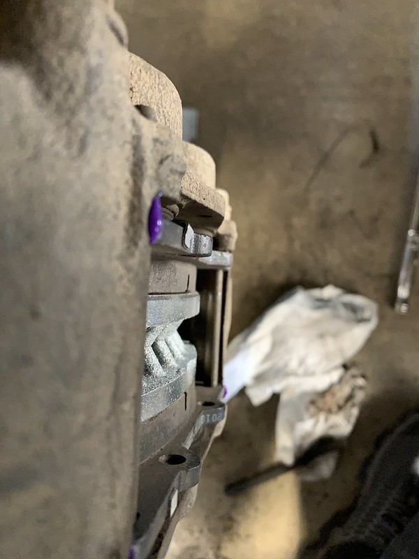

This is how a pad should sit, the friction material stops just short of the edge of the rotor, especially when there a slight chamfer on the edge of the rotor. You want flat surface on flat surface.

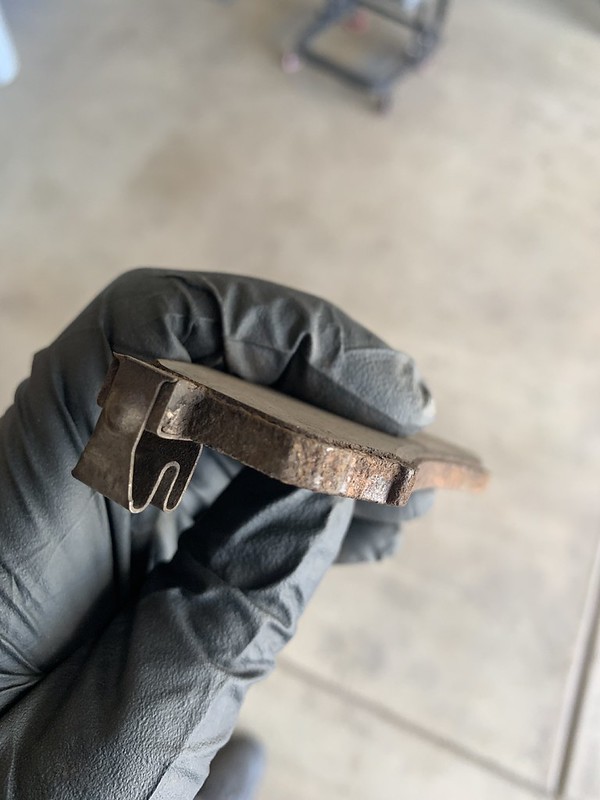

But the inconsistencies in the build quality of the pads left the friction material hanging just a hair over the edge of the rotor. This is not acceptable.
