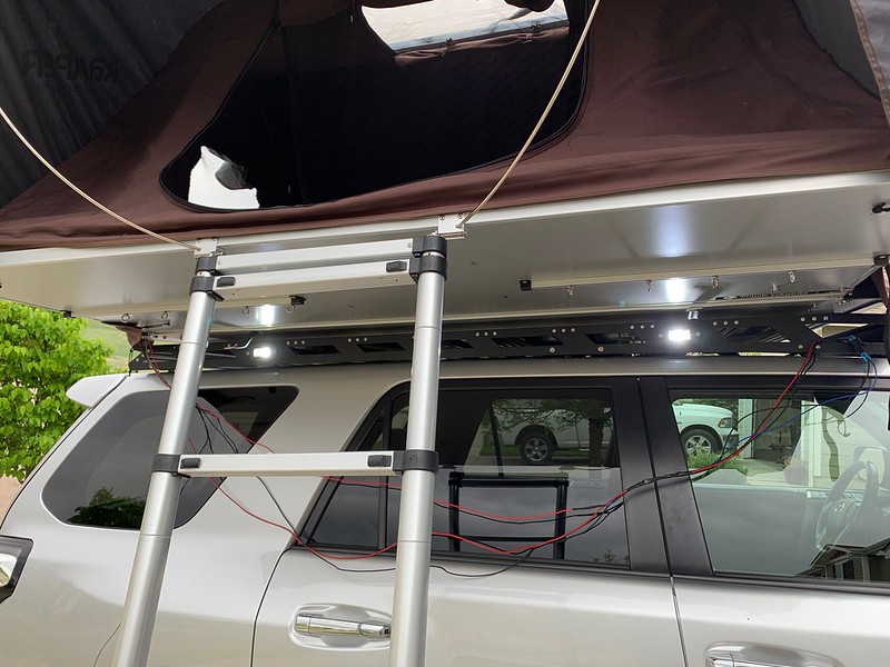

2 separate interior lights, a red one and a white one.
They work.
My helper.
Right side lights work.
I ran out of wire loom, I still need to do the left side camp lights, and there will be some tidying up to do. I rushed it a bit because our first camping trip of the season starts today. My wife gets out of work in a couple of hours and we'll hit the road. 3 days 2 nights.

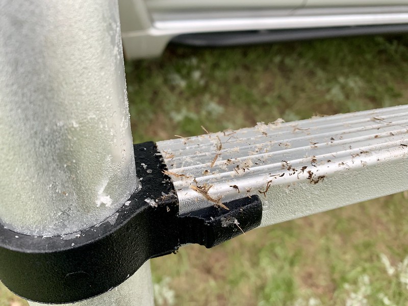

Frost on the ladder.

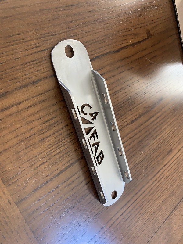

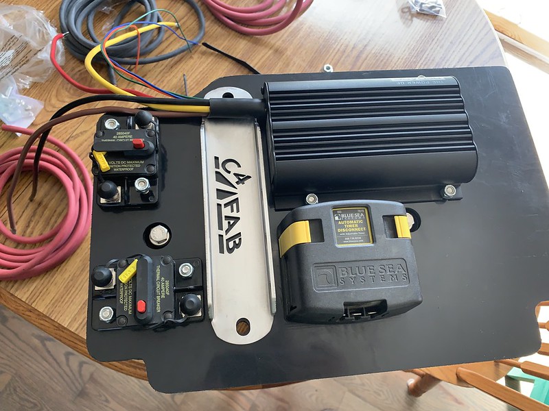

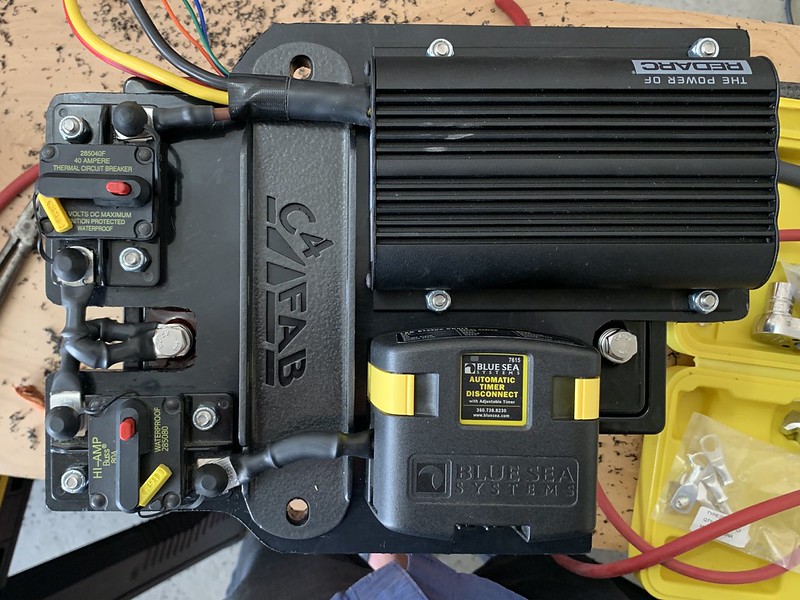

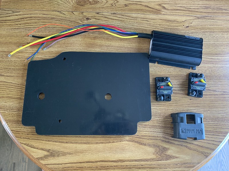

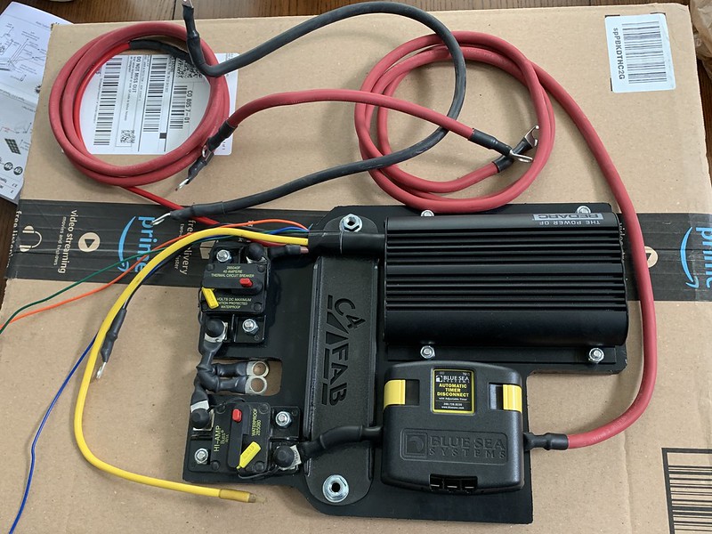

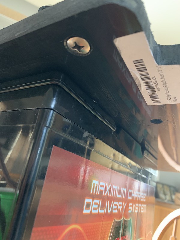

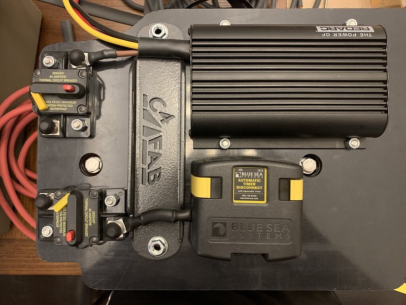

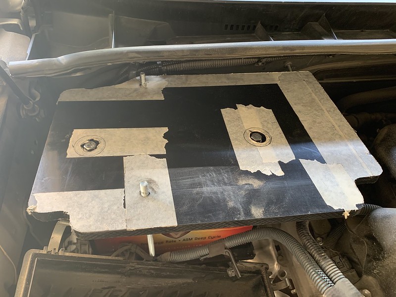

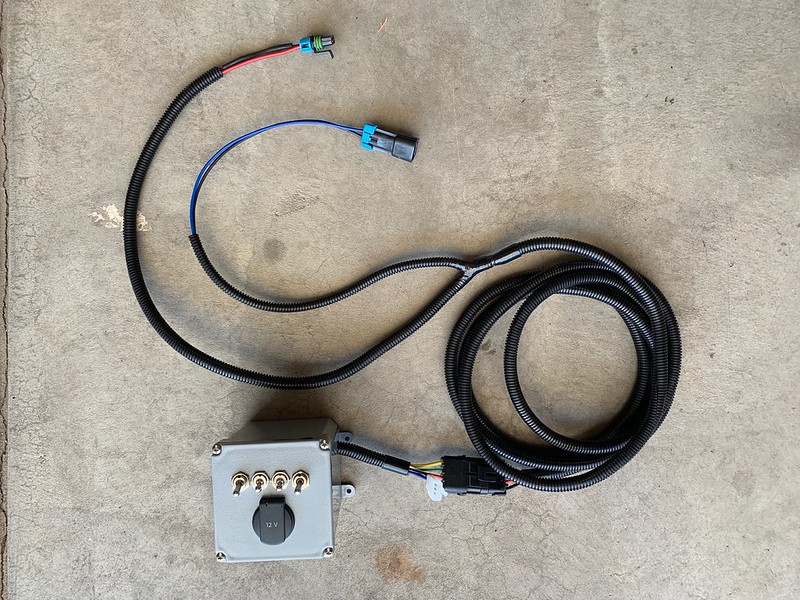

The past couple days I've been working on the dual battery setup.
I got the C4 Fabrication passenger side firewall battery tray painted and installed so it's not in this picture.
I made a cardboard template to figure out how much room I had to work with and transferred it to a 1/2" piece of HDPE.
Trying to visualize how I want the components laid out for a clean install with minimal wiring.
Test fitting and checking clearances with a rough layout.
I'm happy with the layout but I need to modify the hold down so there no interference with the wiring.
The top end is modified, the bottom end is not.
Proper clearance.
Countersunk bolts so it can sit flat

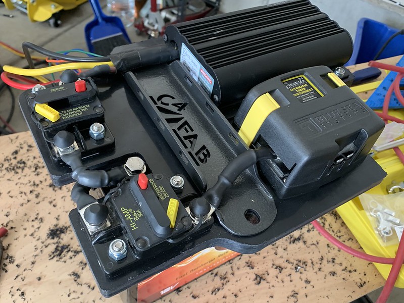

I got the bottom of the hold down trimmed for clearance and painted and then everything laid out to map the excess real estate to trim.
Trimmed down and wired up.
I need some wire loom and I have to find the paperwork and figure out the small wires on the Redarc, but the cables almost all of the wiring is done. Almost ready for install.
