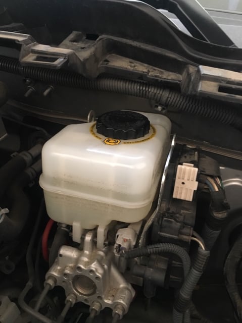

Brake fluid:
Did you know the generally accepted lifespan of brake fluid under normal operating conditions is 2-3 years?
Let’s starting with the basics: The brake system is hydraulic system, hydraulics work on the principal that because fluids can not be compressed is very effective and transferring and applying massive amounts of pressure.
On the simplest level you apply pressure to the brake pedal, that pressure is increased and then a lot of hydraulic pressure goes through the brake lines to the pistons in the caliper, the pistons then squeeze the pads against the rotor causing huge amounts of friction, the friction causes the vehicle to slow down.
A by product of friction is heat, and a lot of the heat gets transferred back to the fluid. Brake fluid has a pretty high boiling point but track use and/or abuse can cause it to boil. When the fluid starts to boil air bubbles show up, and while fluid isn’t compressible, air absolutely is. When the fluid boils the pressure you apply to the pedal is used to compress the air instead of transferring pressure to the fluid so it can apply the brakes. The result is the brake pedal dropping to the floor while minimal braking is actually happening.
The brake system has a cap but it’s not sealed system. As the pads wear the pistons sit further and further out, the fluid in the reservoir takes up that extra system volume as the pads wear. Because it’s not a sealed system it’s susceptible to moisture and condensation. Moisture in the brake system can rust out components from the inside which can result in catastrophic failure with no visual warning signs leading up to it and it lowers the boiling point of the fluid. To combat that, brake fluid is designed to be hygroscopic, meaning it absorbs moisture. There is only so much moisture it can absorb before the fluid is considered saturated, as it absorbs moisture it lowers the boiling point further and further and it gets significantly worse once it reaches its saturation point. This is where the service life comes from.

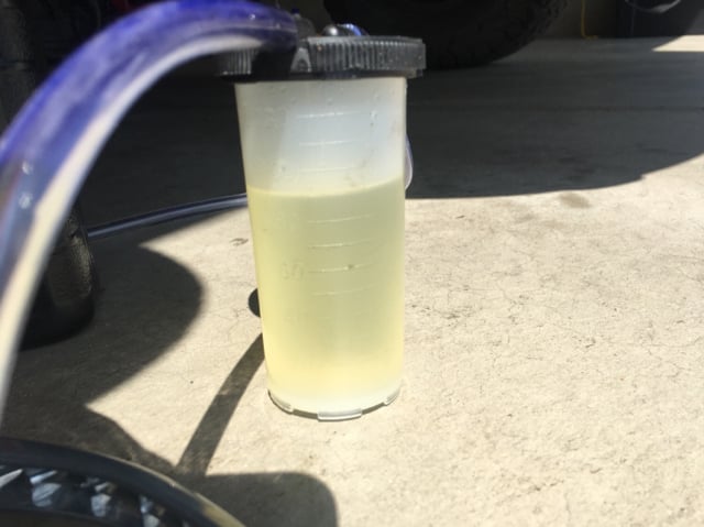

Flushing out your brake fluid is pretty simple but it is a safety system so caution must be taken and double check your work. I always use 2 big bottles of fluid for the flush and I note the fluid level when I start and set it to the same level when I finish. If it’s midway on the scale and you fill it, when you do the brakes and reset the pistons to the fully retracted position you will overflow the reservoir.

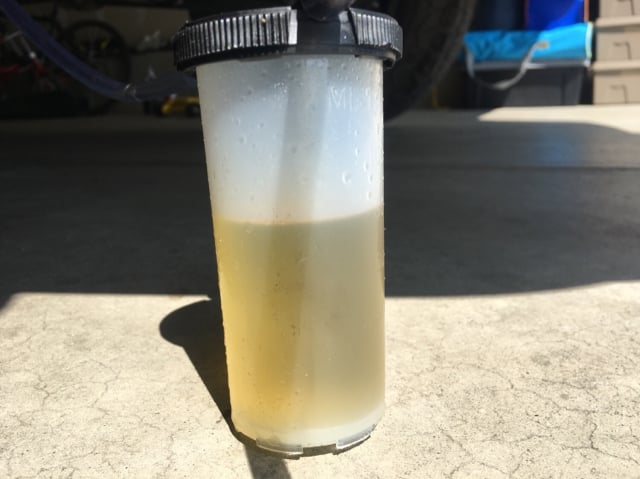

Start with the reservoir. Flushing the fluid out of the brake lines with old fluid from the reservoir is not really beneficial. Take the cap off the reservoir and suck as much fluid out as you can - even a cheap turkey baster will work. Suck the reservoir down as far as you can and then fill it to almost the top with fresh fluid.
The shortest path is the path with the least resistance so I start at the left front. Open the bleeder and stick a piece of vacuum line on the nipple to direct the fluid into a container, with the cap off the reservoir it will have a pretty quick consistent drip. (Personally I use a mighty vac with a fluid catch and apply a little bit of suction to the bleeder just to speed the process up over letting it gravity bleed). Keep topping off the reservoir the level drops. I use an entire big bottle on this step, this ensures the reservoir is fresh clean fluid for flushing the brake lines with. Close the bleeder, your done with the reservoir and the first wheel.
From there one at a time open a bleeder and flush about 1/4 of a bottle through the remaining 3 bleeders leaving you a bit for if you need to top off the fluid back to where you started when you’re done.
You will see a difference in color with old fluid to new fluid.
It’s important to note that the bleeder screws are just blocking or unblocking a fluid passage, they are more or less small hollow 10mm bolts. They don’t carry a load, they aren’t attaching anything, don’t go crazy tightening them, they don’t need much.
Brake fluid will eat paint if it’s left to sit on a painted surface so when you’re finished make sure to clean up. A lot of people think brake clean/brake parts cleaner is the way to go, it’s not. Because the fluid is hygroscopic you literally rinse it right off with water, it will remove it completely and immediately by hosing it off or hitting it with water from a spray bottle. Brake clean smells, it’s highly flammable, it’s more expensive, and it doesn’t clean up brake fluid as well as plain water does.
Now the 5th gens are a bit different than most in the sense that they use an accumulator (basically because the 5th gen is an outdated dinosaur of a vehicle). Because of the accumulator system after flushing the system like this you will get ABS and traction control warning lights in the dash briefly once you start it up and apply the brakes to make sure they hold pressure. It with trip a fault in ABS system for low pressure on the accumulator. You can clear it with any scan tool, code reader, or mobile app that can read the ABS system.

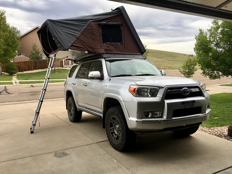

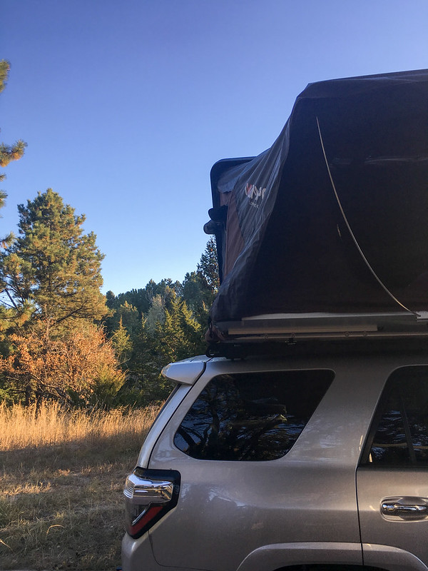

My son is Two and half and were fnally comfortable with taking him camping for extended trips so my wife wanted to look into campers. Originally she was thinking we’d get a pop up camper as she’s not all that comfortable with the thought of ground sleeping in a tent in the natural habitat of many very large predators. We start looking into it an they are big. If we get one were either paying a monthly to store it somewhere or filling the garage and parking both vehicles outside. We also found out that a lot of soft sided pop ups are restricted in bear country in Colorado. A hard sided pop up adds even more weight that we’d have to be pulling though the mountains at high elevation where the power is already reduced. The cost isn’t terrible but its pricy for something decent and if you opt for something with shower and bathroom inside your cost goes up quite a bit. If you don’t go for the plumbing what’s the point of spending all that money for a glorified tent while taking up storage space, dragging it all over the mountains, and not being able to access some of the dispersed camping because its to rough of a trail to get a pop up in and out. Campgrounds in Colorado see to tonfill their reservations pretty far out as well. It just didn’t seem like a good option for short notice spur of the meant getaways.
So, we decided to revisit the idea of a roof top tent. It’s relatively light weight, its quick and easy to use, you can set it up anywhere – pavement, dirt, on rocks, in flooded area, whatever. Where ever you can get your vehicle, you can setup the tent. There no huge camper to store, there minimal weight, being up high puts my wife’s mind at ease, were not restricted in where we can take it, and above all else its convenient and easy, and let’s be honest, if it’s a chore to use something you’re less likely to use it.
So I’m picky, I’m very critical, that’s no secret. I work in quality testing and development of preproduction and prototype vehicles and technology for the high end lines of a very large automotive group. It’s literally my job to scrutinize, nitpick details, and find flaws in things and analyze them. When it comes to buying stuff, especially aftermarket upgrades and parts for my vehicles, I’m almost always at least somewhat disappointed because things rarely live up to my expectations. On paper I really liked the iKamper Skycamp (https://www.ikamper.com/pages/skycamp) but it comes with a pretty hefty price tag. I really wanted to check it out in person before spending that amount of money on it. iKamper gave me the name of the only authorized retailer in the region and he’s just a short drive from Boulder. I called him and we planned for me to come out and check out the tent in person. It’s a very small one man show of a business, little shop, very personal, and he was an awesome guy. I spent over 2 hours there with him going over everything I can say in all honesty it exceeded my expectations. The build quality fantastic, the thought that went into the design is fantastic, the attention to detail was above what I was expecting, and it’s even roomier than I anticipating. Lots of simple things add up, like the entire fabric portion is replaceable so if something happens you can replace the fabric instead of the entire tent, there’s a little lip spoiler at the front edge so wind doesn’t catch and try to create a gap for dust to get in while driving, the shape of the hinged lid area when opened is perfect to fit a pillow and provide a few more inches of extra room that you don’t expect to be there. The sky light design, the high thread count 2 layer fabric that has a small air gap that works like insulation, the available “Rocky Black” finish which is a Rhinoliner bedliner type of coating on the hardshell from extra UV protection, protection for rock hits on the highway and branches while off roading. Even the mattress seems to be just enough that you don’t need anything else, and the floor structure is made of a aluminum honeycomb which is very light weight and extremely strong. its literally a minute to go from fully stowed to setup ready to use. Lots of cool little stuff that doesn’t translate into pictures you see in reviews and stuff like that (or the reviewers just honestly overlooked).
I’ve checked out a bunch of the common tents Cascadia, Tepui, ARB, and the build quality doesn’t compare. Most of the soft shell tents come out of the same factory in China slightly tweaked and rebadged for whatever company. I even looked at a very high end Roost hard shell, that one was great but hugely expensive and only sleeps 2. The iKamper one is the first 4 person hardshell roof top tent I’ve ever seen and they nailed it. iKamper actually started on Kickstarter with the mentality the current roof top tent offerings are not good enough and they got a massive response from people wanting bigger and better. After seeing it in person, messing with it, scrutinizing it, taking it apart, putting it together I was sold on it.

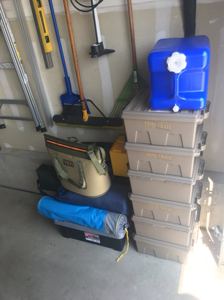

Trying to organize the camping stuff.

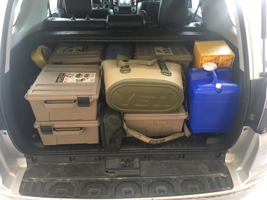

We got a bunch of these crates and filled them up. They all latch, relatively heavy duty, all of the tan ones have 0-ring type gaskets to keep dirt, bugs, and moisture out. The big one is the camp stove, pots and pans, things for cooking. Of the smaller boxes one is stuff for cleaning up and rain gear. One is for non temperature relevant food. One is for tools and fire stuff. One for clothes and toiletries, etc etc etc. I still need to get them fully organized all labeled.
In the pic there’s leveling blocks and wheel chocks that will be used with the roof tent but there’s also the ground tent, rain fly, and 2 cots that won’t be needed ones the roof tent goes on. There’s 3 chairs in there, 6 gallons of fresh water, yeti cooler... everything but sleeping bags which will just go on the floor in the back seat. It all stores up nicely under the cargo cover with room for more but we wanted to be able to have everything in there without it looking like we have anything at all when it’s parked.
Not bad.
Now I need to add some more garage storage, I’d like to have it all up on shelf so it’s just fill up the water, grab some food, and toss the boxes in back so we can be be more spontaneous and less planned in our adventures.

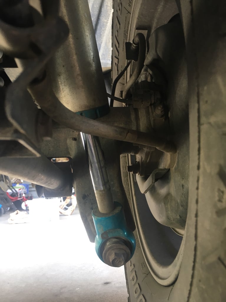

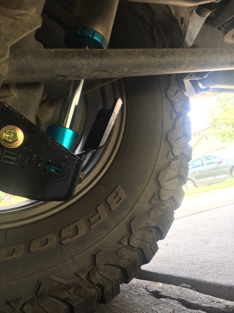

Quick random mod, with big ass rear dampeners, especially with remote reservoirs they are mounted up side down in comparison to stock. That means the shafts, although hardened and strong are susceptible to impacts from debris, especially rocks on high speed dirt and gravel road. The most common cause of needing a rebuild in a setup like this are impacts on the shaft causing a burr that tears up the shock seal. You can replace the shafts and rebuild the shocks with seals for relatively cheap, but its money, time, and effort I don’t want to spend and down time I don’t want to deal with.
These steel shin guards make for some cheap insurance. They come in bare steel so I just brushed on a couple coats of the same “tractor, truck, and implement” paint I used on my frame before mounting the sliders.
