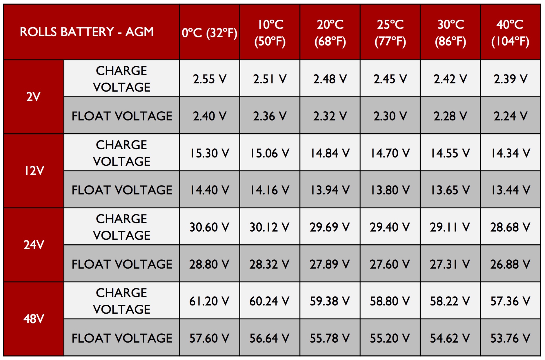

I had never read the Odysseys tech manual till you posted this. This is from the manual "the higher the ambient temperature the lower the charge voltage". I live in the desert where it gets over 115 and seldom below 50 degrees. On the chart that I could not get to copy over it shows much lower voltage needed in warm temps. This is probably why I never had a problem.

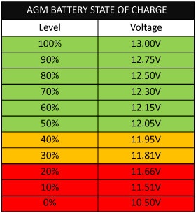

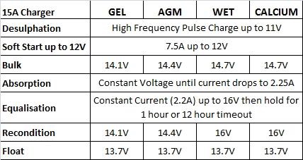

I believe for desulfation you need a pulse charge. See the SOC & AGM charging figures below to determine your AGM health:

There's an actual de-sulfation process:
http://www.odysseybattery.com/documents/ODYSSEY_Battery_Reconditioning_Charge_Procedure.pdf

After thinking about this I put my AGM on the charger last night. When new the battery was 12.49v (80%). Resting voltage was 12.68v (85%)after adding the HKB (this is where the stock alt brought it to).
After an hours worth of combined driving with 1-2 starts with the HKB installed, my resting voltage was 12.74v (90%).
Running my charger, it was outputting 13.5-14.5v at 6a on a pulse at first then bulk charge around 14.5v. The float charge was 13.57v.
After the float charge my battery resting voltage was 12.95v (98%).
After another hour of driving with 3 starts, my resting voltage is 12.85 (95%).
If an AGM battery at 100% state of charge is 13v, keeping it close to that will keep the battery healthy longer. The HKB fuse seems to help with this, but I do want to measure after a 30-60 min trip to see if it rests above 12.85v. If it does, I’m happy with maintaining a 95%+ state of charge. Especially when stock was closer to 85%. At stock alternator voltage I would still use an external charger regularly. At 95%+ I won’t bother.
