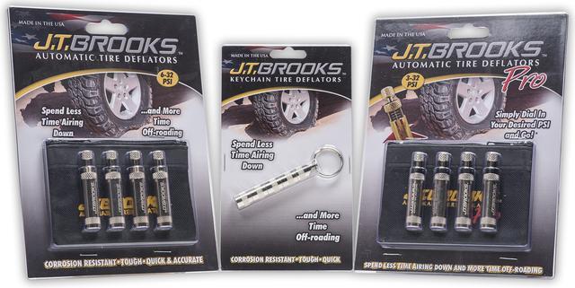

I use use a combination of air-down tools. Have a set of four deflators that can be pre set at your desired psi. Just screw them on and they stop releasing air at that psi. They are slow but you can just leave em. I also use an ARB EZ Deflator which actually pulls the valve stem and airs the tire down very fast, has a built in air gauge and you stop it whenever you want. Fast but you can only do one at a time. Sometimes I use both if in a hurry. Many deflator tools out there, but beware of the cheap stuff. They don't work well and are inconsistent. JT Brooks makes some quality deflators. Happy trails!

These are hands down the best deflators around. Set it and forget it!
http://www.toyota-4runner.org/group-buys/219706-jt-brooks-tire-deflators-group-buy-made-usa.html
