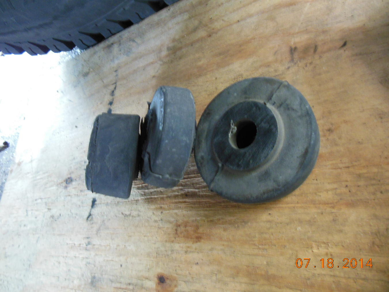

I installed the air bags about 3 weeks ago. I did not use the "puck" thing, I went the route of cutting the jounce bumper down to the last section. I routed the air line through the bottom hole and then routed the individual lines to a "t" above the spare. I drilled a hole in the receiver hitch and mounted the air valve so it sit right next the receiver for easy access. I run 7.5lbs which works perfect for me as a DD and then 25-30lbs for when I am loaded. With this set up I have about 2 inches of travel before it hits the bag so it is like a progressive rate on the down travel. Very happy with the set up and yes i did remove the coils, just seemed like the best way.

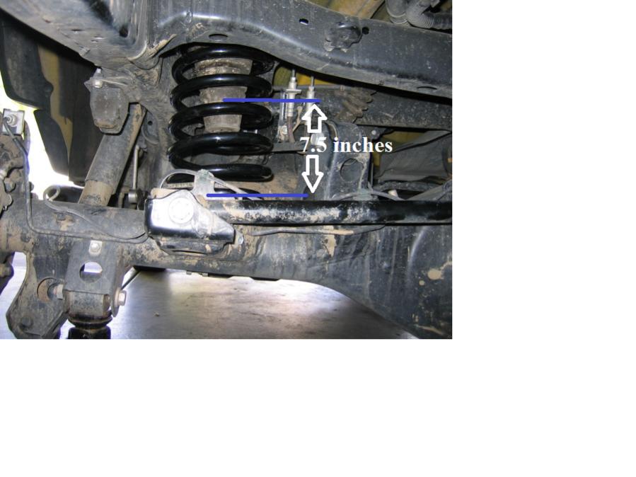

Can you post a picture of your airbag setup? So from what you wrote, you have a 2 inch space between the air bag and the bump stop?
Which part you cut off from the bump stop? the last part from the top or bottom (narrow-end)?
This is what I am going to do:
I will not use the "puck" thing.
Let's say just the air bag (without air) has a height of 8 inches.
I'll measure 7.5 inches along the bump stop from the axle surface (while the truck is unloaded) and mark and cut the bump stop.
Then I'll insert the air bag with nipple down and route the hoses.
What do you guys think?

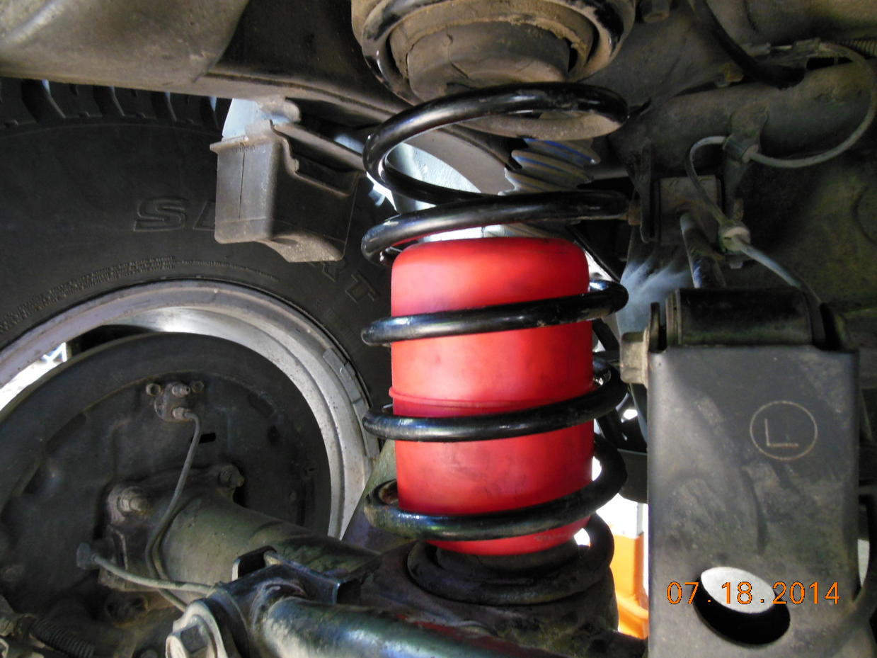

Air lift installled

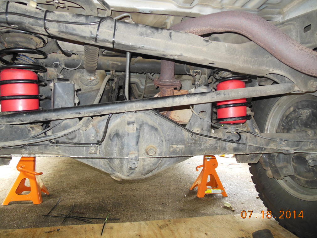

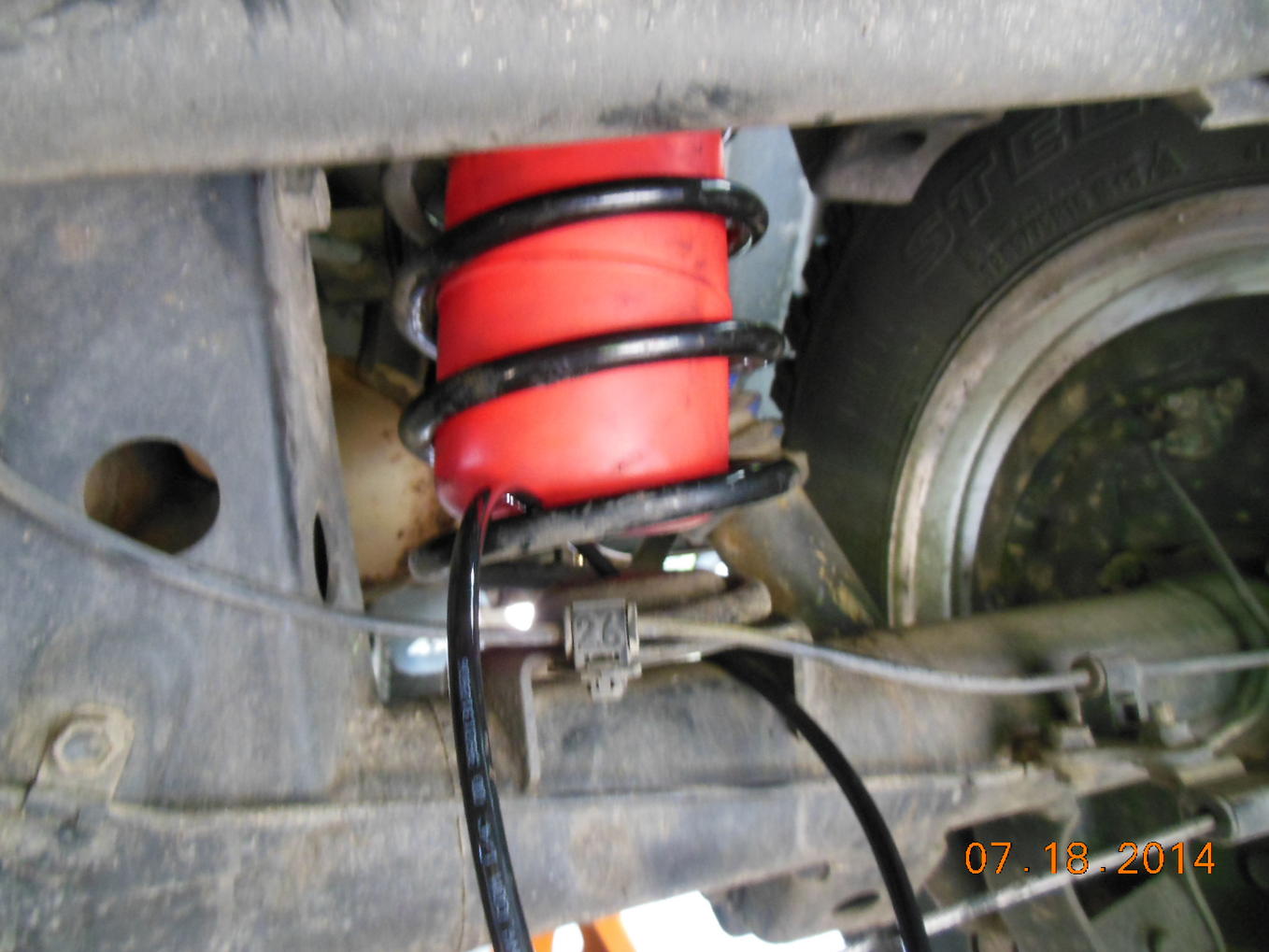

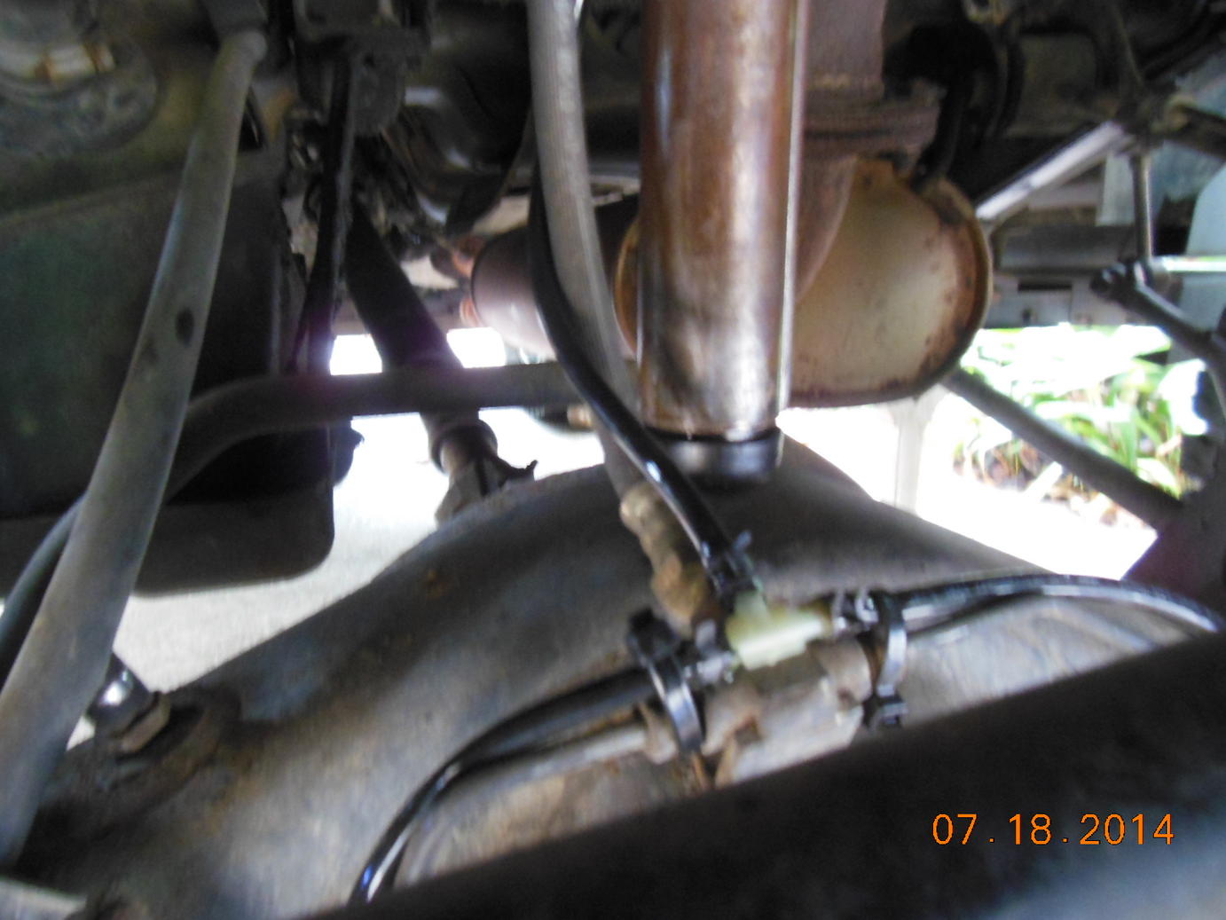

Alright.... got time to install the air bags...
Took about 2 hours
Didn't pull out springs... just cut the bump stop and slide in the air bags in.
Hint: just remove the air nipple cover before you slide the air bag into the spring.

Last picture shows how I removed the bump stop from the spring!

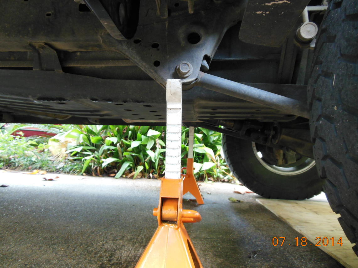

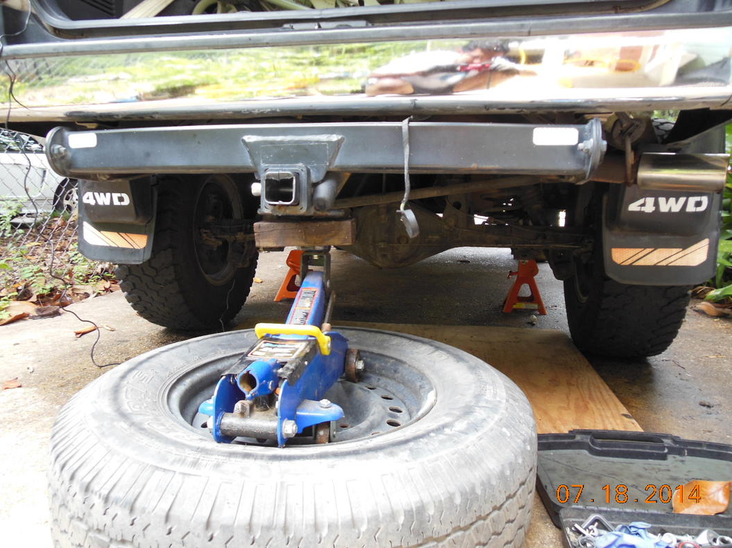

nissanh - Your jacking and jackstand methods look kind of sketchy, even if the wheels were on it. Best of luck with the airbags.
Just an FYI. It would be safer if you put each jack stand underneath the rear Axel, directly touching the axle tube. Not under the LCAs like that where it could slide off if there is a small earth rumble.
So you got over 1" of lift? I don't really understand air bags that well.
Air bags help reduce sag. They don't actually lift the vehicle at all. All they do is sit in the springs and prevent them compressing based on the amount of air pumped into them.
It looks like nissanh's springs are either sagging or he is running with some weight on the rear and by adding the air bags the springs he was able to get about an inch back in height.
Jack stands
After putting the truck on jack stands, I removed the hydraulic floor jack which is on the spare wheel and placed my spare tire from my car and some solid wooden blocks right on top of it. As an added safety measure, I placed a mechanical bottle jack up side down between the 3rd member and the truck body. All in all my project was a success!
Brian, I instantly received about 2/3 of an inch (no pressurized air inside the air bag other than 1 bar from the air)
I used some flexible glue before attaching the air hose into the barbs and then installed the metal clamps.
