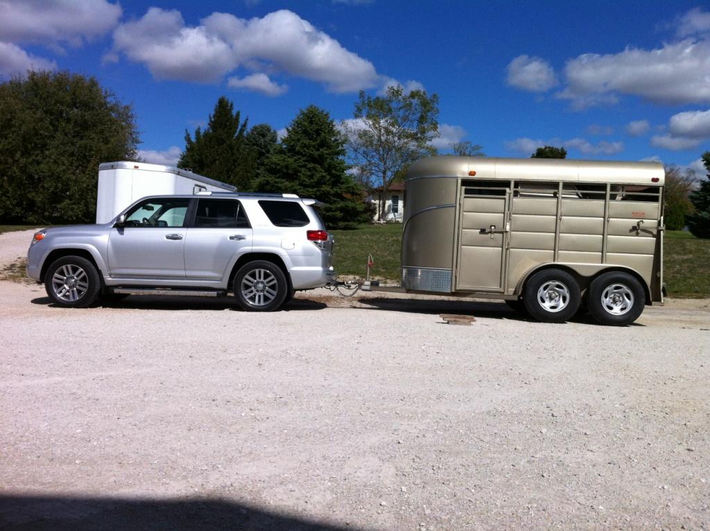

So we've been towing our horse trailer off and on since purchasing the 4Runner. The trailer is roughly 2300# unloaded and we only use it for one horse. When fully loaded with the horse, tack, and some hay it's in the 4000# - 4500# range. We mainly only tow for short distances around northern IL and occasionally somewhat longer ones to southern IL and Indiana, so we're never dealing with any tough hills. And while a V8 would be nice on occasion, we've never had any power problems for our situation. The only thing I've wanted to address when towing is the sag. When everything is hooked up and loaded, the rear drops about 1.5"-2". We get the occasional flash from oncoming cars at night that think our brights are on, but other than that the 4Runner has never felt unsafe or unstable. We've never had any problems with sway or braking (have a Prodigy P2 brake controller) and always take it pretty easy because towing a live animal is a little different than a camper or boat.
