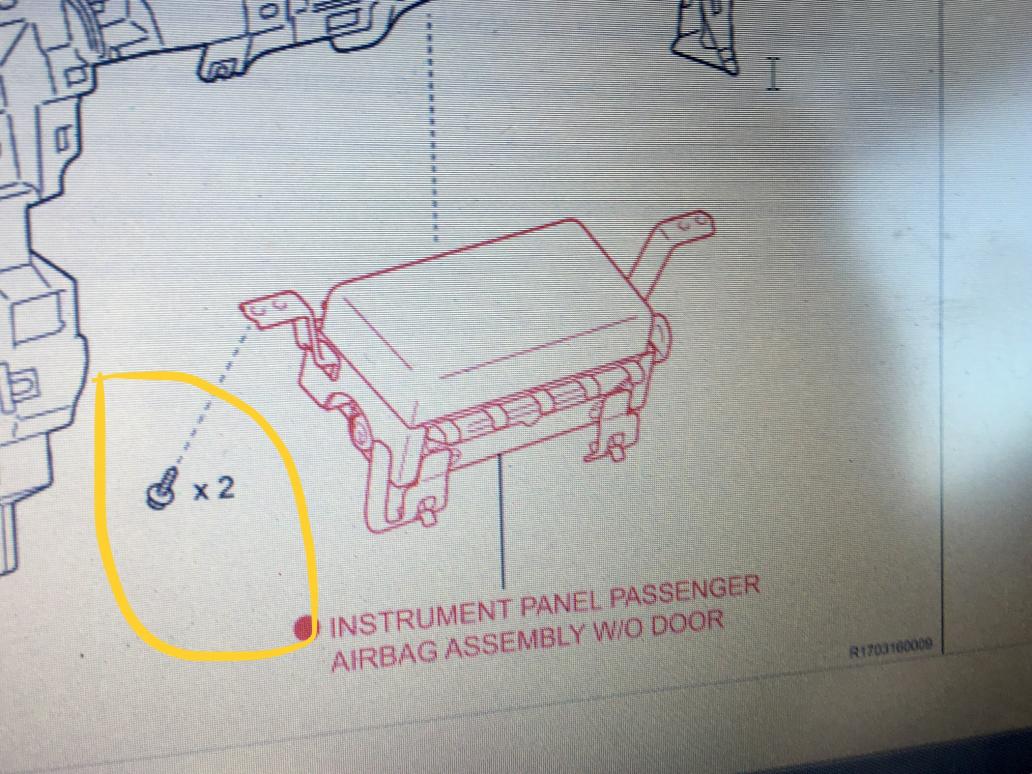

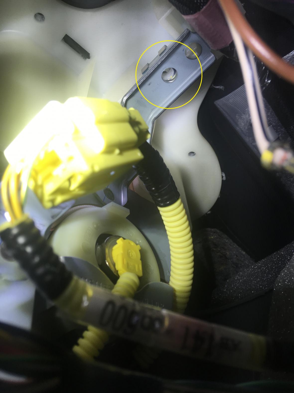

Brought my 4Runner in for the airbag recall yesterday. I had been apprehensive about having this done as work performed at Dealers these days is usually pretty poor.
Dropped car off picked up a few hours later, inspected the work before I left, found knee airbag trim not popped on all the way and lower trim on both sides of radio loose, not a big deal, popped them back on and went home.
Took a better look around when I got home, removed passenger floor mat and found a 10MM bolt hanging out from under center stack trim, and two screws laying on the carpet. Also noticed the knobs for heater control and radio were all scratched.
Called service writer explained what I found and he contacted the Tech. Tech said he dropped a few screws in the dash but he assured me he replaced them.
Not trusting them at this point I removed the radio and glove box, found 10MM bolt missing from radio mounting bracket and the screws were missing out of airbag itself where it mounts to the dash! Also, Knee airbag bolts finger tight.
Reinstalled everything properly shaking my head as this was left in a dangerous condition.
This is why I do my own work!!
Trying to upload some additional pics, but keeps failing.
Heres two that worked.
Good luck to all of you that are getting this done, and it is worth taking some time and rechecking their work.
