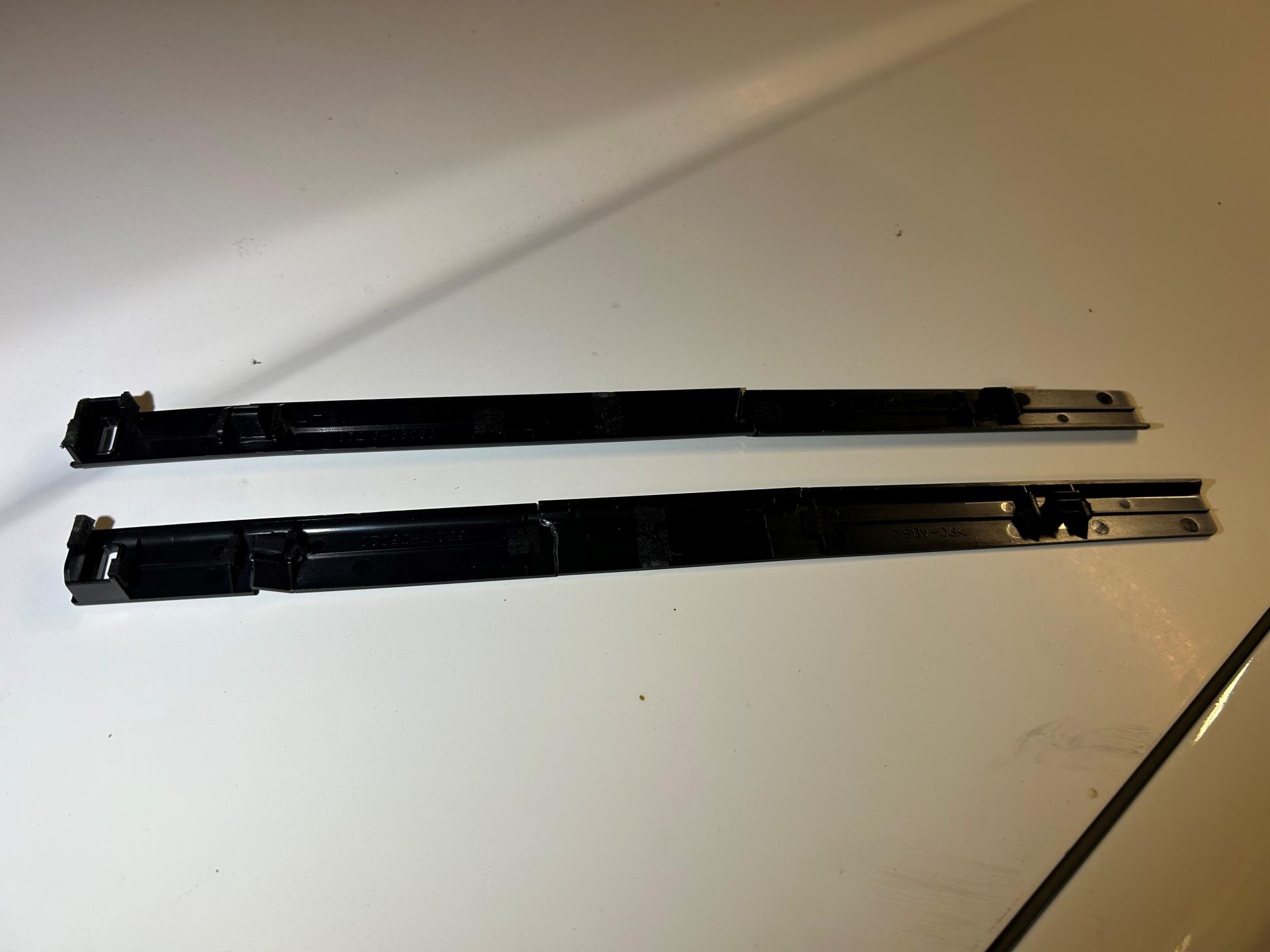

I'm working on the 2004 SR5 sunroof, trying to remove it because the sunroof frame is rotten (replacement inbound). I think there are four torx bolts holding the sunroof to the mechanism. I removed two plastic pieces from the sides of the sunroof that hide the mechanism, and there is another plastic trim like piece on each side covering the front torx bolt and partially covering the rear. I can't get this to pop free, and I'm trying not to break it. Has anybody removed this and have any tips? I haven't found a good video for the 4th gen sunroof removal (other than dropping the headliner and removing the whole mechanism which I'd like to avoid). This one is operating fine so I'd like to replace just the glass (and metal frame it comes in). Thanks in advance!
I decided to break them and see what was what. They're held in by clips, and I can't see a way to get the old brittle plastic to release without snapping these. They also don't seem very important aesthetically since they're mostly covered by another trim piece that is easily removable. Here's a picture of the back of them (showing clips) for posterity.
Once removed the torx are exposed (appear corrosion-free) and removing those looks like it will allow me to remove the sunroof.

In my case everything is salvageable except the window and window frame. I called around to 4 junk yards within two hours drive and struck out. I bought a rust free replacement from eBay.
If you are interested I did a video on my 4runner on replacing the glass and removing the plastic trims...which broke very easily. I am going to see if I can 3d print some new ones, 40 bucks is way too much for a new set of just one when you have both an inner and outer piece. https://youtu.be/RXBhswfl4Dw
