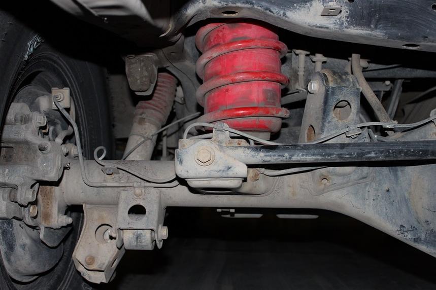

I did the stock size the first time around.
Cut bump with a serrated steak knife.
Stuffed bag in coil.
Its much easier to remove the coil...disconnect rear sway bar links for more drop.
After adding +1.5" coils, I ditched the rubber isolator/bump.
Topped the coil with a 1/8" UHMW plastic cut to fit top of coil (round/disc shape).
Then filled up the coil with AirLift AIR-46132.
J.A.

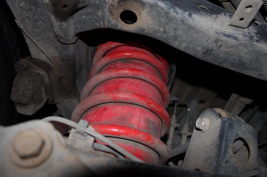

Wow, the 46132 is a 10.5" long bag. How do you like it. That would be good for lifts up to 4". I see you removed the entire jounce bumpstop, so how close do the bags come to the top of the spring with the stop removed?
Bag fills the entire coil.
Seems to work good. I like.
Hard to get a clear view of the top.
5psi in these.
