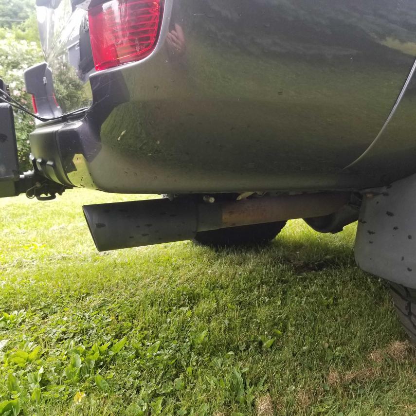

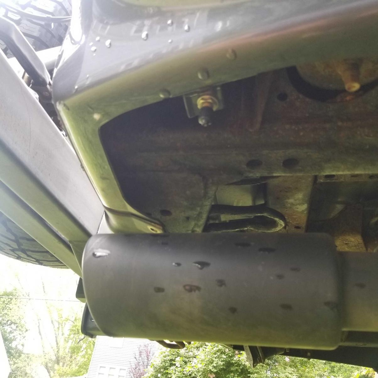

Super easy access even with my Rigd ultraswing. Would imagine bikes would be the same...
Super stealth IMO... I have one on each side in the same spot as I ran the lines separately from each other not 2 into 1.

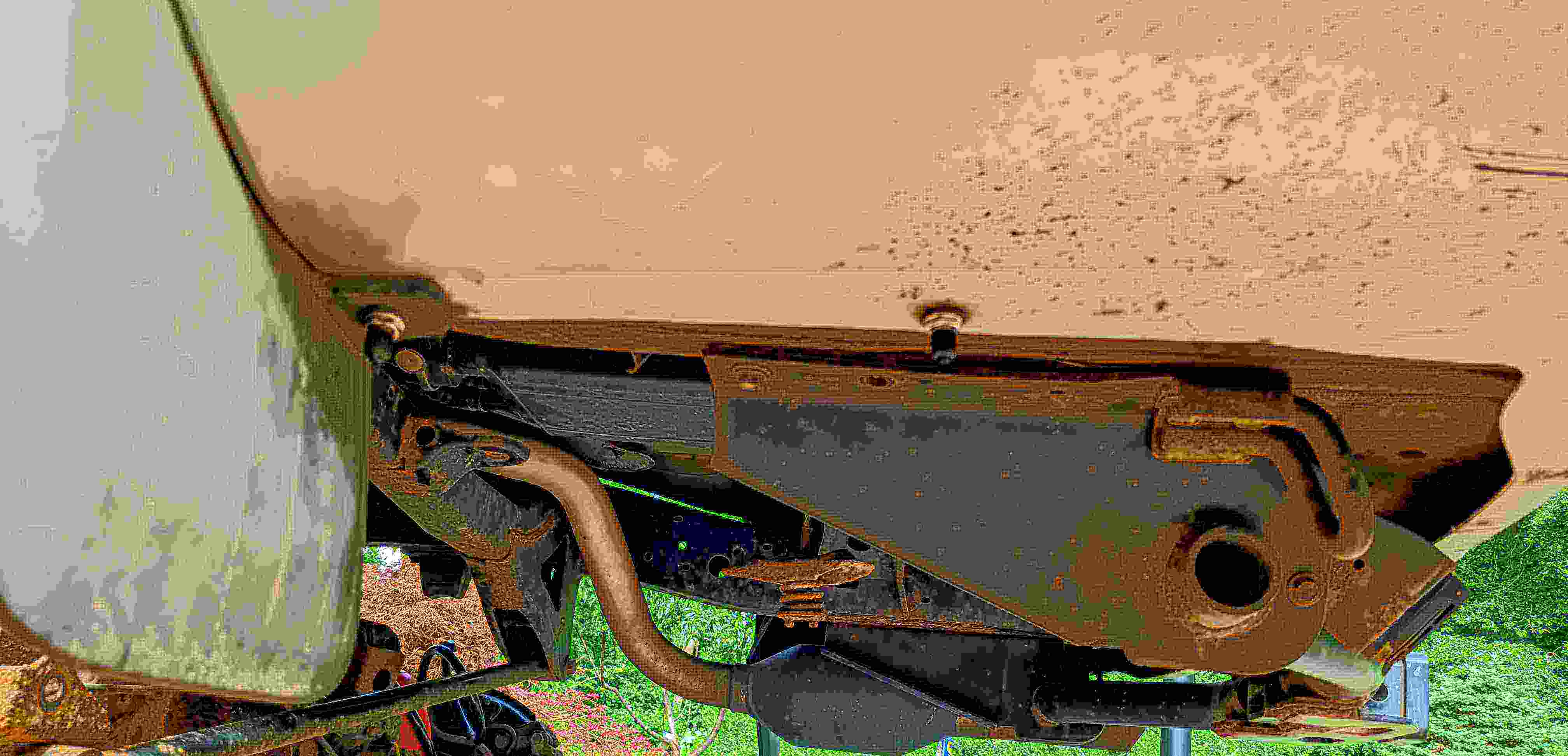

This is how I ended up installing my two Schrader valves: I removed the two screws and plastic threaded inserts behind the rear driver's side wheel that fastened the rear bumper cover to the 4Runners frame. I then replaced the two screws and inserts with the two Schrader valves. No holes to drill and so is completely reversible should I decide to remove the airbags in the future.
