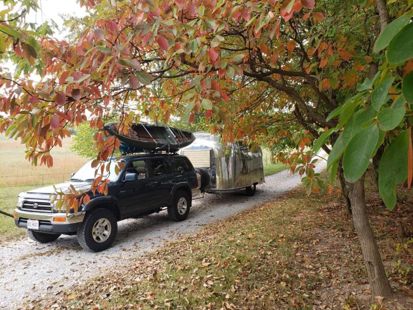

Everyone has a standard but man that is a low one. I have towed with my 3rd gen all over the place from the rockies to Florida. My 4runner has about 100hp less than you. I found the experience to be adequate.
