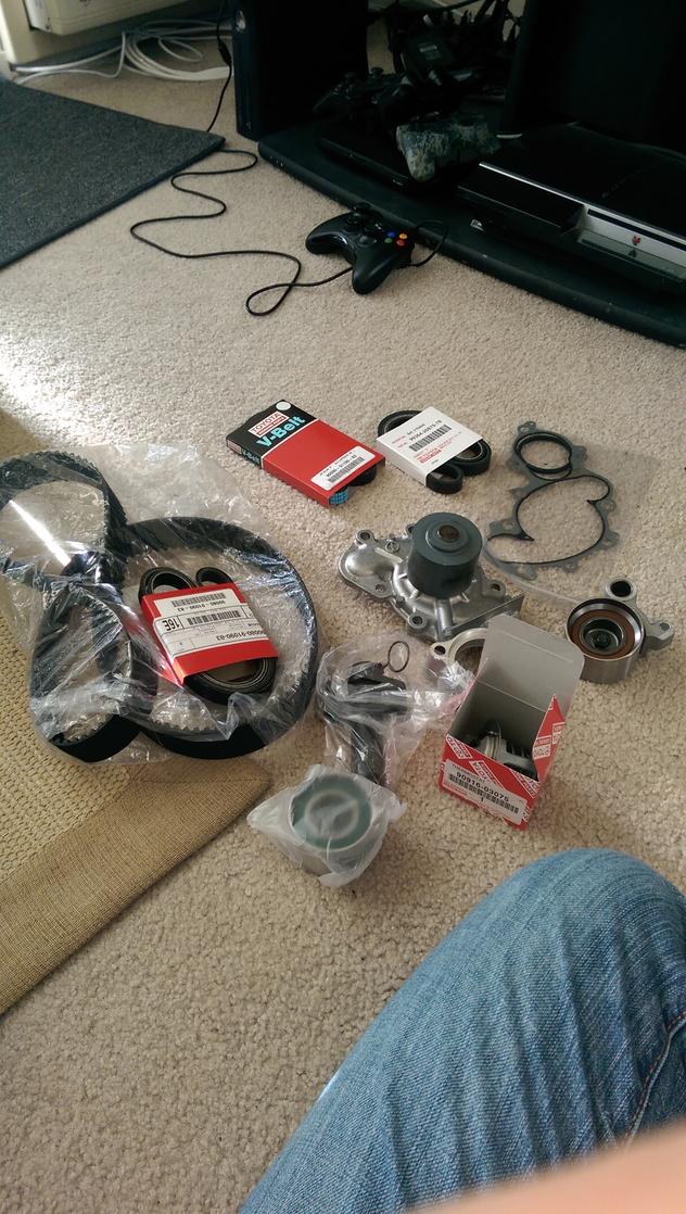

So I went on and ordered the above kit (except from Amazon.com: Aisin TKT-025 Engine Timing Belt Kit with Water Pump: Automotive) and upon initial assessment it looks all OEM, well from the makers of OEM stuff :) I added some photos for anyone interested.
Side note, I have belts and hoses from a project that never got done and I ordered a Stant XACTStat thermostat from other recommendations, I didn't get a photo, but is very well constructed in comparison to other thermostat installs Ive done (other vehicle makes all together). It was also purchased from Amazon.com: Stant 48118 XACTStat 180 Degrees Fahrenheit Thermostat: Automotive
The quality is up to what I expect from an OEM part and once it is all in the truck I hope that there is no reason from me to redact my initial assessment.
Packaging:
Parts:
Even Came with a nice sticker and instructions:
So far the only critique I have is some burred edging on the pump, I will inspect the Toyota one that is coming off to compare the two:

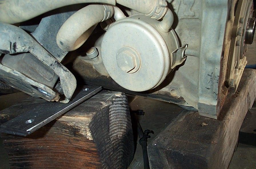

Look for the oil cooler on the (driver's) side of the engine. It is to the rear of the oil filter and vaguely resembles it--round squat thingy with a hose going forward to the water pump.

Those burrs won't make a bit of difference in the coolant flow. More coolant spills off of the pump impellers than those burrs would have an effect on. They are really no different than the rest of the rough casting you see there in the photo.
It looks good. I got mine from amazon via "timing belt kit company". It had the crank seal and cam seals as well as the thermostat.
The 4runner has the engine oil cooler. The taco does not as far as I could figure out.
Both my buddies Tacos do.
I figured the same, but I have read a handful of complaints concerning these burrs on other water pumps. I about positive the OEM one will have the same.

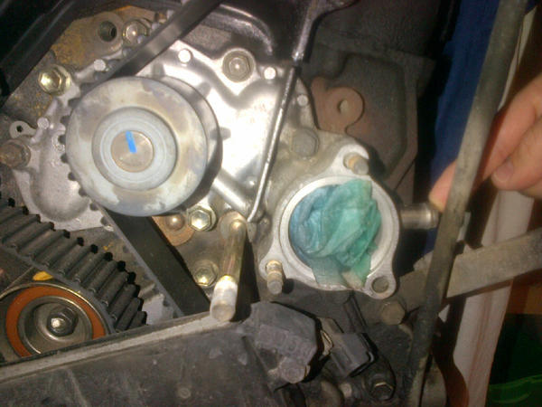

I used the Aisin kit from RockAuto. Looks like the pic of the Aisin box above. Great kit, no problems. As to the comments of the WP, the WP must have a small coolant outlet on the right side (thermostat side).

A carbide in a rotary tool would eliminate the burrs if anyone would ever be concerned about them.
Heck, even a file will knock them down without much work.
