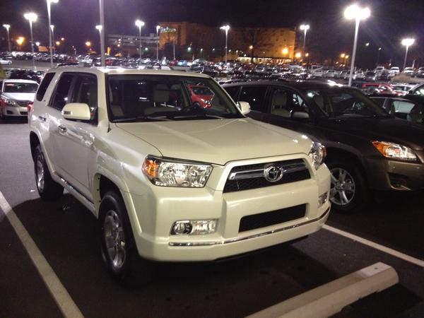

On February 25, 2013 I bought my 5th gen 4runner, because the dealership offered me such a deal that I could not resist. Sticker price was $39450 and took it for $34850 out the door. Thank you Dave, now I can enjoy my 2013 Sr5 with leather and nav.
The day i bought my truck

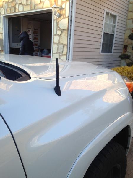

Second mod I did is change the long antenna that nobody likes on 5th gen. Thank [MENTION=6163]phillyd2[/MENTION] for providing link on his build thread and trying out stubby antenna first which did not work as well as this Z4 antenna.

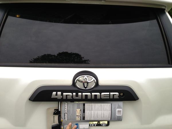

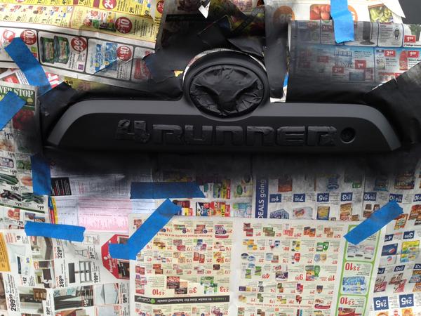

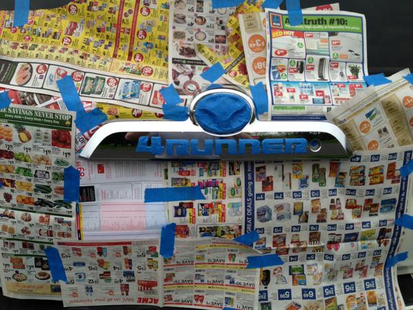

Third mod I try to do, was blacking out 4runner rear chrome hatch.
Anyone is doing this mod, make sure you cover as much of the truck as possible, I learned the hard way.
Final look

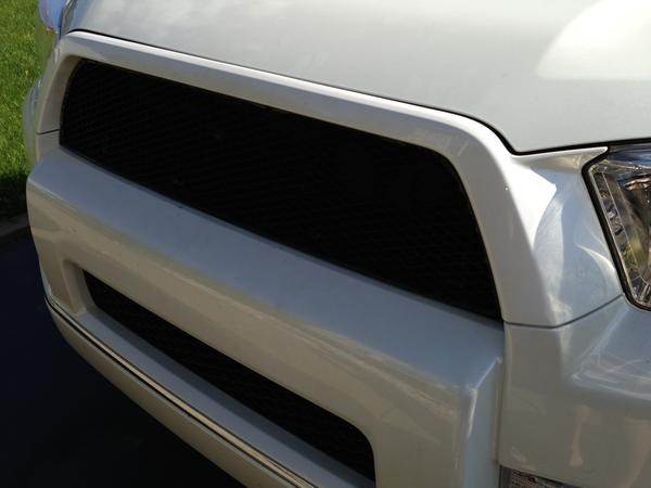

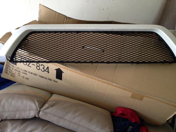

Fourth mod I did was trying to make satoshi grill. I think I looked a thousand times and read DIY multiple times before attempting this mod. I bought spare grill, just incase I would mess up. Thanks to [MENTION=78705]jangoforhire[/MENTION]. [MENTION=48772]Jesse1983[/MENTION] and [MENTION=50186]adio3x[/MENTION] for all suggestion and help how to make this mod easier.
Cutting and fitting the spare grill.
Finish Satoshi
On the truck
Taking the top part of the grill is one big PIA, especially if you have big hands, I think I broke some clips off when trying to take it off.

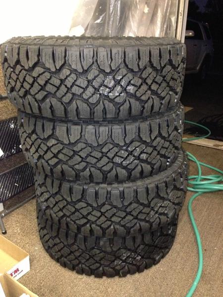

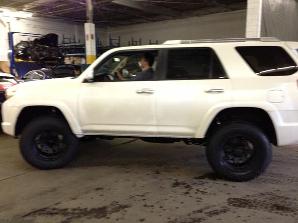

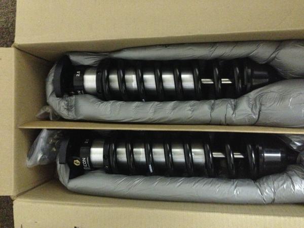

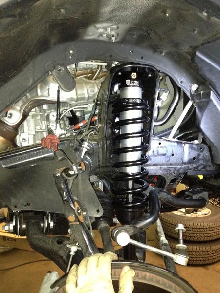

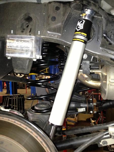

Ok I did small mods here and there, but it was time for some serious mods now and especially after seeing [MENTION=6163]phillyd2[/MENTION] truck, I knew i needed a real suspension and some good set of tires and wheels. After many pms and conversation with [MENTION=68685]Ducmonsta[/MENTION], [MENTION=8206]harper7[/MENTION] and [MENTION=76166]Qjake[/MENTION]. I order suspension kit, which included Icon extended front coilovers, and Metal Tech rear long travel kit with extended coils springs, extended brake lines and 3" bump stops. I order set of 18" Ultra Gauntlets wheels and 295/65/18 Duratracts tires, thanks Billy for doing it first and proving that it fits. Thank you guys for helping me choose an awesome suspension kit.
The day that holiday came on the regular day
$34850 is a crazy good deal on a SR5 with Premium package! Congrats on your new 4nr!
Did you use plasti-dip on the rear emblem? Was it hard masking between the edge of the pastic chrome area and the paint?
Install time

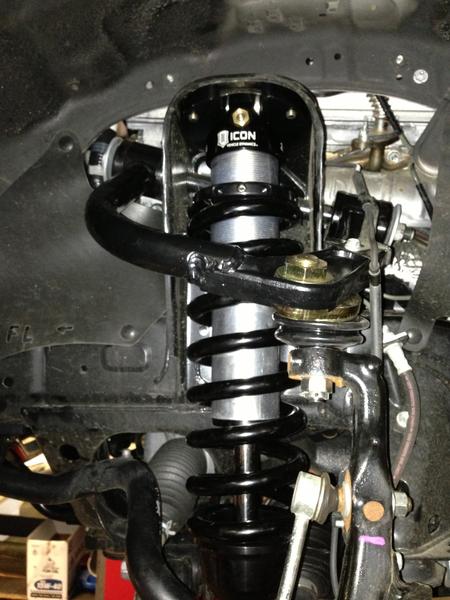

Again thanks to everyone who did it prior. Especially thanks to [MENTION=8206]harper7[/MENTION] for writing up on how to do the alignment the proper way and setting caster. I took my truck to the mechanics that i have been going for 10 years, but they specialize more in fixing cars then modifying, but they like to learn and i trust them so here is install pics
Front right side
Front left side
Rear right side

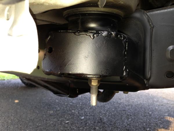

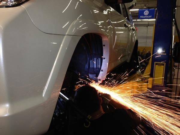

I knew with going to 33" tires i would have to make some modification in front wheel well and cut the body mount.
Body mount chop done.
Finish product:

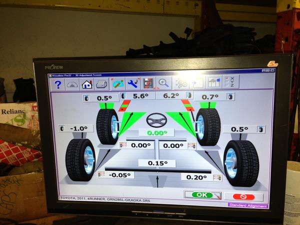

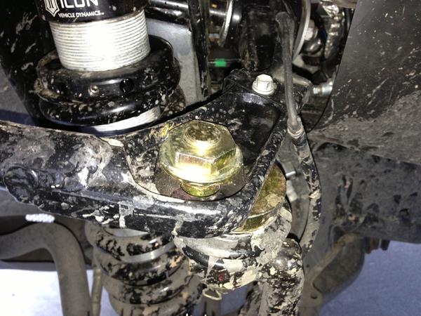

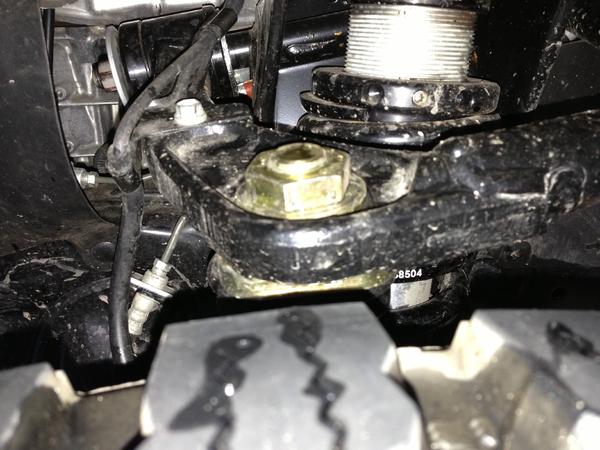

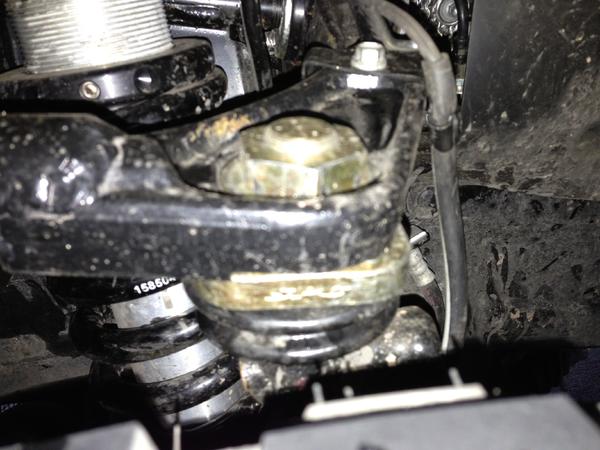

I though it was finish, but not. When i went to install the lift, tires and get alignment. I gave my mechanics the specs of Billy (Qjake) specs and they adjust the ball joint that it was sticking out in the back pass the Upper Control Arm:
Front Left side
I got a high caster. Here is the pic.
The truck drove perfectly, i just had slight rubbing in the back of the wheel well when at full lock going in reverse.
I went wheeling with couple of the guys and Billy told me that i had my bolt joint place wrong. I took the truck back for alignment and that where they had difficulties getting caster +4, so at that time I called Bobby [MENTION=68685]Ducmonsta[/MENTION] and i was amazed by his customer service skills, he stayed with me on the phone and looked at pictures to try to figure out what was wrong and how to fix it. My mechanics did not adjust the lower control arm, that why the bolt joint was so out to get this high caster. After talking to Bobby, they adjusted the lower control arms and place the ball joint as it specify on instruction from SPC, to set it to position D. We finally got caster to 4.3 on the left and 4.0 on the right. Thanks Bobby for all your help.

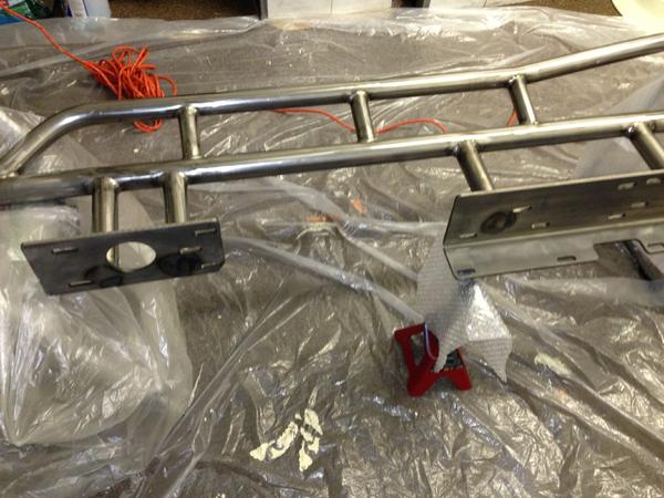

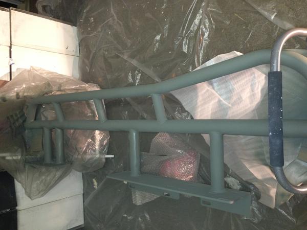

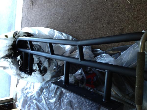

So in between of installation of suspension and going wheeling, i knew i needed HiLift because i gained about 3" of lift, but i had no points in the truck where i could use HiLift, so i order BudBuilt slider (regular, bump out, non powder).
Sliders arrived within 11 days of order date.
Then i decide to tackle another project because i read many threads on how to powder coated the sliders
Prep for primer:
Sprayed with Primer
Painted with Rusteoleum truck bedliner
I think i will apply couple more coats of bedliner and then install them.
Thanks, no i used Rusteolium spray paint. It is not hard to mask between the rear hatch and the body, because there is a thin space between and i stick the newspaper in between, just make sure you stick it far enough. The hardest part was to mask of letters.

Your Ball Joints on the UCAs are installed backwards. The SPC logo should be facing outwards.
Seems to be happening a lot these days.
+1. Whoever did the install and alignment owes you a proper installation and new alignment. The SPC instructions are pretty clear, and they got it completely wrong.
Mikey, which pictures you were referring too, because at first my bolt joint was sticking out in the back, now they fix it and now SPC logo looks at tires. For some reason forum is not letting to show all of my pictures.
P.S. I think the pictures of ball joints is when they were wrong, they fixed it. I have to post correct ones. Thanks for help.
