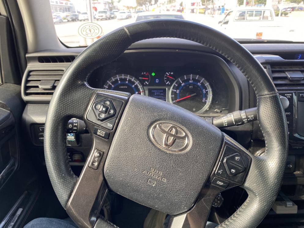

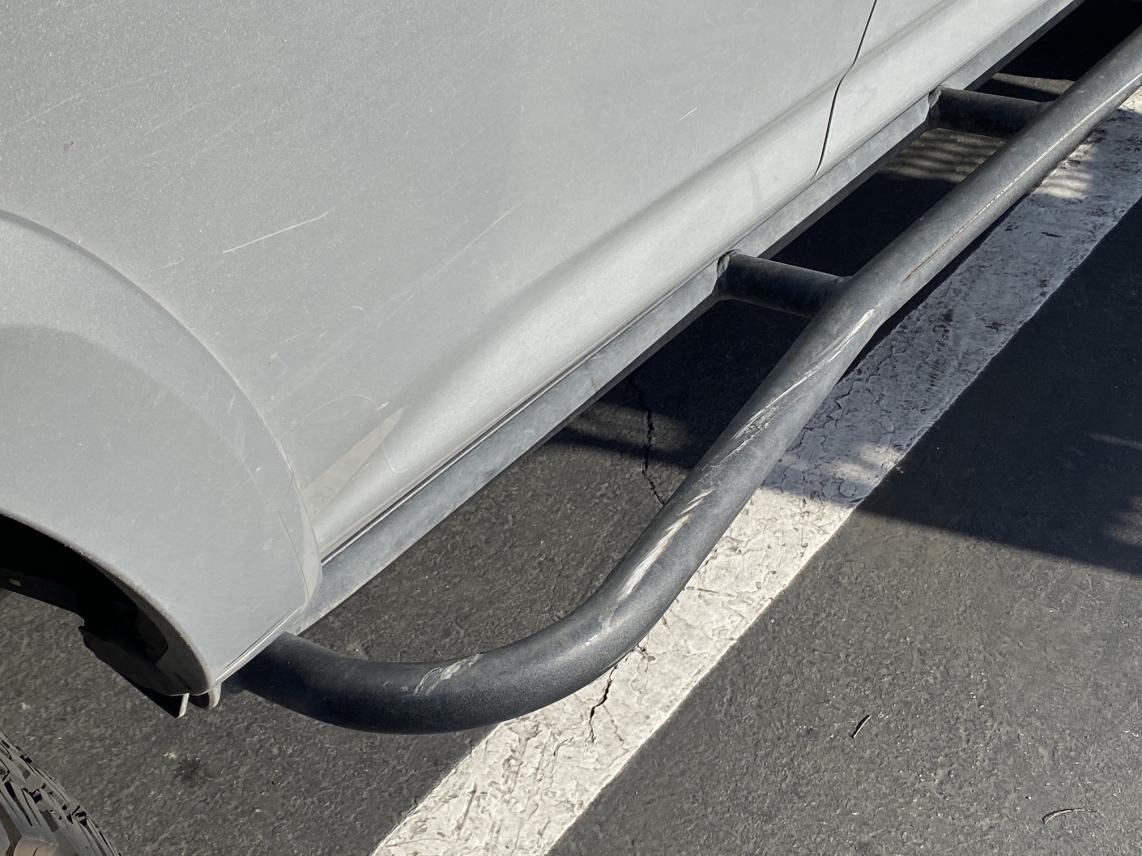

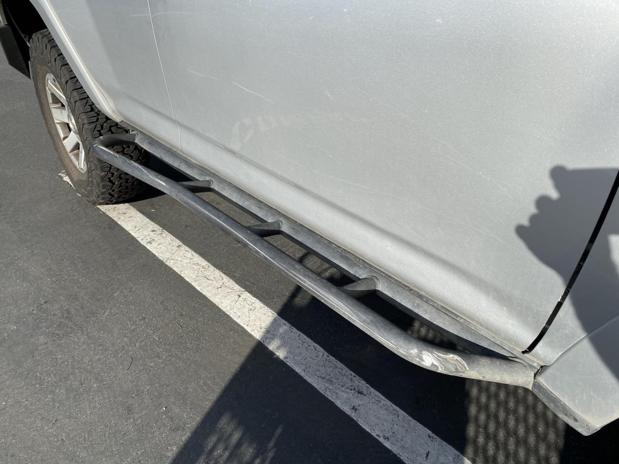

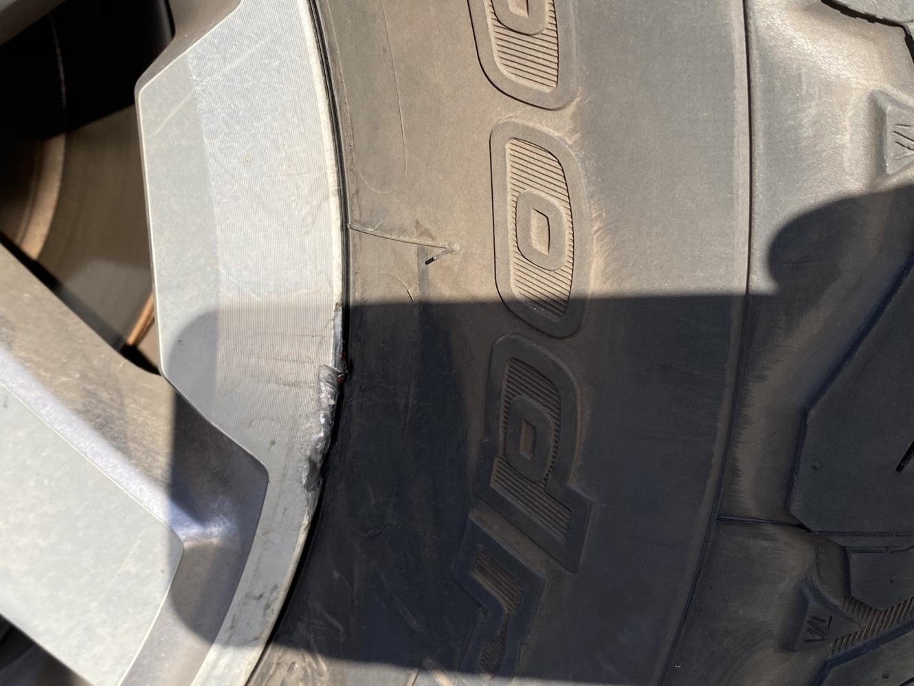

Some weeks back, I was parked near my house on a one way street and I'm guessing some sort of high riding truck or something did a poor job of navigating down the narrow block and scraped past my rig. Fortunately there was no body damage, just a scratch along the top of my slider and small nick on the rear passenger side rim -- see pics. Didn't even puncture the tire. If not for the scratch on the slider, I'd not even noticed. A day later I'm driving and notice that my steering wheel is out of alignment. The car drives straight, but sits about 20 degrees high on the left from horizontal. (See pics for angle of steering wheel when car is driving straight.)
I took it a tire shop, thinking it just needed an alignment -- but when he got it on the rack and they did their diagnostic -- turns out the wheel that got knicked is 2 degrees off from straight. Took the tire off to make sure it was fine -- checked it, no problem. Have a full size spare, put that on for good measure, and still 2 degrees off. Again, the car drives straight, albeit with the steering wheel slight off. Everything else about the ride of the rig is fine.

I was with the guy when he did inspection. The guy was actually pretty awesome. He measured everything on both sides and we examined tire rods, axle, anything that came to mind and it all looked proper and accounted correctly. He didn't know exact specs for the 4runner, but compared to driver side, nothing was off. He said maybe something inside the axle -- clearly it was beyond his field of expertise, which I appreciated him not postulating without knowledge.
As for the wheel -- he offered to straighten it, but suggested I might want to keep it at the angle to show whoever might be able to fix it what was off. He also said something about the possibility that straightening the string wheel, i.e. front end, would cause more wonky tire wear in rear than leaving it as such. And since the car was driving straight, he wasn't sure it would be prudent.

Well. it SEEMS that something happened. I would start with having someone follow you and watch the p/s rear wheel and see if any wobble at all. If there is then possible bent axle shaft.
Why steering wheel is cocked is the other mystery. I would inspect frame area where sliders bolt to especially at point of initial impact, up front, is frame dimpled, pushed in at all? If not, keep looking, something happened.

Hello all -- thanks for the suggestions. After taking to a few places -- the consensus is that I need to replace the rear axle. There's a -2 degree toe angle on the rear passenger wheel.
