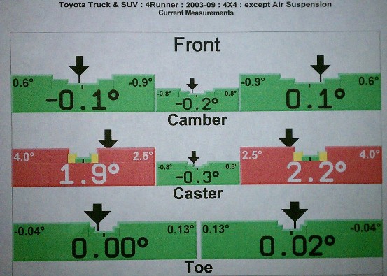

Just installed the Daystar 2.5/1.5 and had the dealership perform the alignment ($80).
Service tech advised my individual wheel "caster" measurements were slightly off, but in the end equalled out within specification. Tech said it shouldn't affect the performance and/or tire wear and tear. But, if I wanted to correct that problem I would need to replace both LCAs.
Anyone else have this issue? Is it a real issue? Any advice?

After i installed my daystar 2.5/1.5 my it took me more than an hour of canstant adjustment to get it close to spec. (As a tech at a dealer i could spend as much time as i needed to get it right.) My camber ended at a perfect zero and the caster was at 2.4, just inside the tolerance. Thats as close as it gets with that lift. As long as the caster numbers are even you wont have a pull. The only way to get closer is to replace the upper control arm with an adjustable one.

My 08 has practicialy the same alignment numbers as you. Like others said, as long as the Caster Numbers are close to each other, you should not have an issue with pull or wear. I've had my DS 2.5/1.5 for 1.5 years now with no issues or increased tire wear.
They are correct that as long as caster is nearly equal side to side, it won't cause wear problems or anything. However, it does affect steering feel -- I change the caster fairly often on my track car to take advantage of this effect differently depending on the need. I personally like running near the top of the factory range whenever possible though, not the bottom.
Having lower than recommend caster is one thing which can lead to that "floaty" feel in the steering, with less strength in its return-to-center tendencies. Higher caster (in most suspension setups) typically also means more dynamic camber when turning, which on the front obviously is good to have.

They didnt do an alignment, they did a toe-in. All they adjusted is the toe. It is a fairly tedious task to adjust the camber/caster since the use they same set of eccentrics on the LCAs. I would go back and get your money back, then go somewhere else with a less lazy tech. These guy clearly dont want to work or worse, dont know how to and to continue having them work on your 4runner for another 3 years would not be a good idea. Preferably go to a dealer with more experience. They will be able to get your caster in the 2.3-2.5 range, camber at -0.1, and toe at 0.03-0.05. Be sure the total camber and caster values are 0.0-0.1 to keep from having a pull or uneven wear. Anything outside of those numbers should not be accepted.
