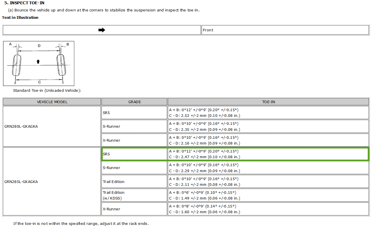

Finally, I ended up talking to a service manager. He brought his https://tis.toyota.com and tried to find the alignment info for TRD PRO. :-) Well.. it doesn't exist. The closest document he was able to obtain was the one called "ALIGNMENT / HANDLING DIAGNOSIS... " (Doc ID: RM000001V4302OX). This document has specs for xx -2016 4Runners, except TRD PRO.
At this point I asked the main question "Without the specs available, how would your service department properly align wheels on my brand new 2016 TRD PRO if I bring it tomorrow? Is it going to be just an educated guess?"
I have to give this guy a credit that he took my question seriously (he was the only person who at least tried to help me) and told that may be there are specs in a Hunter alignment machine that they have downstairs. We went there together and checked the available specs for 4Runners. Their Hunter machine had all 2011-2015 4Runner alignment specs, but not the one for TRD PRO. There was a strange option called "2011-15: 4x4: X-Runner", but I don't believe it is our TRD PRO, as there was no TRD PRO in 2011.
So, I guess the dealership do not have updated numbers yet (or just do not want to pay the database update charges to Hunter, since TRD PRO is very very very little % of their alignment business).

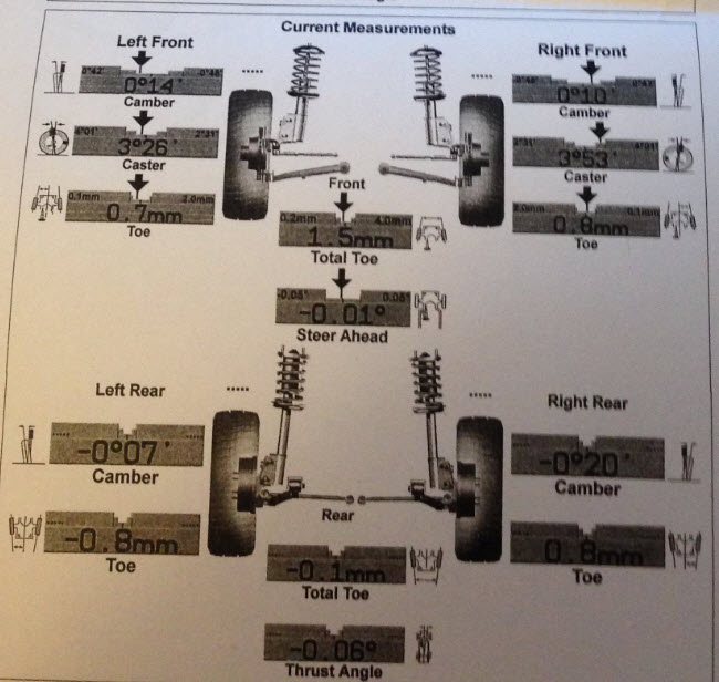

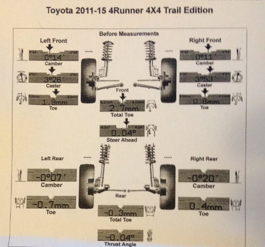

Just in case I obtained the numbers for "2011-15: 4x4: Trail Edition" and that mysterious ""2011-15: 4x4: X-Runner". They ARE different. But that still doesn't answer the question of "What are the proper alignment specs for our TRD PRO machine".
Basically I am back to square one. Frustrated, as I have scheduled an appointment at local alignment shop that told me in advance that they do not have TRD PRO specs, but will do alignment if I get the specs from Toyota (honest people).

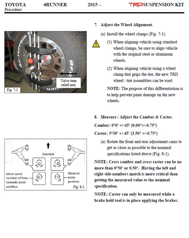

But what I did find on TIS that may be of use to you is specifications relating to the TRD Pro in the form of the suspension kit.
View attachment T-AI-0956-D.pdf
The above file is the installation instructions for the 2015 4Runner TRD Suspension Kit PTR13-89150 Rev. C, it's the same suspension installed on the TRD Pro. At the end of the instructions are specifications for Camber and Caster for the new kit.

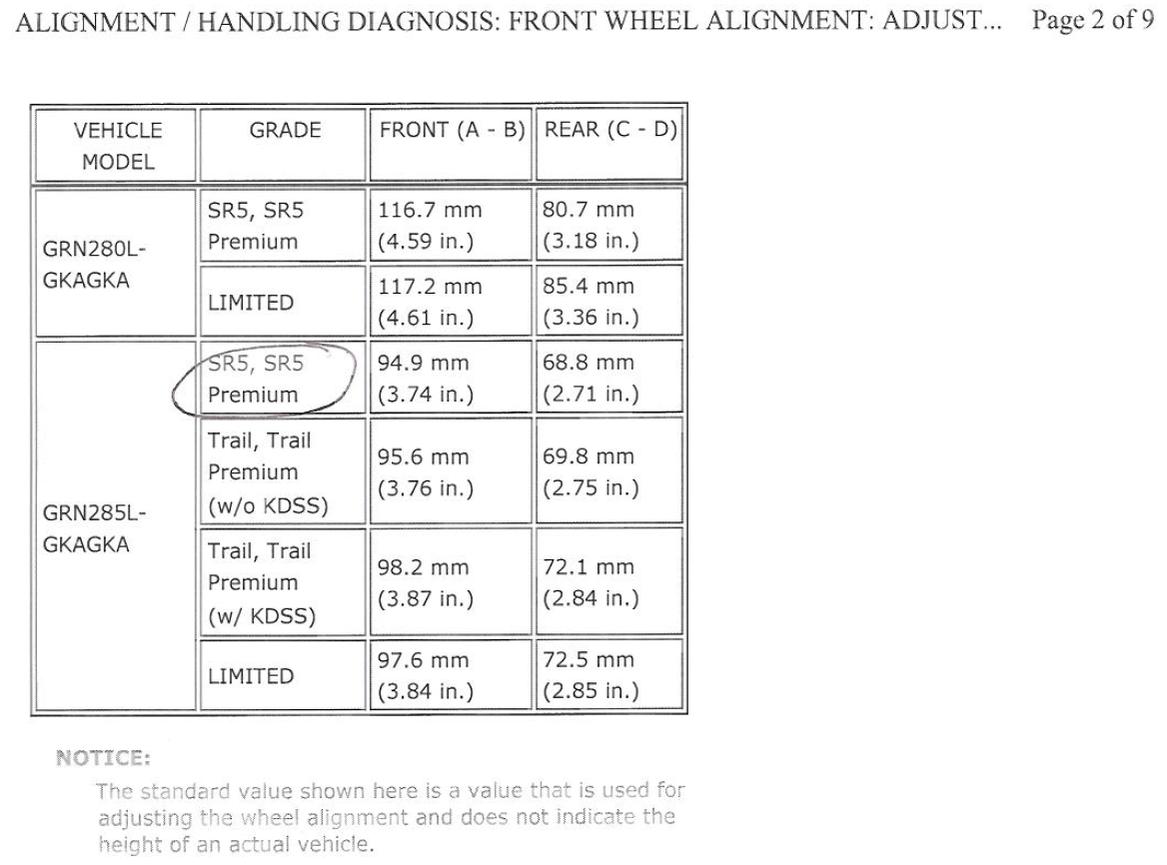

Mr. Percy Chan, sent me e-mail with the screen shots that I attached below. He circled with a pen and highlighted in green the relevant pieces which supposed to convince me that he found the right information for me. Two of these screen shots not even saying “TRD PRO”, but “SR5” instead! :noidea: And these screen shots are not even a part of the same document. :frusty: They are from 2 different Toyota documents/sources. I know this because I have hard copies of these documents from last year when I started my own research. Mr. Chan told me that 4Runner TRD Pro is basically an SR5 and that I should use the SR5 information to align my wheels. That just doesn't sound right. I can't trust this information.

Here are the two documents that Mr. Chan took the three screen shots from:
#1: "2015 4Runner TRD Suspension Kit PTR13-89150"
The .PDF version of that document was posted to this thread earlier. The latest version that BlackWorksInc (huge thank you, Sir!) found is dated by 10/30/2014 and marked as "issue C." That "issue C" has Camber and Caster data for TRD PRO, but Toe and SAI numbers are missing.
#2: "Alignment / Handling diagnosis: Front wheel alignment..." document.
I have only hard copy of this document, but the person who printed it for me in December 2015 obtained it from https://tis.toyota.com. The document ID is RM000001V4302ox.
My printed version marked as version from 8/3/2015. This version has Casper, Caster, Toe, SAI for all 4Runners (SR5, Trail, Limited), but there is nothing there for TRD Pro.
TRD Pro not even listed in this document.
As soon as I find and compare my existing copies (the ones that do not have full specs) with the updated versions (again... if they only exist), I may find a piece of mind. But for now I am not convinced.
If any of you have access to an updated versions of the above two documents, I would really appreciate you sharing it with me. Believe or not, but I still didn't drive my new 4Runner except the time when 8 weeks ago, I brought it back from the remote dealer. I parked it until I know what spec exactly I need to adjust the alignment to. I still have my old car and it helps now.

At this point I am really "impressed" on how dysfunctional Toyota support is. I am sending a letter to Toyota of Japan. Let’s see if those guys can help me.
  • 4runner pro alignment specs.pdf
  • 12-21-2015 - Doc ID RM000001V4302oX.pdf

If you have 2016 Trail or Trail Premium - you are in luck. The wheel alignment information IS available for your car. Dealers have Trail/Trail Premium profile in their alignemnt machine. The alignment numbers are known. Should not be a problem. Good luck!

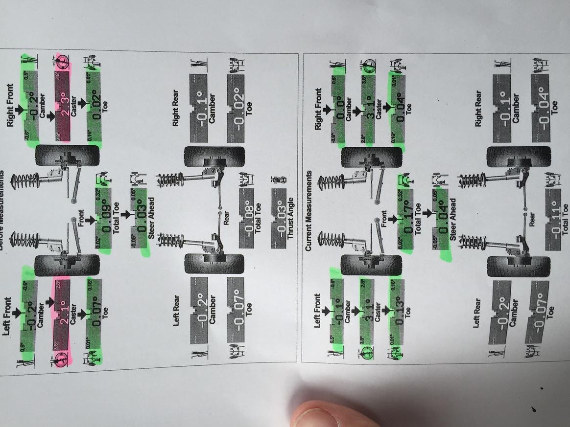

Did you ever get your alignment issues resolved? I bought my TRD PRO in July and have had 4 alignments, 3 by toyota and 1 by a local shop and I am still having issues with the truck pulling to the right and constant wandering.
Here is the last alignment done by toyota. Is the rear camber concerning?
Was your steering wheel off center?
