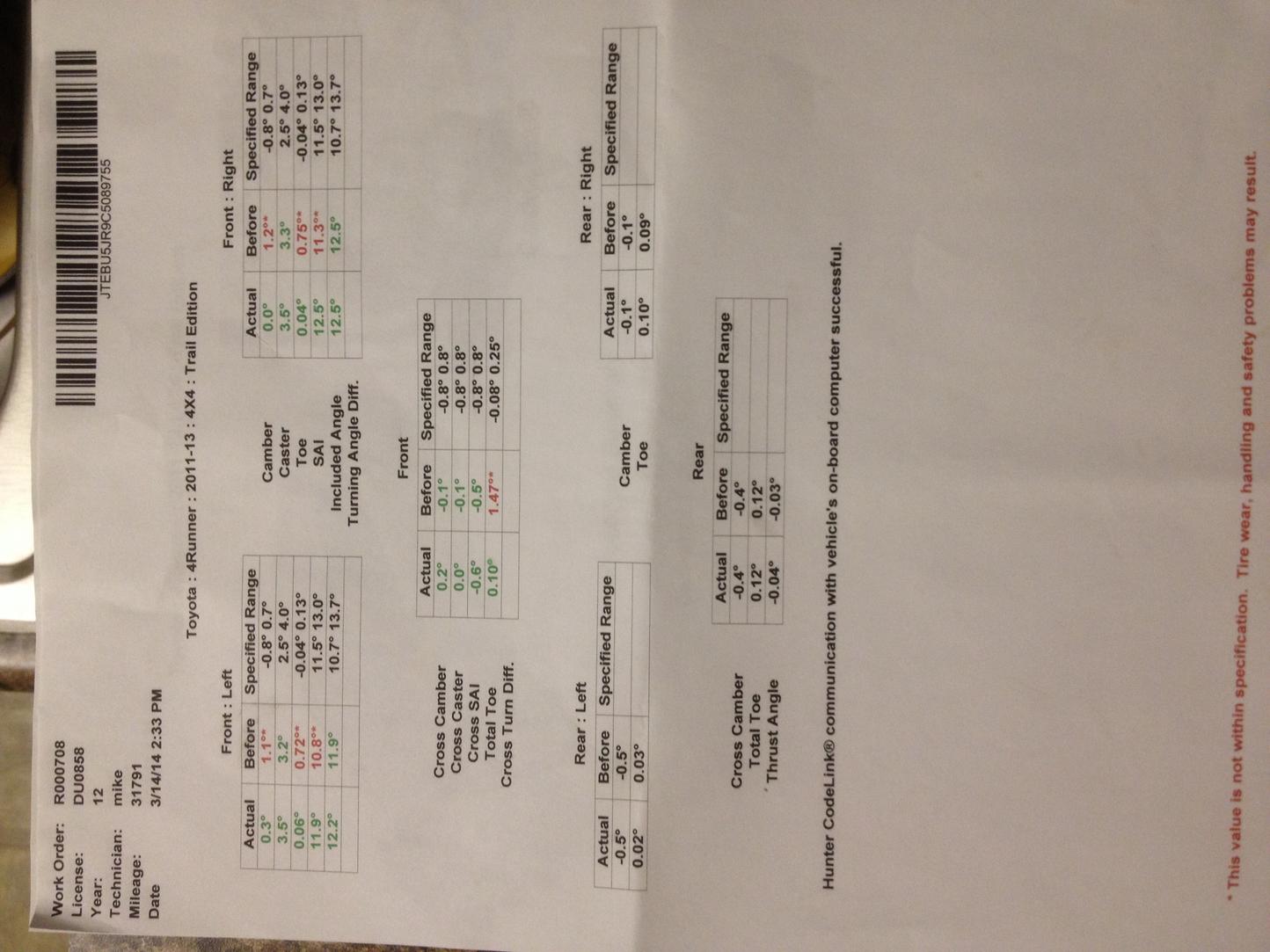

This is the specs from the alignment after my truck was lifted. Do you guys have any recommendations for fine tuning the alignment? I will be headed out West from Tennessee within the next month and wanted to get it checked and done prior to the trip. Thanks

I think it looks pretty good. If you were really nit-picky, you could see if they could adjust the driver side camber to match the passenger side and try to get the caster closer to 4°.
How does it drive? Are the springs brand new? New springs will settle a bit so another alignment may be required down the road.
285 Duratrac...
Caster should be 3.5 on both sides.
Camber should be 0 on both sides.
Toe should be between 0.02 and 0.04 on both sides. I'd say more towards 0.04.
Key is to check your front tires. Rub your hands across the tread...If you notice anything other than flat even wear, adjust accordingly.
As with anything, use your best judgement. This is my opinion and is just a base line.
