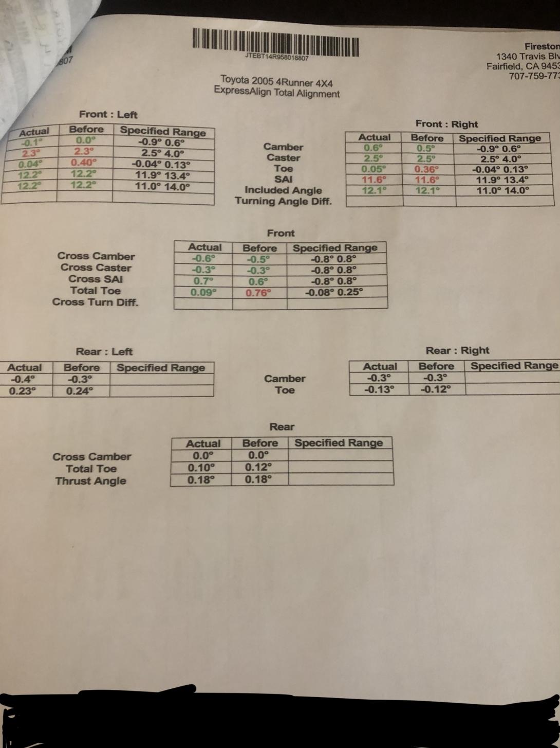

Having rapid wear on outside edge of front passenger side tire, it’s bothering me a lot cus I just got these tires. Anybody have any suggestions? Here’s my alignment readings.
I also do get a squeak noise on that same side not sure if the squeak is related or not but it has appeared since I added my 3” lift recently. Is there any parts that can be worn I should look into, ball joint, wheel bearing assembly? Is anything like that associated with such wear? It’s only on one side specifically that tire only.

I don't see any attachments. Sounds like an alignment issue.
Had the same issue, found out it was my LCA was worn out. installed new LCA and it fixed the alignment issue and squeak.
I recommend replacing the sway bar bushings and end links, if you haven't already or if you still have them on.
Also, ask the shop when the last time the alignment machine was last calibrated.
Here is the alignment paperwork. I still noticed rapid tire wear after this was done.
