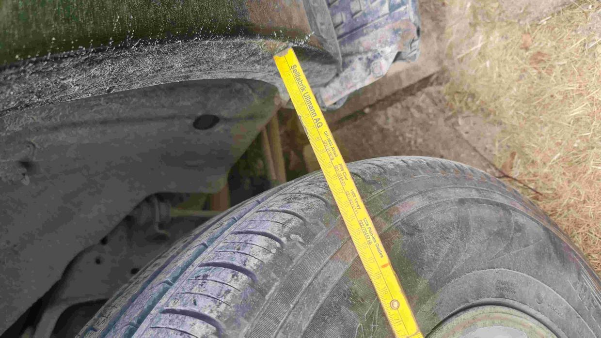

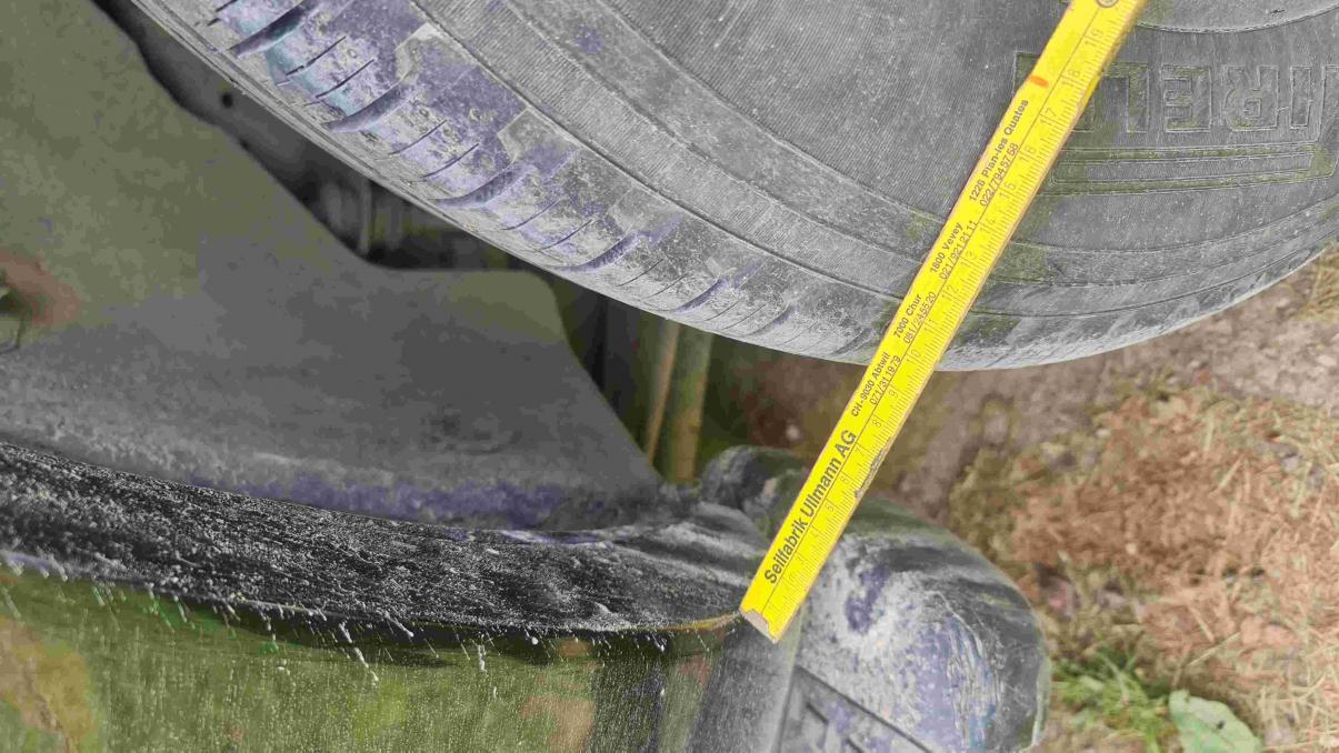

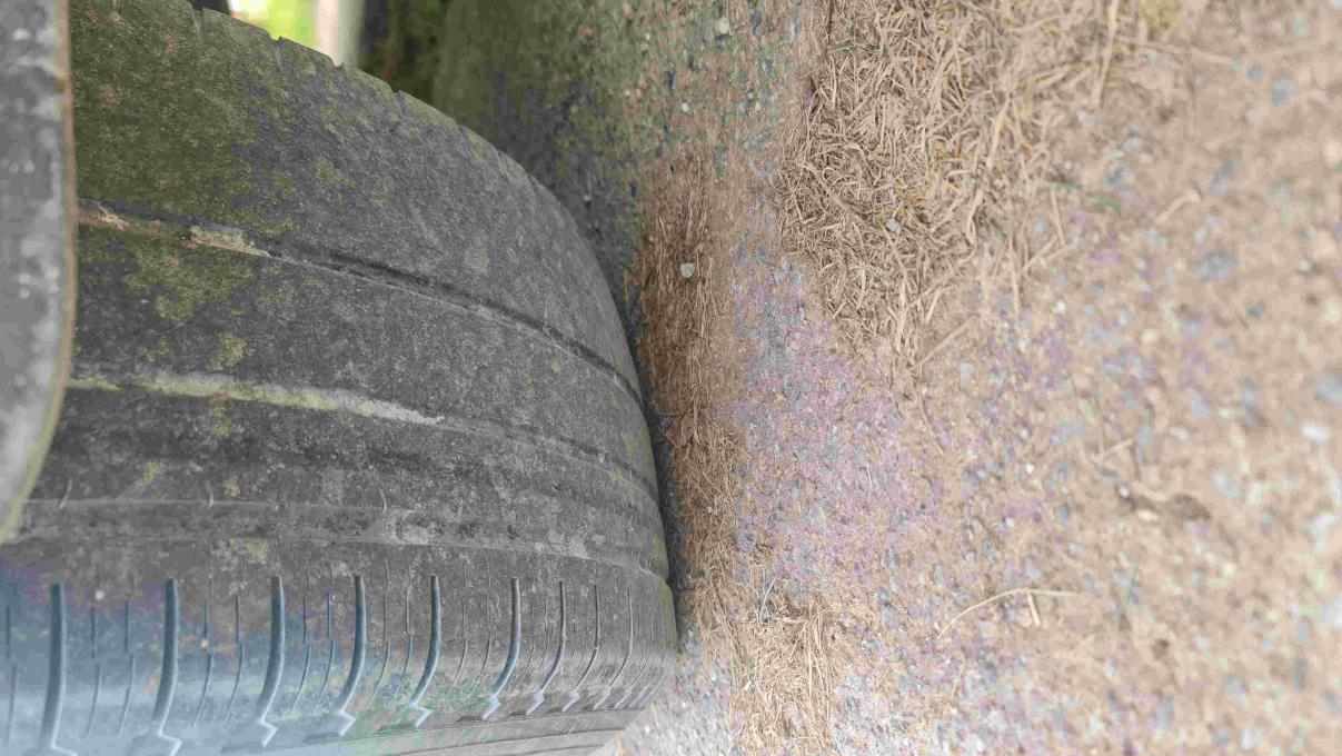

Attached some pics of the uneven tire wear, both sides are affected. It seems that (at least on one side) the wheel is off. The distance to the fender is different on the two sides.
The easiest solution would be to find another model which uses the same axle. Will check HILUX and PRADO. Import to Europe from the U.S. is a p.i.t.a. and excessively expensive.

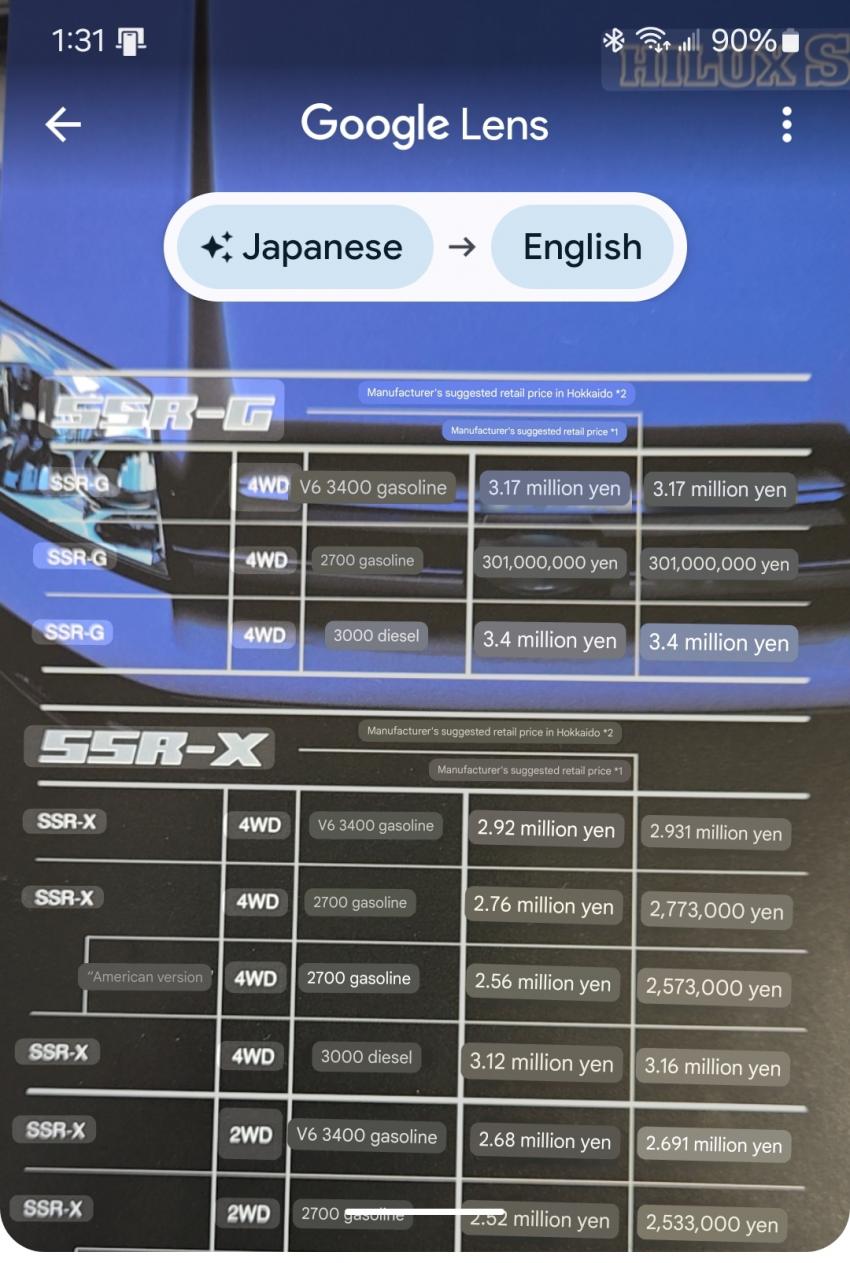

I have the interior options catalog too. Among all the various color light replacements and seat options there's a step that is at the rear bumper. I would assume it's for the 3rd row seat.
