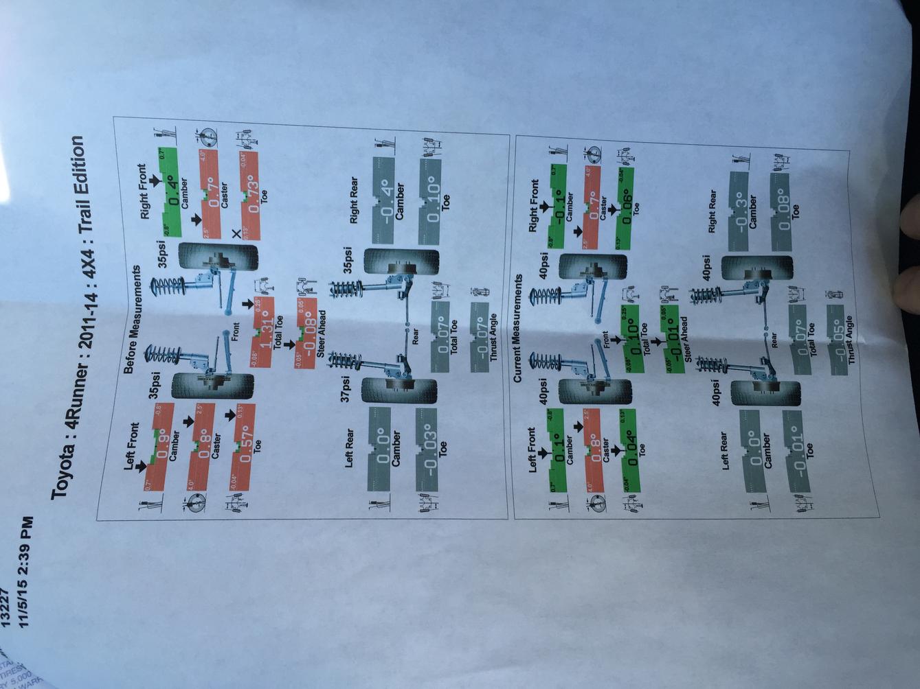

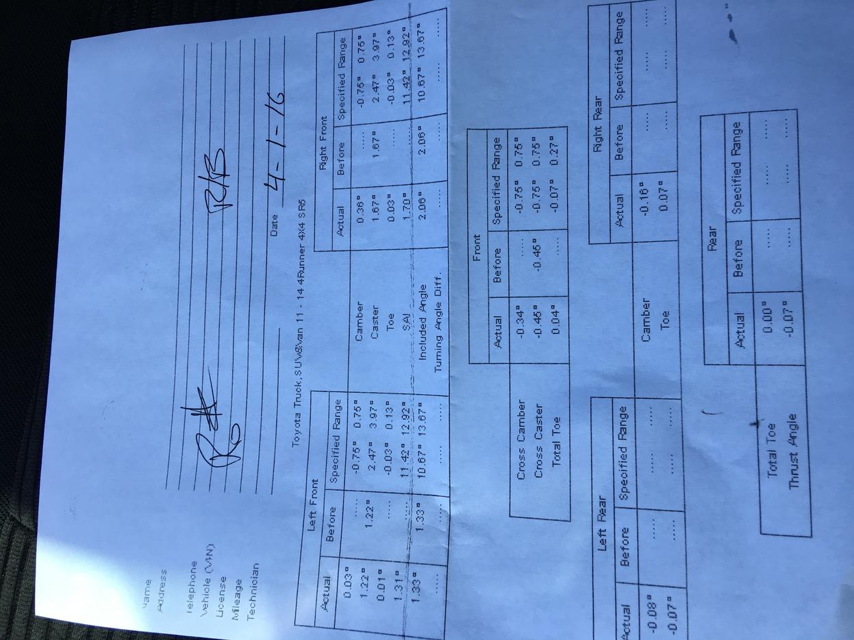

Got my lift set at 2.5/2 icon stage 1 on oem sz tires and a buddy saw my specs and recommended I get realigned. Anyone have any comments/concerns on my current specs? I don't feel any major pull. Just wondering if it's worth the realign prior to the recommended realignment after x amount of miles.
Assuming you dont have UCA's, it looks really good. Camber and toe are about perfect. You can try to push the caster farther but that might be all you have.
That's about how mine looked after my first alignment. I was happy with it because the wearing angles (camber, toe) were fine. The second alignment got my caster back to about 2.5 degrees. Regardless, I'm still getting UCA's but this bought me a bit of time and I'm happy with it.

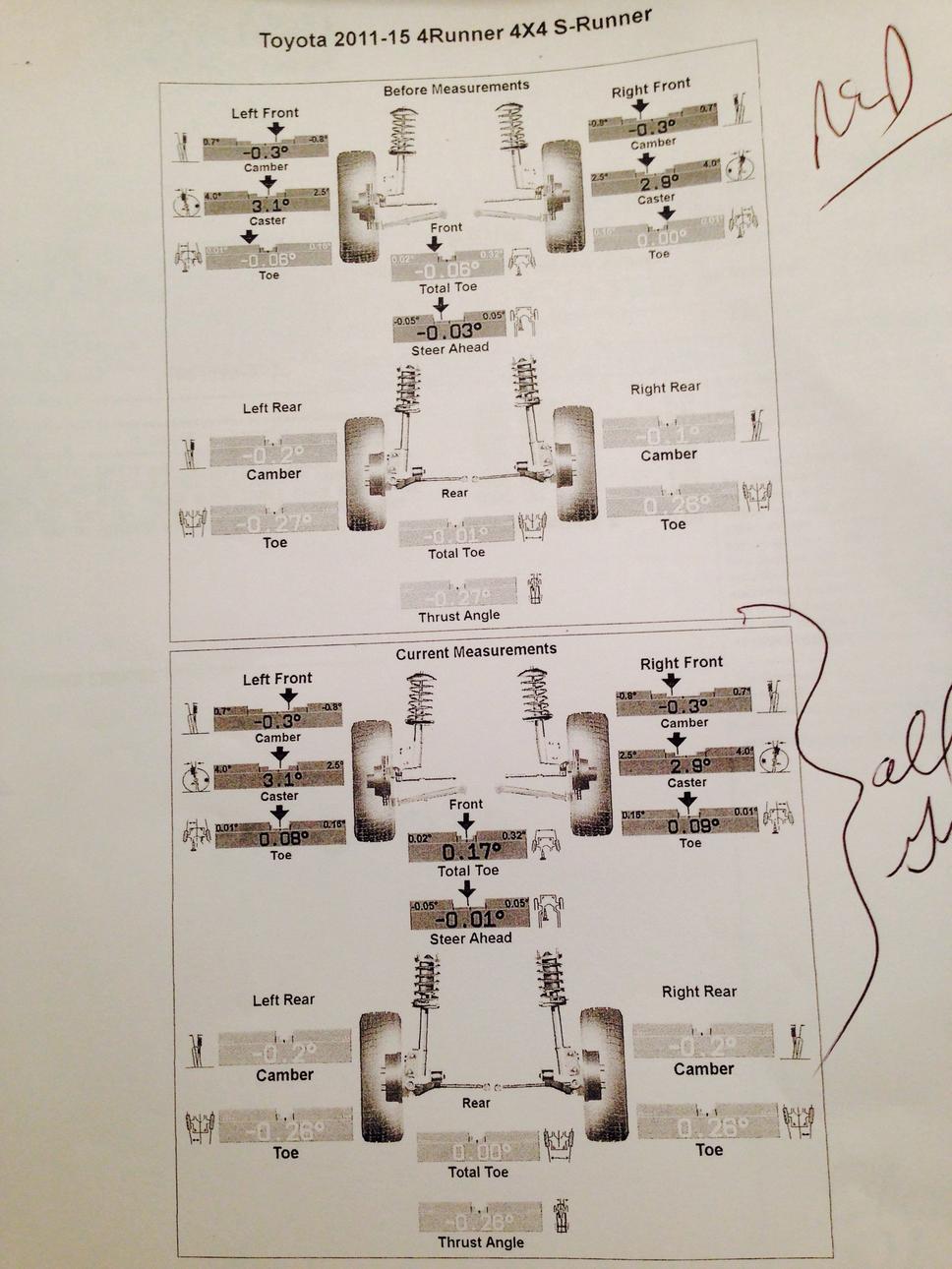

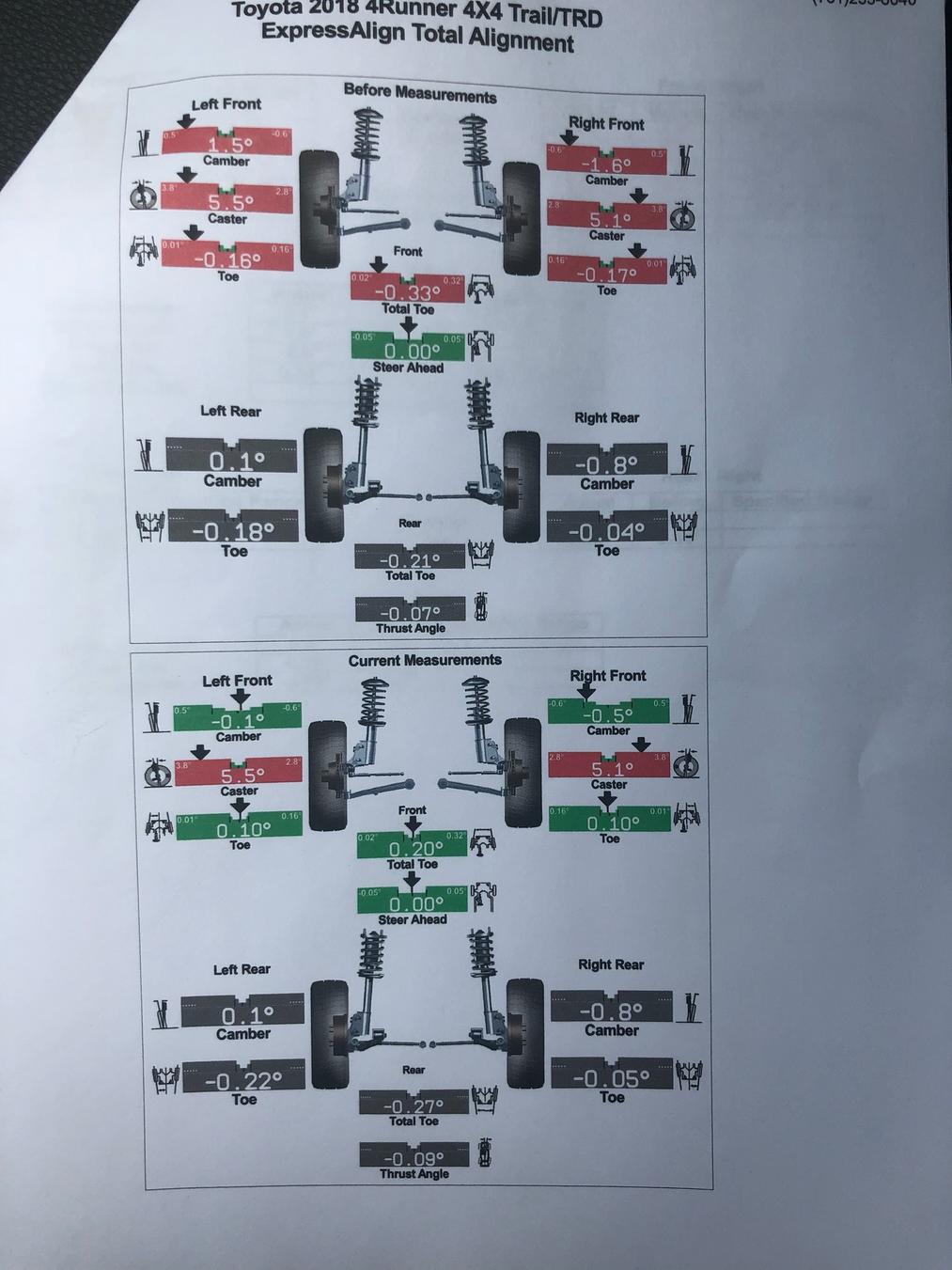

My prelift specs, had it re-aligned at dealer for free a few days back. Get 5100 fronts set @ 1.75 installed tomorrow.
Once again, I got an alignment due to some tracking issues. Anybody see anything wrong? I'm in no position to determine the correctness of these specs. Would appreciate any feed back!
Any suggestions / thoughts on this alignment result

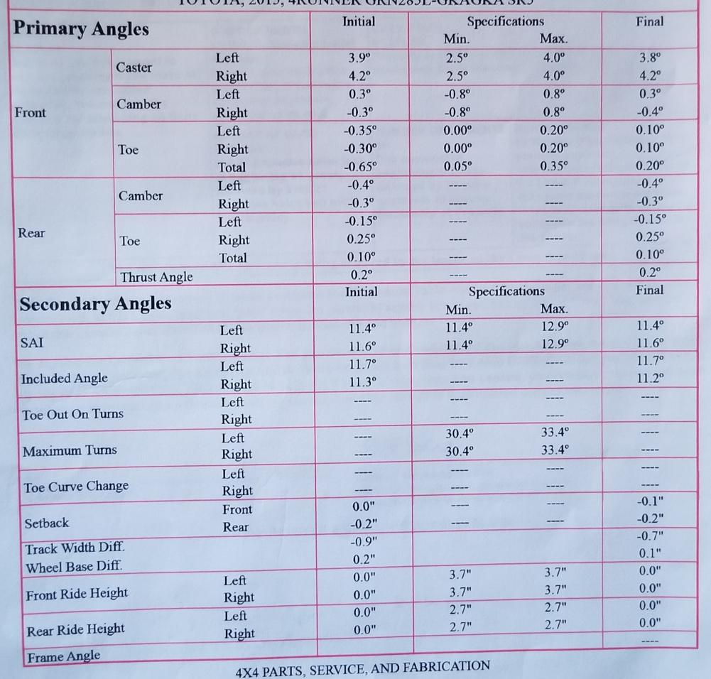

Thank you to anyone willing to provide feedback on this. Following my Lift, I brought this into my dealer, who said they could not adjust the Camber. I know little about all of this, so any thoughts suggestions are greatly appreciated.
3" Revtek lift.
Main question I would like answered is, based on this result (attached image), should I go to a different alignment shop, or are these results OK?
Again, thank you.

Do you have aftermarket upper control arms (UCAs) already?
If not, it's difficult to imagine how you're getting 5+ degrees of caster with a slight negative camber on a 3" lift. The amount of available positive caster and negative camber decrease as you lift the suspension higher. Aftermarket UCAs relocate the upper ball joint so that stock caster and camber specs are attainable with a suspension lift.
In any case, your camber and toe numbers look good, and there's nothing wrong with a high caster number if you like the way the truck drives. The need for aftermarket UCAs to restore caster is a matter of individual preference, whether it's a suspension vendor or a "keyboard expert" making the call.
Caster influences steering behavior near on-center. The more caster, the more the steering will want to self-center. Sure, Toyota provides specifications, but it's really up to you to decide how much is enough. Being out of spec on caster doesn't hurt anything; it can just make the truck unpleasant to drive. If you like the way it drives with 5+ degrees of caster, there's no reason to change it.

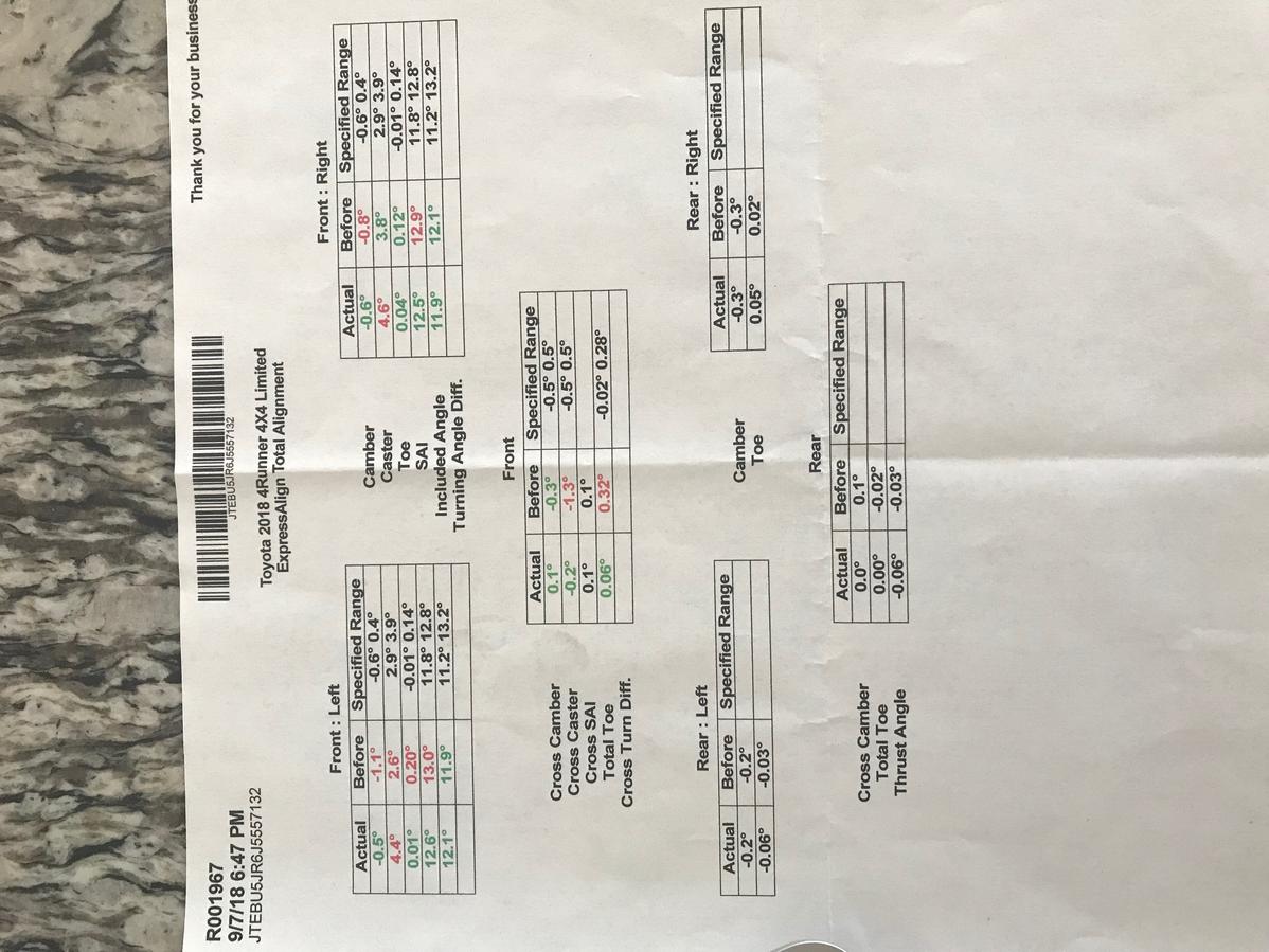

Got my 285/75r17 Falken AT3W's, Icon Delta Joint UCA's installed, & a bmc. They did my alignment & numbers seem OK, please tell me what you guys think. I swear I can visually see the bottom of the tires pointed inward more than the top & confirmed with a plumb line. For other info I have an OME 3"lift all around.
