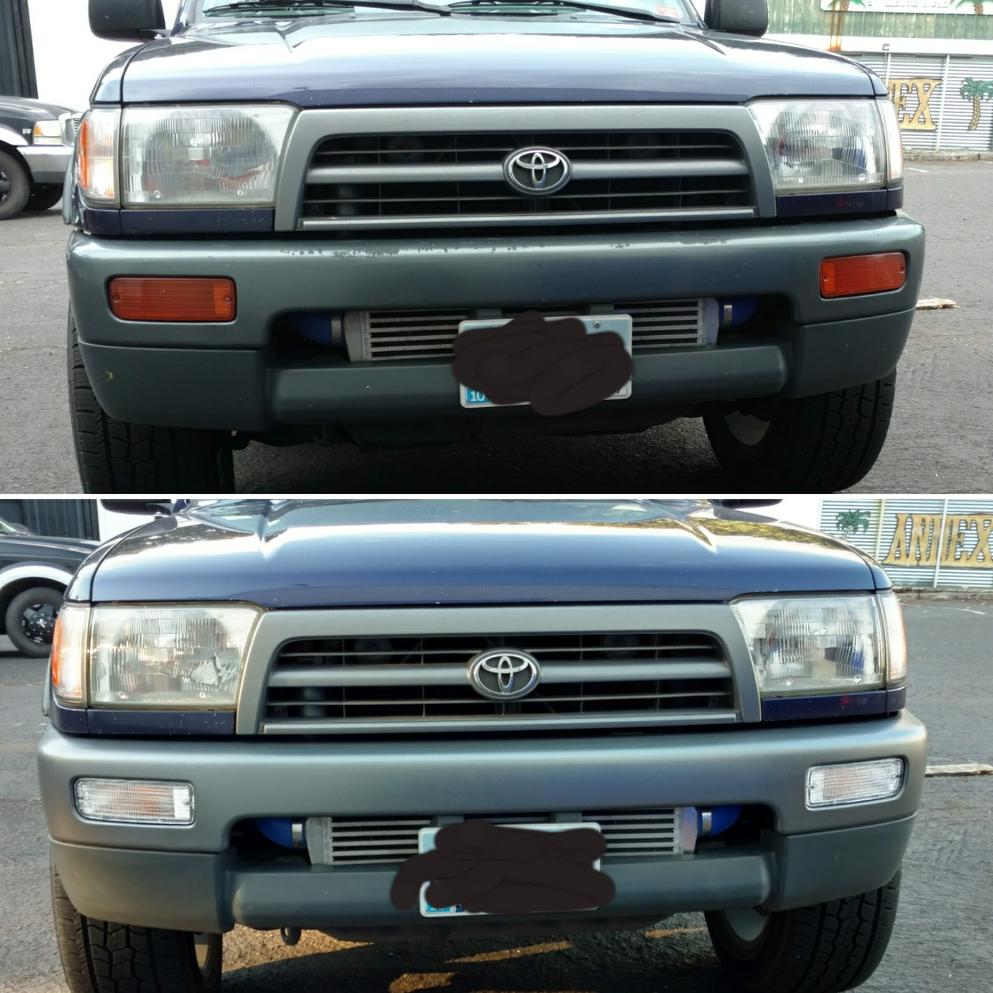

Just a little update. Installed the competition sprung 6-puck clutch and have been driving on it for a couple months now. Definitely more grab and a bit jerky from a stop when cold sometimes, but holding 7psi without slipping like the Marlin stock-ish setup did! Also painted the front bumper to clean it up a bit and installed my clear turn signal lenses. Here's a picture of before and after. She's running great still. Averaging about 16-17 mpg around town with AC blowing and over 19 mpg with about 60% hwy driving on a tank. Haven't done and straight highway to see what actual best case economy is yet. Thanks for the interest!
