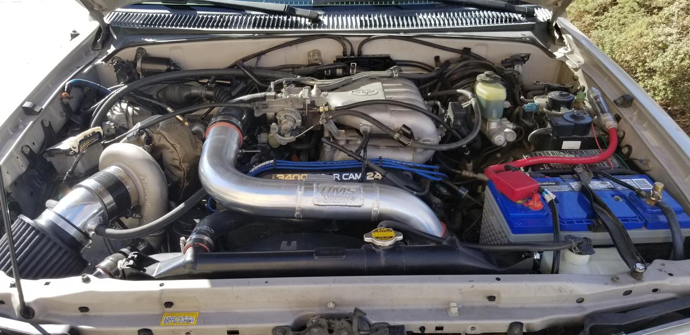

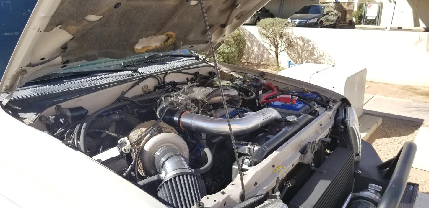

I've been getting a lot of questions on my build so I'm going to post here so I have a link for people to reference. Bear with me as I upload pictures of the next couple of days, I have them scattered between multiple laptops and cell phones. The vehicle at hand:
2000 Toyota 4Runner Limited
147k Miles
Lifted at 140k

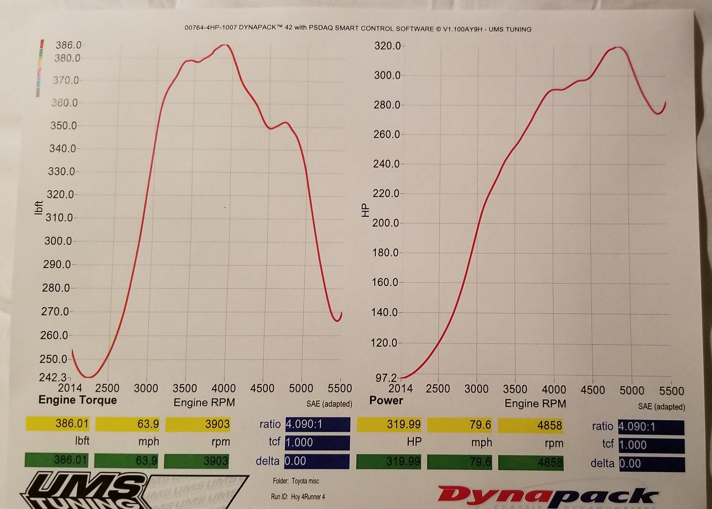

Boosted at 147k 320 WHP 386 lb ft Torque @ 12 PSI
Mods: Grey wire mod, satoshi grill, hot air intake :sleepy:
Just kidding... Grab a beer and a snack
Suspension:
Sonoran Steel SS 1.2 with Radflo 2.5 Resi Shocks - 1996-2002 - System 1.2 Rebuildable 2.5 / Ext. Reservoir - $2,568.00 : Sonoran Steel, Sonoran Steel Custom Metal Fabrication L.L.C. Custom Toyota Truck Parts
Total Chaos UCA's - TOTAL CHAOS FABRICATION - 1996-2002 4Runner 2WD & 4WD Upper Control Arm Suspension Kit

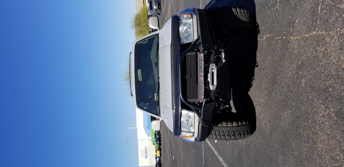

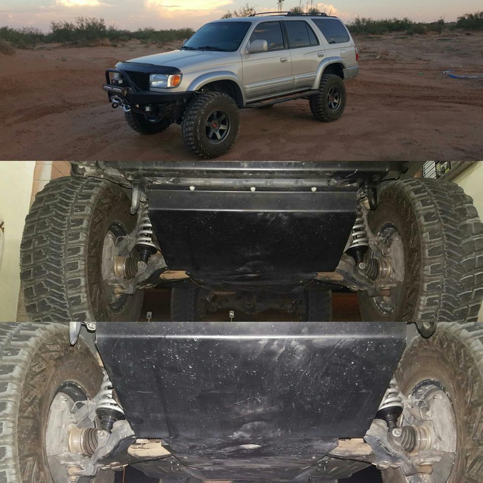

Armor:
Addicted Offroad Front Bumper - Plate Front Bumper 4Runner (1996-2002) [aor-plate(4runner 1996-2002)] - $875.70 : Addicted Offroad is a full service Parts, Sales, and Fabrication company offering offroad parts for all makes and models, Addicted Offroad
Rock Sliders custom built and plated by a friend
Full belly protection steel skid plates (except stock gas tank skid) - Bought second hand I don't recall the brand
Audio/Interior/Electronics:
Second Skin Damplifier Pro B Stock throughout most of the vehicle - Products - B STOCK - * MADE IN THE USA * - Damplifier Pro - Second Skin Audio
MLV (Mass Loaded Vinyl) over the top of Damplifier
Hybrid Audio Technologies Imagine 6.5" Components front - https://hybrid-audio.com/speakers/imagine/
Hybrid Audio Technologies Mirus 5.25" 2-ways in rear - https://hybrid-audio.com/speakers/mirus/
FI SSD 10" Subwoofer - SSD Series - SSD10 | Fi Car Audio
Pioneer DEH-80PRS Head Unit - https://www.pioneerelectronics.com/PUSA/Car/CD-Receivers/DEH-80PRS
Alpine PDX F6 4 Channel Amp - https://alpine-usa.com/product/view/pdx-f6/
Synergy Audio WFO 15.1D - Synergy Audio WFO 15.1D 2,000w RMS Mono Block - SSA STORE
KNU Conceptz Wiring through out - KnuKonceptz - Home and Mobile audio accessories, including amp installation kits and speaker wire
X2 Power 31M AGM Battery - https://www.batteriesplus.com/battery/marine-and-boat/deep-cycle/bci-group-31m/sli31agmdpm
Scan Gauge - https://www.scangauge.com/products/scangauge-ii/
Autometer Phantom II Transmission Temp Gauge - https://www.autometer.com/2-1-16-trans-temp-100-260-f-fse.html#Z52O9bSA2DH3gAVt.97
Autometer Phantom II Boost Gauge - https://www.autometer.com/2-1-16-boost-vac-30-in-hg-30-psi-fse.html#mGh3rUh2fhQP5gk4.97
AEM UEGO Wideband Gauge - Digital Wideband UEGO AFR Gauge | AEM
Cravenspeed Gauge Pods - https://www.cravenspeed.com/the-belmont/
AEM FIC - F/IC-6 | AEM
URD Patch Harness - https://www.urdusa.com/type-d-plug-n-play-harness/
CS144 Alternator Upgrade w/ PnP Harness
Engine/Transmission:
Engine - STOCK (stock head gaskets, head bolts, rod bolts etc)
CX Racing Manifolds, Crossover pipe, Downpipe, and Wastegate Dump Tube
CX Racing weld on MAF flange
Borg Warner S252SX-E (52/61) .68 T4 Exh Housing - https://agpturbo.com/borg-warner-s252-sx-e-52-61-12709095019/
Tial 38mm Wastegate - TiAL Sport - F38
Synapse Synchronic BOV - Blow off Valves | The official BOV, Synchronic Technology
Treadstone Intercooler - https://www.treadstoneperformance.com/product.phtml?p=68149&cat_key=63&prodname=TR11+Intercooler++560HP
Hallman Pro RX Boost Controller -
Blox Racing Vacuum Block -
UMS Tuning Fab'd Intercooler piping
UMS Fab'd 3" exhaust to dump Vibrant 3" Muffler and Vibrant 3" Ultra Quiet Resonator - Vibrant Performance ::.
Deastchwerks 700cc Injectors (These are for 01-05 IS300 2JZGE you will have to delete the air assist system if you want to run these) - 22S-03-0700-6 - DeatschWerks Fuel Injectors - DeatschWerks
Deastchwerks 255LPH Fuel Pump - DW200 Fuel Pump Tech | DeatschWerks, LLC
AGP Turbo Blanket - https://agpturbo.com/t4-turbo-blanket-titanium-finish/
Transgo Shift Kit - TransGo A340, A341, and A343: 340-HD2
IPT Torque Converter - Toyota A340E | High Stall Torque Converter
Amsoil Oil, Transmission Fluid https://www.amsoil.com/shop/by-product/transmission-fluid/automatic/torque-drive-synthetic-automatic-transmission-fluid/
Wheels/Tires
Level 8 Gunmetal 16x8 MK6 w/ Faux TRD vinyl sticker center caps - MK6 Off Road Rims by Level 8
Goodyear MT/R 285/75R16 - https://www.goodyear.com/en-US/tires/wrangler-mtr-kevlar
Other:
Grey Wire Mod
DIY Rear 02 Simulator
Baja Designs Onx6 20" Light Bar - https://www.bajadesigns.com/products/onx6-20-driving-combo-led-light-bar.asp
Warn M8000S Winch - https://www.warn.com/truck/winches/M8000-s.jsp
TRED Pro's - https://www.tred4x4.com.au/products/tred-pro
Yakima Hold Up Bike Rack - https://www.yakima.com/holdup
Heavy Duty Tow Strap
