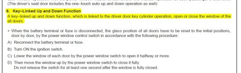

Just found this in the electrical wiring diagram book, which can be viewed here
http://4runnerclub.com/i/4r_files/fsm/ToyManuals-2007-4Runner/toyfsrm/07toyewd/07toypdf/ewdsrc/2007/4runner/h/em03m25.pdf
It clearly says the drivers door key cylinder can open or close all windows. I'm irritated that they put this in, because a tried everything I could think of to get this function working, to no avail. I suspect the JDM models might do it and they forgot to remove this from the NA manuals. If you read it carefully is very bad English too.
