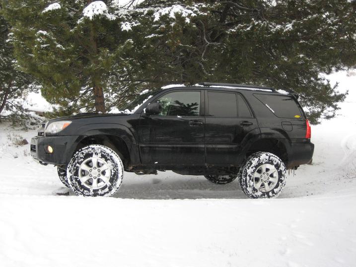

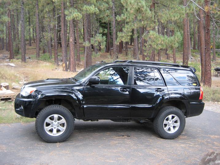

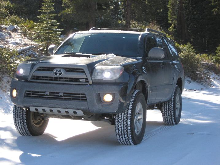

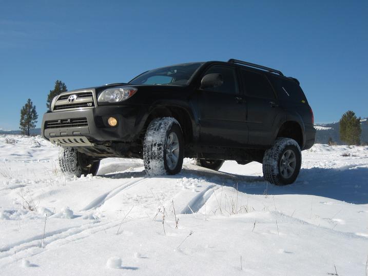

I love the tires! Theyre great on the mpg's and good enough offroad. The 285's will fit with some trimming. The body mount chop isnt necessary with these tires. Hope these pics help your decision.
