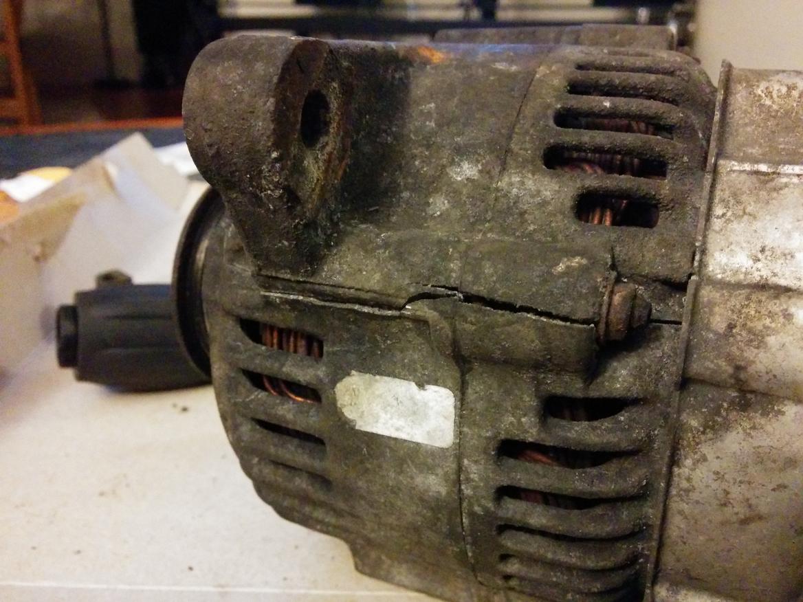

bummer!
Wow, that housing is really corroded! Hence the failure.... I've had several ALT's fail over the years, but only one bearing failure. Two with stator/rectifiers failures, and 3 with brushes (just replaced them!). In fact, the ALT out of my 4Runner failed after my engine replacement so I just dropped the JDM unit in. I replaced the brushes when I had the engine out so I expect the rectifier/reg failed...

I hope that isn't the case. I would think that if the stator were rubbing, I would have gotten some diminishing of performance, but I have been monitoring the voltage, and it was strong at 14.4V right up until I took it out last night. The new one is only reading 14.1-14.3V, so unsurprisingly, the cheapo alternator I bought out of desperation in't as good as OEM. Oh well. I didn't have time to wait for shipping.
I will definitely take it apart this weekend to confirm what ultimately failed. I peered into the crack and it looks like there is corrosion within the crack, so it may have been cracked for quite a while, which might suggest the bearing failed, hence the recent sudden downturn. The other possibility is that it cracked when I recently tightened the belt. We'll see what I find this weekend...
Soooo, major bummer...
you said that happened after adjusting the belt?
you over tightened it, or somehow damaged it in the process.
although, based on how that case looks, it may have failed on its own before too long anyway.
