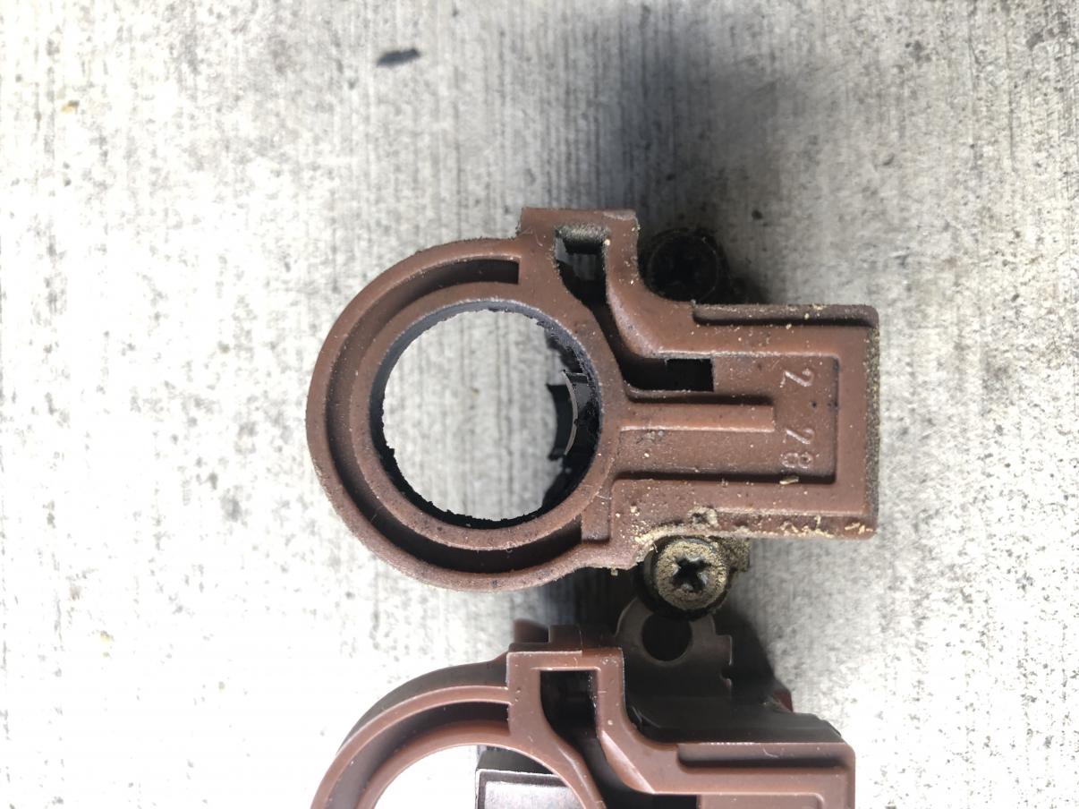

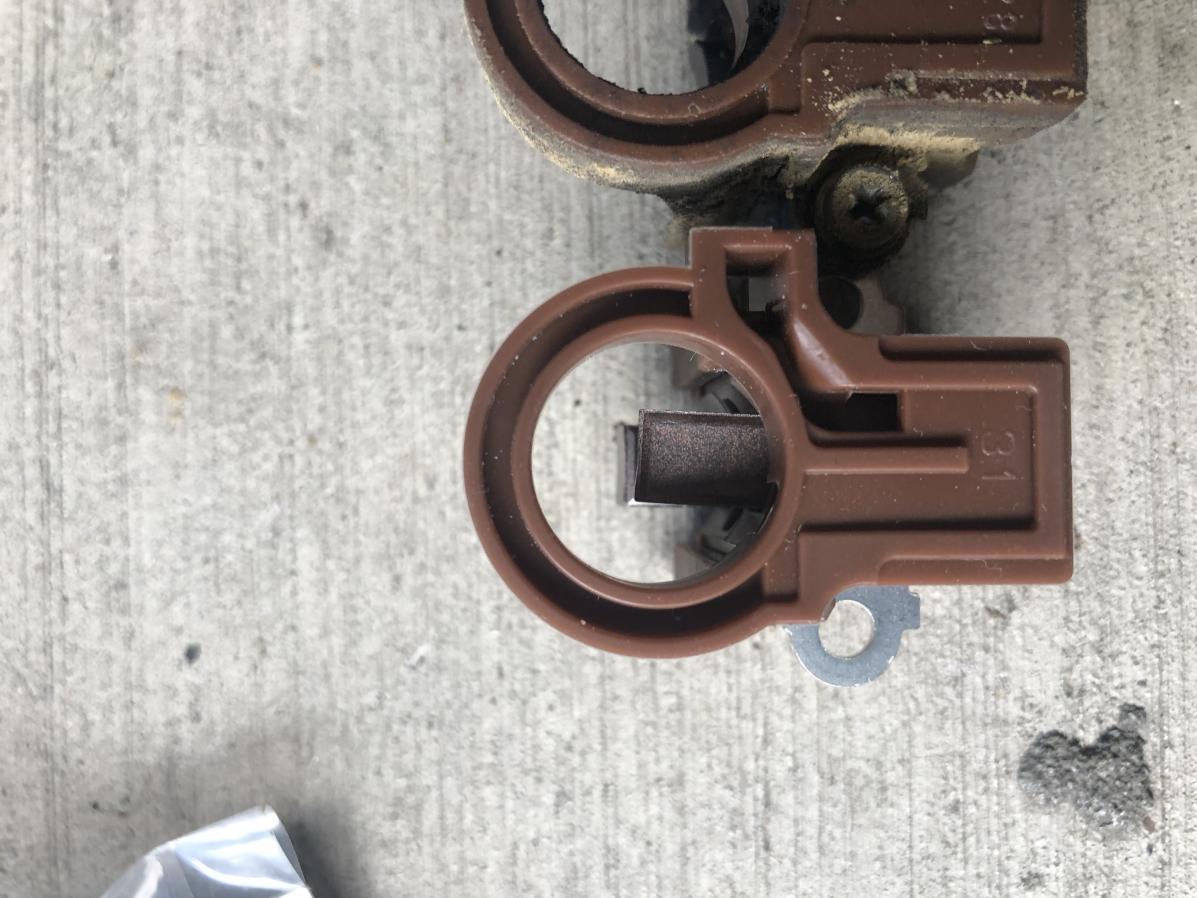

Hi, I had the same type of alternator brush in my 97 4Runner 2wd at 239k.
It was super worn down.
The part# is 27370-35060.
I bought it from Amazon.
https://www.amazon.com/Genuine-Toyo..._3?keywords=27370-35060&qid=1573858346&sr=8-3

Thanks for the tips shared in this thread! Same as others, started getting intermittent battery warning lights and would watch the voltage in my Ultragauge start dropping while it was illuminated. Ordered OEM through Amazon: Toyota Alternator Holder - 27370-35060 for my 1997 4Runner. $34 and half an hour and it's good as new again.
