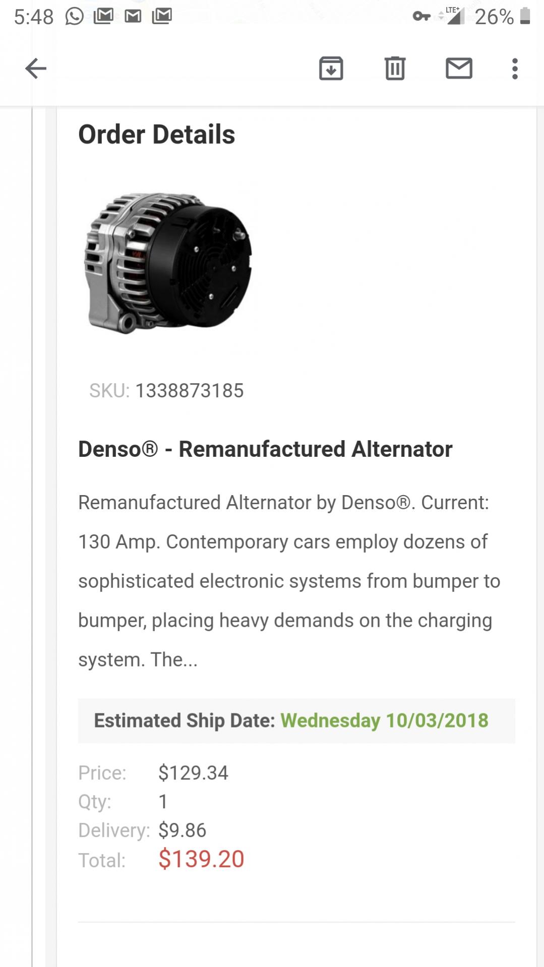

My alternator went out last year around this time on my 2011 @76k. I ordered a reman denso unit from Carid for $140. About an hour to r&r. If you are handy and have some basic tools, it should be fairly easy.
