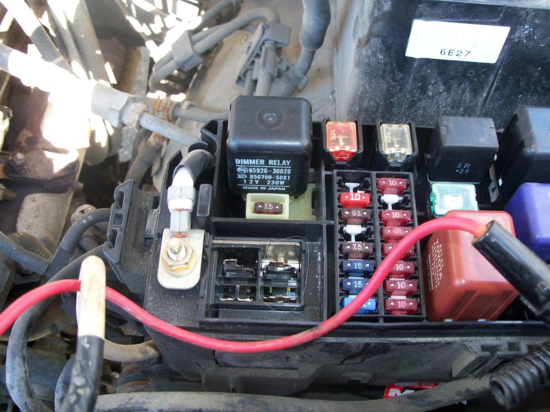

I cannot get the alternator fuse out, help! My dome fuse keeps blowing as soon as I change it, any ideas?
Its bolted in from underneath. The fuse box has to be disassembled. There are several plastic clips around the edges that need to be released. Very time consuming. Be extremely careful as the case can easily be broken.
the alternator fuse is blown..got it changed now thanks. The 4runner still has no cab power ie: no power windows, stereo, dome light... I am thinking I have a ground somewhere.
