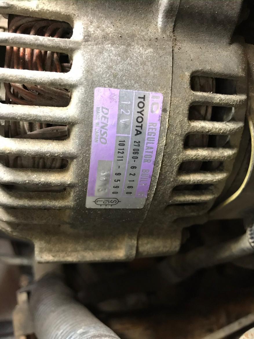

I just received an email from the seller of alternator brushes on Amazon. They said that they would require the part number from the actual alternator on my vehicle. They said that part numbers can vary even within the same year.

Thanks to [MENTION=582693]Traveler74[/MENTION] for starting this thread as I wasn’t aware of this issue and thanks to [MENTION=266619]thennen[/MENTION] and others for pointing out how easy it is to replace the brushes.
I confirmed original alternator in place as well as specific model #’s.
Will be ordering from Amazon or eBay and installing once they arrive.

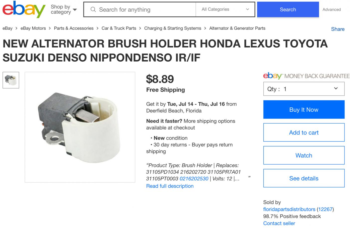

I have located and ordered the alternator bushes (incased in a round plastic ring) on e Bay. Only $9.00. It LOOKS exactly like the one I saw on a youtube video and the one shown in Chilton's Repair Manuel, (chapter 5, page 5-15). eBay claims it fits my 1996 T4R SR5.
Being an old fart, I'm much more familiar with the cars of the 50's, and 60's than I am of the newer cars. I certainly did not expect to find the voltage regulator INSIDE the alternator. Tiny little thing. But I didn't order it yet. Perhaps I should have.
