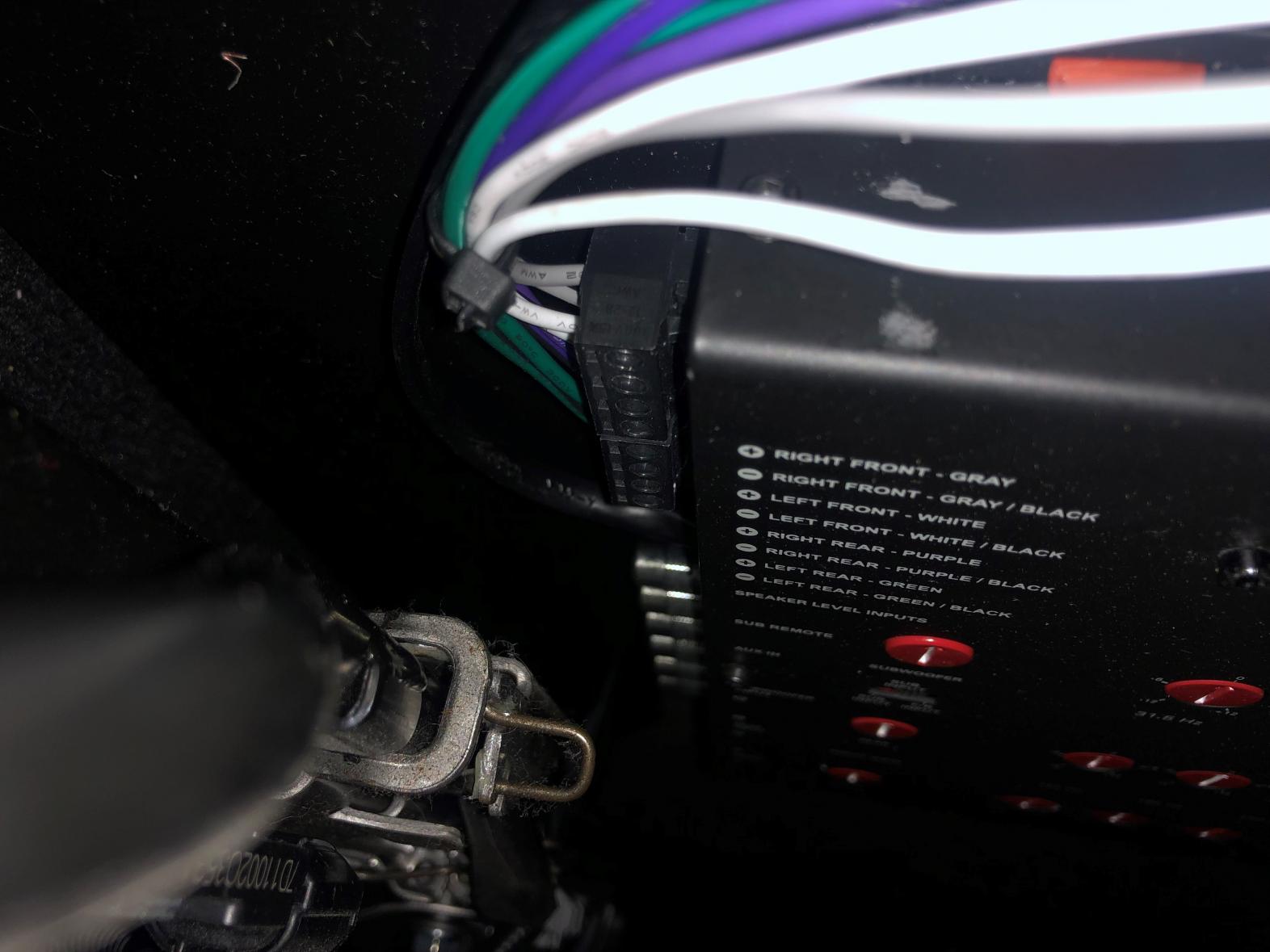

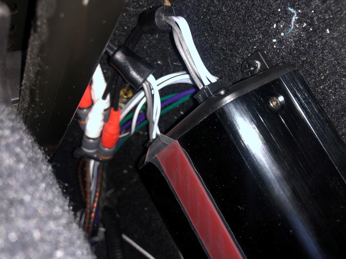

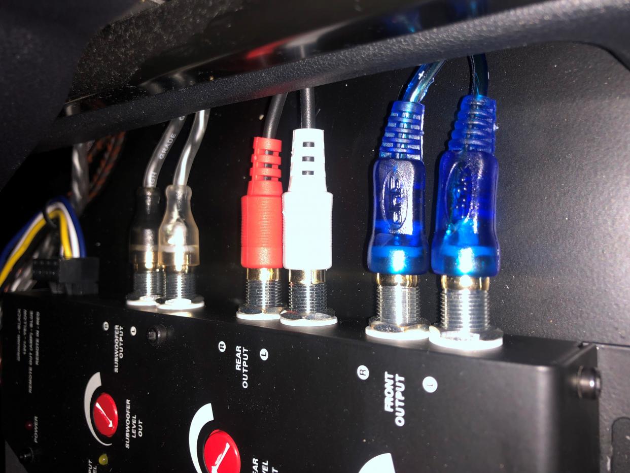

amp photo
look like some random rca wires, if you have spare rca cable, i would swap it out for some better quality ones, the ones that have better shielding.
also unplug the rca from the sub out, your amp dont seem to have an input for a sub. if you are ready to add a sub amp, then you can run the signal off that output.
https://www.audiocontrol.com/downloads/car/current/eqs/eqs-user-manual.pdf
read that and understand that its the same as the tacotune stuff, you might need to readjust the eq part, or have to take it apart and see the settings inside, also on the amp itself, might need to have the gains either turned down to match the signal input.
remember that on your radio, do not use the radio bass and treble and mid setting, you need to have that flat. only do the sound adjustment on the tacotune eq.

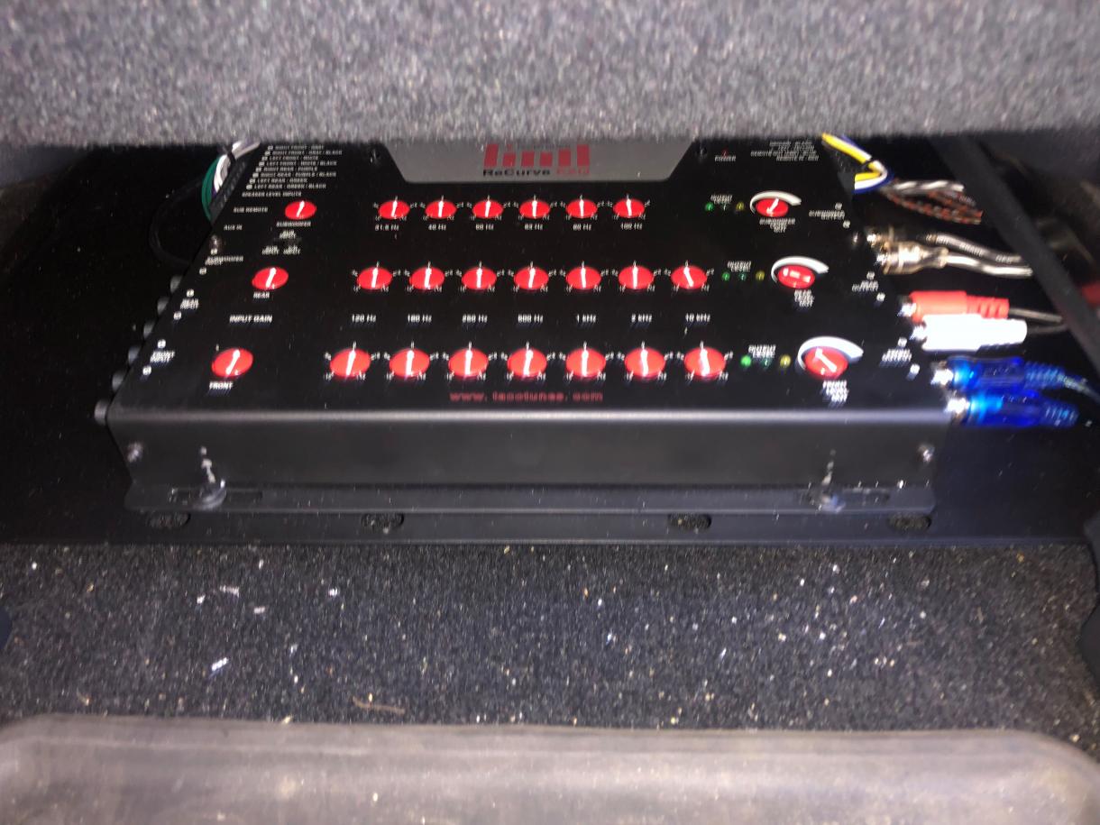

Went to the new shop yesterday for more opinions. He was shocked at the quality of wiring they used on the first job.
We then hooked up a sub and the sub remote line doesn’t work. We turned the sub eq up and down on the EZQ and that didn’t change anything in the output.
Scratching my head on this one. He said the same - could be unit or wiring. I’m going to have him gut it and put in quality wiring and do a good job. In the mean time, should I go test fit the AudioControl dm601?
Lastly, if my EZQ is the issue, what do I need to just run a 5 channel amp? Do I need an lc6i? Do I need anything or can the shop just use the amp and connect directly to the head unit? If I don’t need any processors or EQs etc then I won’t use one. I want only what I need to hook up a sub and amp the door speakers.

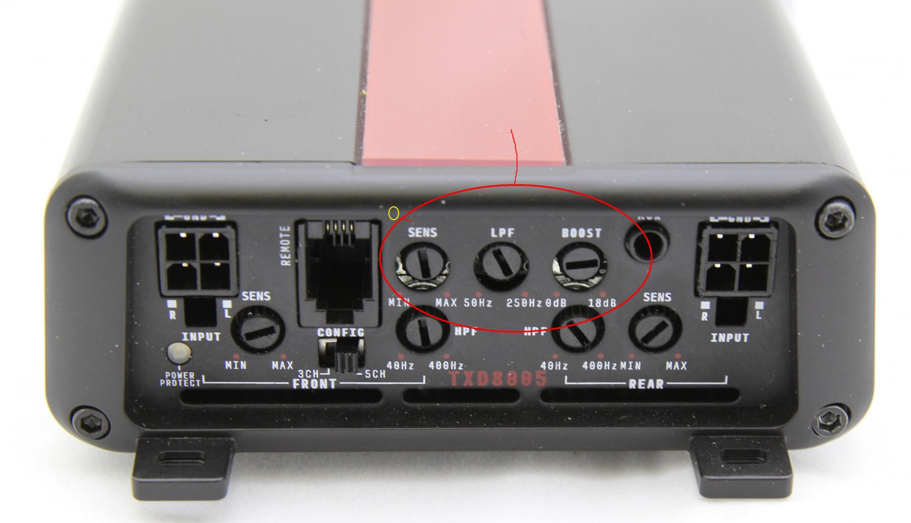

to get the subwoofer to work, you need to have the controls set correctly on the picture circle in red, test to see if the sub work when you turn up the gain and have the switch at 5 channel mode.
the taco tune eq is already an loc that has eq built in, i wouldnt waste anymore money till you get the amp working correctly. you amp only have front and rear output, if you are not getting sounds at the sub out of the amp, your gain for that part is still not set right. turn up the gain and the lpf on the amp to get sound.
