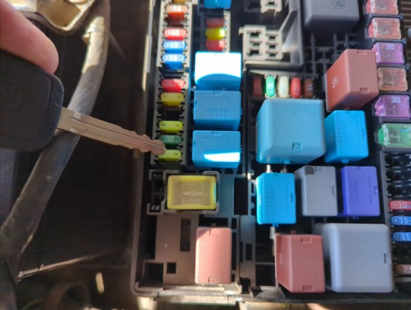

Awesome tip. Found myself in backcountry 4th of July weekend and the stereo stopped sending signal to the amp. Everything worked but no sound. I was able to look up this thread and apply some much needed help.
I located and pulled the "radio 2" fuse and it was not blown, but the leads looked a little tarnished, so I cleaned off some corrosion on the leads, plugged it back in and we were back in business.
