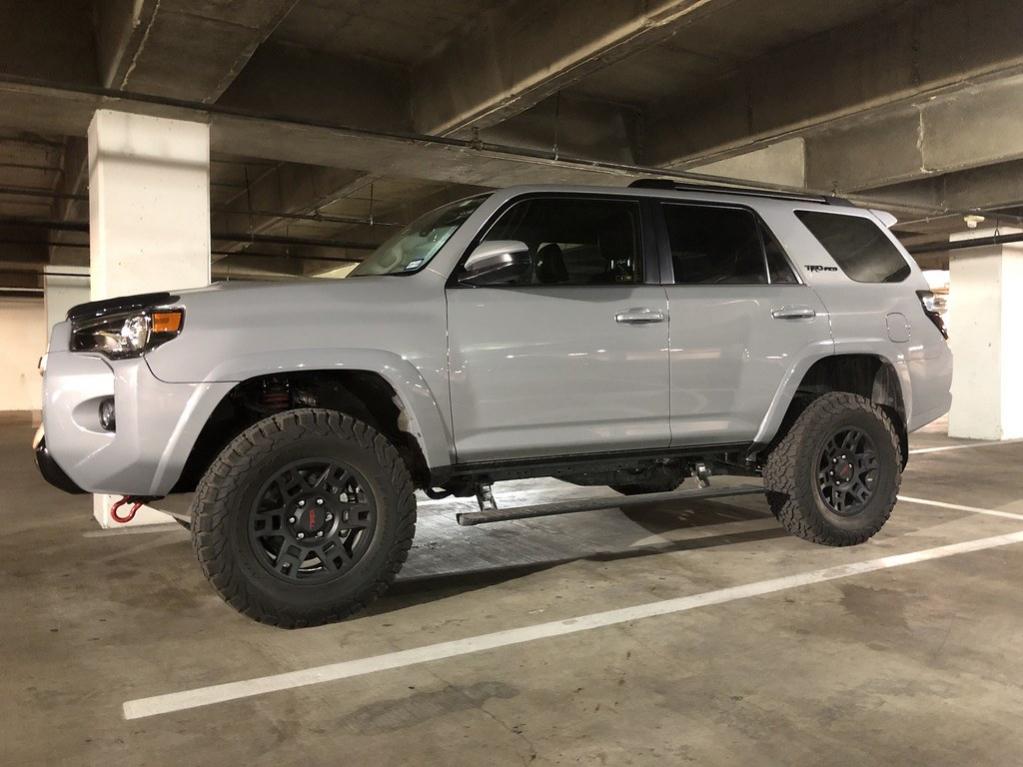

Heres a pic on a pro, no KDSS and no expert but I can't see why that would matter? people be swapping steps from runner to runner and never saw KDSS being and issue.. not unless the motor they use needs to go where kdss is?
