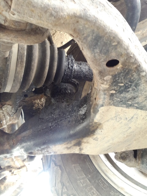

An oil goo on my driver's side whatchamacallit. Doesn't look normal.
Elan_
I was underneath my truck grinding away my bumper to fit my wheel spaced tires and noticed this oil all over the driver's side whatever mechanism. I checked the passenger side to see if such a leak was normal but the passenger side is dry and clean.
Is something broken? What should I check here?

What Brian said.
Inspect it more closely. If the CV boot isn't torn, you can try a new steel band. There's a good thread in here for that. Worse case scenario, it's torn somewhere. I just replaced my driver's side half shaft due to a torn boot. Took about an hour to do with hand tools and a friend.
+1
Halfshaft boot is smoked. Plan on replacing the shaft as the split boots are crap and the joint is likely cooked now anyway.
