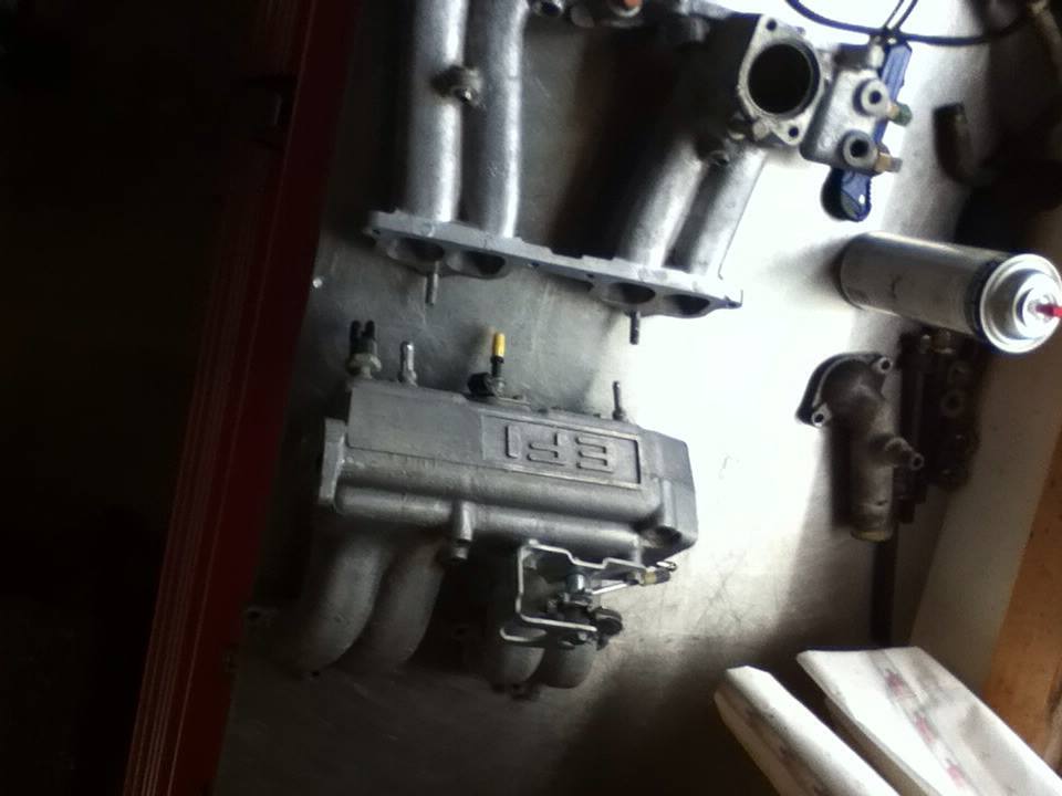

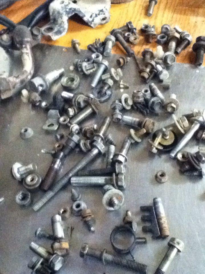

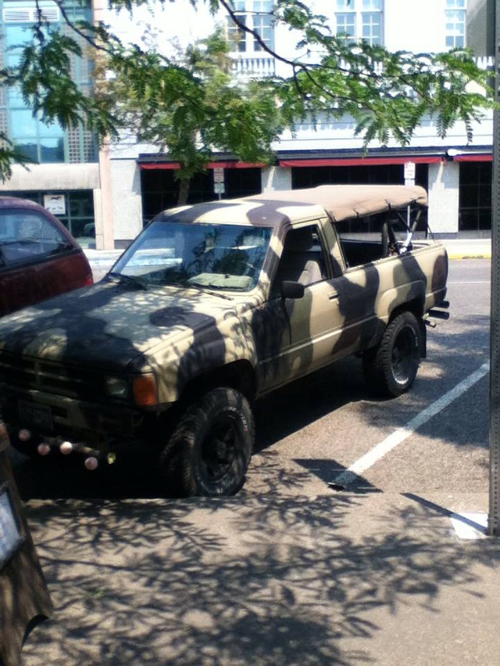

Talked to a fella today about this project, and he saw the basket of bolts in my pic w/ the toothbrush, and asked about that. I explained that I had soaked all of the hardware in degreased and scrubbed them clean as could be. I also told him about painting "everything" camo, even my exhaust manifold, which will be covered by a heat shield and not really visible...He asked me why I would waste all of this time on stuff that nobody is going to see, and that it will all be dirty as soon as I hit the hills with it. Also, that I could have had this new motor in weeks ago if I wasn't wasting my time on all this stuff.
All I had to respond with was a blank stare.....Maybe some folks approach projects differently, but I always try to do it right, the first time, and have the mentality of, if it's worth doing, it's worth doing right.....when else will I have this opportunity to make my 29 year old 4runner this happy??
Maybe I am a bit OCD, or maybe folks are just different. Am I nuts here, or what??

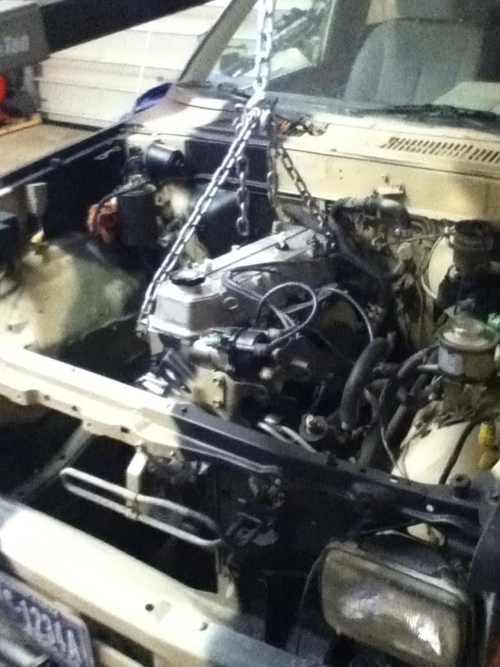

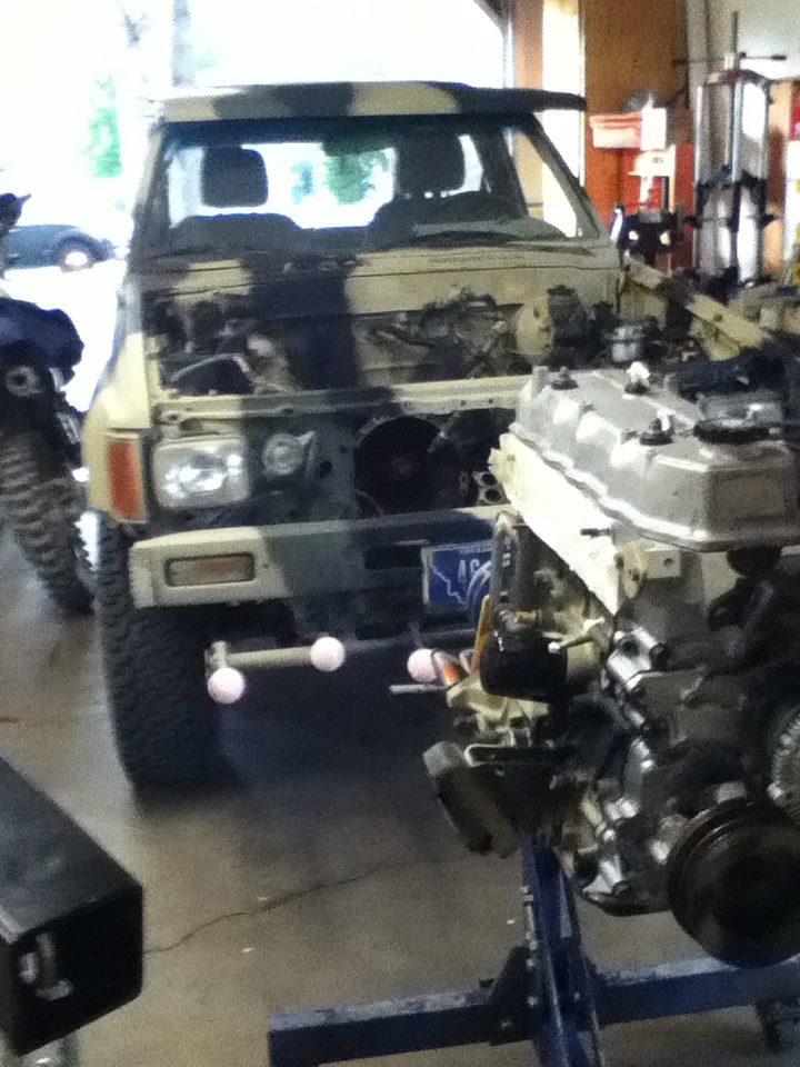

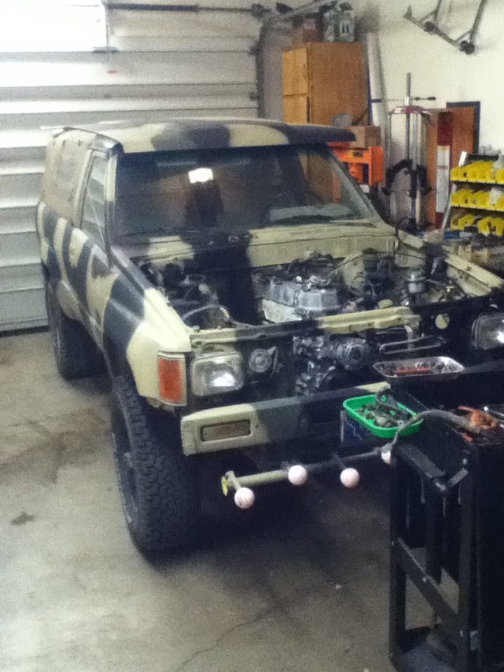

Headed over to my buddies shop now for the final push on this motor!!! Still waiting on the radiator, but we'll get the motor in this evening.....Hopefully! If not, we both have tomorrow to work as well. Wish me luck! here we go!:wink2:
Well, we made progress. Didn't get the FI on before installing the motor, but we got the sucker in! Tomorrow we continue, and plan on being able to test drive it tomorrow evening. It's finally happening!:hello:

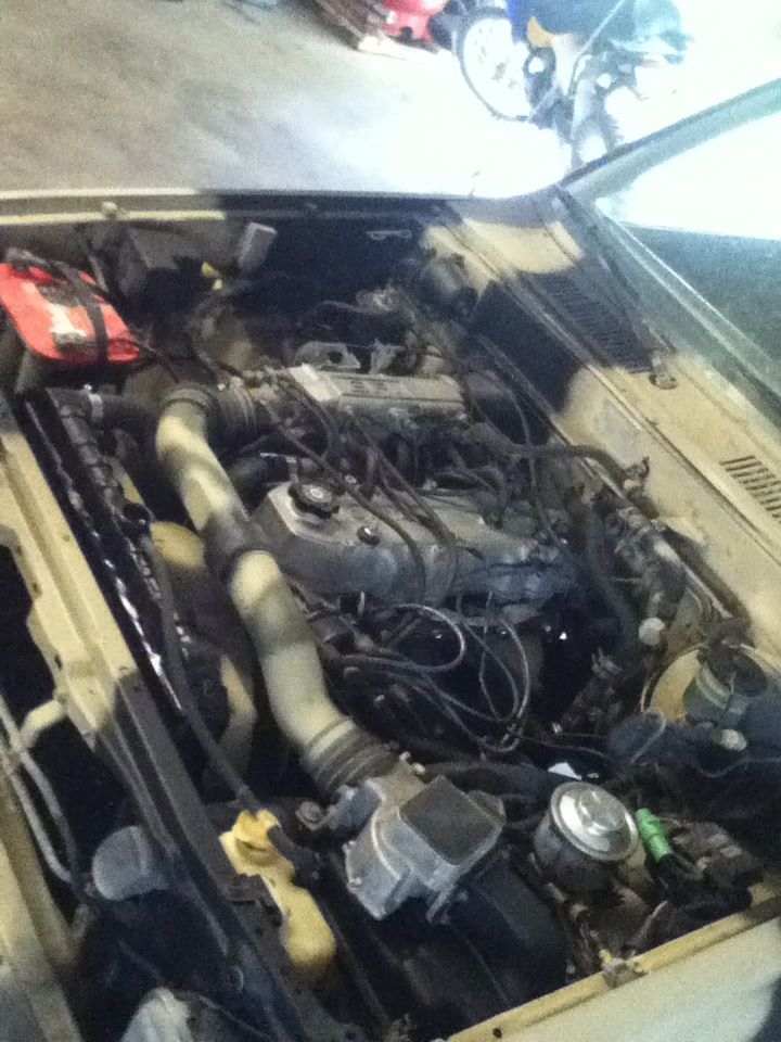

Whooop! IT IS ALIVE!!!!
Well, I'm driving the 4runner again!!! Runs great.....so quiet, no more sounding like a diesel motor! Silky smooth clutch as well. Super happy with the results here.
Now to save the cash for high steer kit and new shocks......:wave:
Drove to work today!! After running for a bit, the little "put-put" sound has gone and it runs very smoothly.

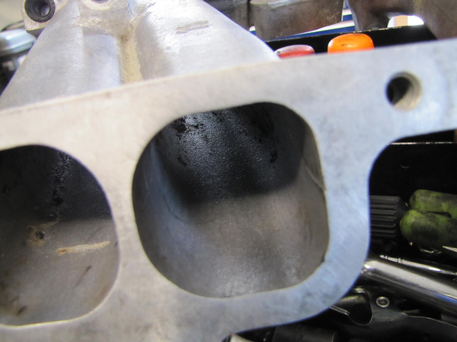

All of that scrubbing seems well worth it. I went through a couple toothbrushes and gunked up a couple of wire brushes, and used my fair share of degreaser...Don't worry, the second pic was taken after my first attempt, I got the rest of that crud out of there!!!

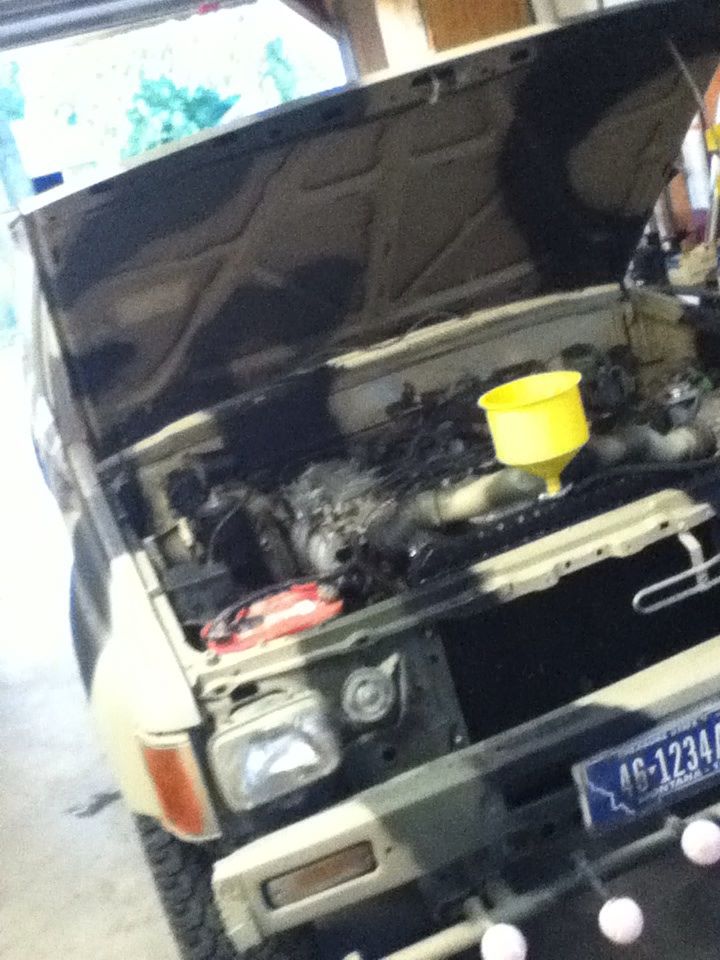

Breaking in the new motor nicely. Did my first oil change on it today, after about 100 miles of driving. Planning in regular 5w-30 for the first 3 oil changes (at 2,000 miles each) before moving to synthetic motor oil. Oil that came out looked great, pretty dark due to the break in fluids and junk,( high graphite content) but she runs "Like a Top!"

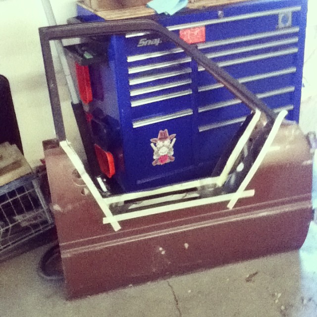

OK, one of the doors has a vent window that was FUBAR. So I went for symmetry and removed both vent windows.....disappointingly.....anyway, I got halfway done today. I got them cut out and I left the upper trim for future snap-on windows. It will be at least 2 weeks until I have days off to mess with it further, but here are my half doors so far. (from parts rig). I am planning on putting cup holders in them as well.

The panels for the half doors will also be wooden.
