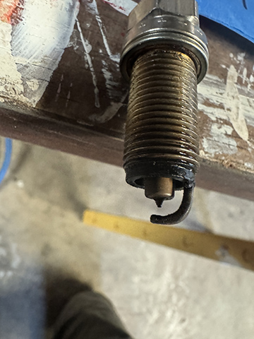

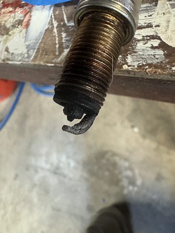

I do believe this is an oil burning issue for multiple reasons.
1) Smoke has an oil smell
2) Engine is losing oil and has no visible leaks
3) #6 plug has build up. (second photo)
Keith
